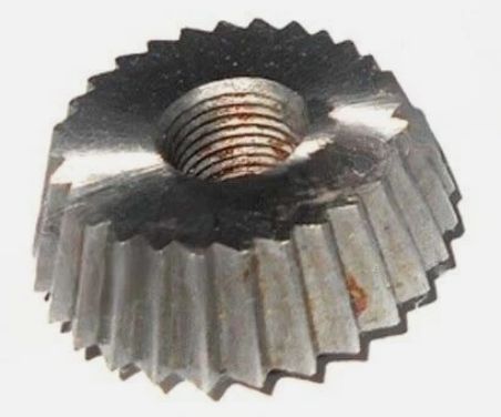

    Can this style of valve seat cutter be resharpened? If so, would you use a valve grinder, lathe, or some other type equipment? I have older USA made cutters and I see newer India made cutters. The ones I have are dull, they cut but just barely. I believe they were used for decades before carbides were available but I find it hard to believe they were throwaway pieces. The pics are new examples, not the ones I have. Again, can these type valve seat cutters be resharpened in a reasonable manner? cutter01.jpg cutter02.jpg

    The first year I worked in a machine shop, the owner taught us how to sharpen everything in the shop. Ir's all in the quality of your files, and holding them right.

    302GMC is spot on. Yes they can be re-sharpened. The challenge is resharpening them without affecting the cutting geometry.

    I would imagine those are too hard to sharpen with files.
    In my machinist apprenticeship I sharpened lots of various cutters using a diamond wheel on a "tool and cutter grinder".
    You'd have to make a simple mandrel to hold those cutters in the machine's collet chuck.
    With labour rates at machine shops, it probably isn't practical to pay for the service.

    As mentioned they could be sharpened with the right equipment, but those were meant for cutting the cast iron seats of the day. Even sharpened they'll have a challenge with hardened seats and won't last long.

    Do you have access to a die grinder, preferable one with a 1/8" collet?
    If so you can carefully grind the front edge/face of each tooth ..... carefully because you must remove a very similar amount from each tooth face otherwise their diameters will be inconsistent.
    Unless they are chipped you only need to rub a couple of thou from each tooth face to get an improvement.
    Much like sharpening a HSS lathe tool.

    I do have die grinders as well as dremels, would you use a carbide cut off wheel to do this?

    I have used a tungsten carbide brake lathe bit to bring the edge back on reamer flutes, also try McMaster Carr for a diamond file, several types, the one I have will dress 65R steel, cost $100. Thin ones are available. Not Harbor Freight, good ones are expensive . If you want to buy a new cutter ,try Regis Manufacturing.

    That equipment is called a Jack Mill. Ran one for several years in the saw room of a large cabinet manufacturing plant. That said, seek out a saw sharping shop, not a machine shop. Big difference in labor cost.

    I have both styles in two different sets. I am trying to reface by hand and it takes extreme effort to cut the cast iron seats. It barely takes off any metal as they try to shave the seat. Five full minutes by hand with significant downward pressure gives at best .015-.020 cut surface. BTW, I do have a china clone RPM air gap for a sbm to sell but shipping would make it unreasonable. Look on ebay for one or an Edel Performer. Should be able to find one at any Stockton or Turlock car show/swap meet.
