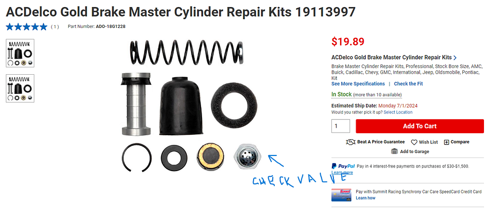

    The old single piston master cylinders have a "check valve" at the outlet end of the master cylinder that maintains pressure in the line when the pedal isn't being pushed.
    Firewall mounted dual master cylinders have a small check valve behind the pressed in br*** seat of the Drum brake side of the master cylinder none on the disk brake side. The ones on a drum/drum master cylinder will work under the floor with the two check valves if the rig is driven every day or at least several times a week but will leak down if the rig sits for over a week at a time. That is my experience from running one for 15 years. 54 car drums on the front 74 Nova drums on the rear.
    If you have ever rebuilt a dual master cylinder the check valves and springs come in the kit for drum brakes. I don't recommend attempting to rebuild one though even though I have done hundreds of brake jobs in my life.
    This being the kit for the 66 Mustang Fruit Jar master cylinder that was the go to hot rod/T bucket master cylinder for years. Note that it has that check valve.
    I would install the residual valves in the lines close to the master cylinder and go from there.
