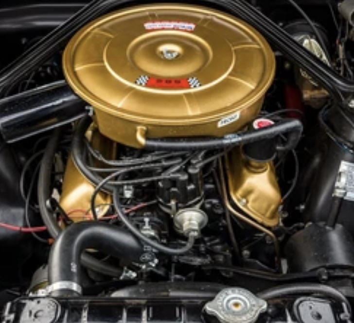

    Early small fords look cool
    The gold and black or the performance cobra versions.
    an early version even had no hole valve covers with a oil fill/breather tube in the timing cover and generators.
    Super easy to get a vintage vibe

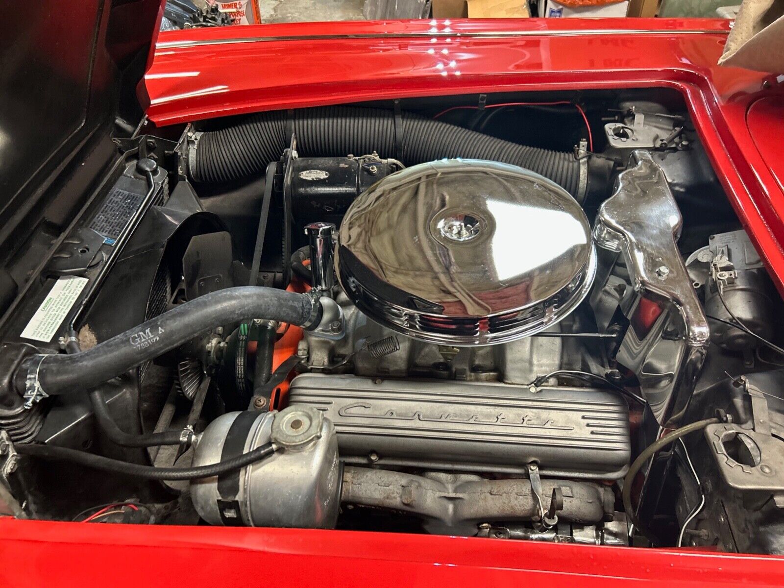

  6. I have a 331 Hemi that I really wanted to use for a while, but I can't find the correct intake I want for it. So I thought of something temporary (at least to get it back on the road).
    Believe it or not, the SBC fits the car pretty well. The only issue is that on all Birds I've seen with this swap the owners never go all the way. They have a 1955, 56, 57 Bird with a 1980s 350. Ugly as sin...
    So this is what I'm thinking. Go all the way. Make mine look just like this:
    This is as period correct as it gets. I also have a ****tershield that bolts the Toploader straight to Chevy. Its vintage McLeod from either the late 1960s or the early 1970s. Still coated in the original gold coating.

    That looks great in there. The only thing I can think of to aid in the swap might be a front sump Nova pan, since you'll probably have some clearance issues with the rear sump SBC versus a front sump Y block.

    Corvette appearing Chevy engine sounds cool, and if you can utilize the old adapter and use that 4 speed, even better. It's exactly the kind of thing you may have seen at that time, and it still makes use of all the good stuff you've saved. The radius'd wheelwells fit better with a Corvette engine swapped car than one running the original Y block anyway.

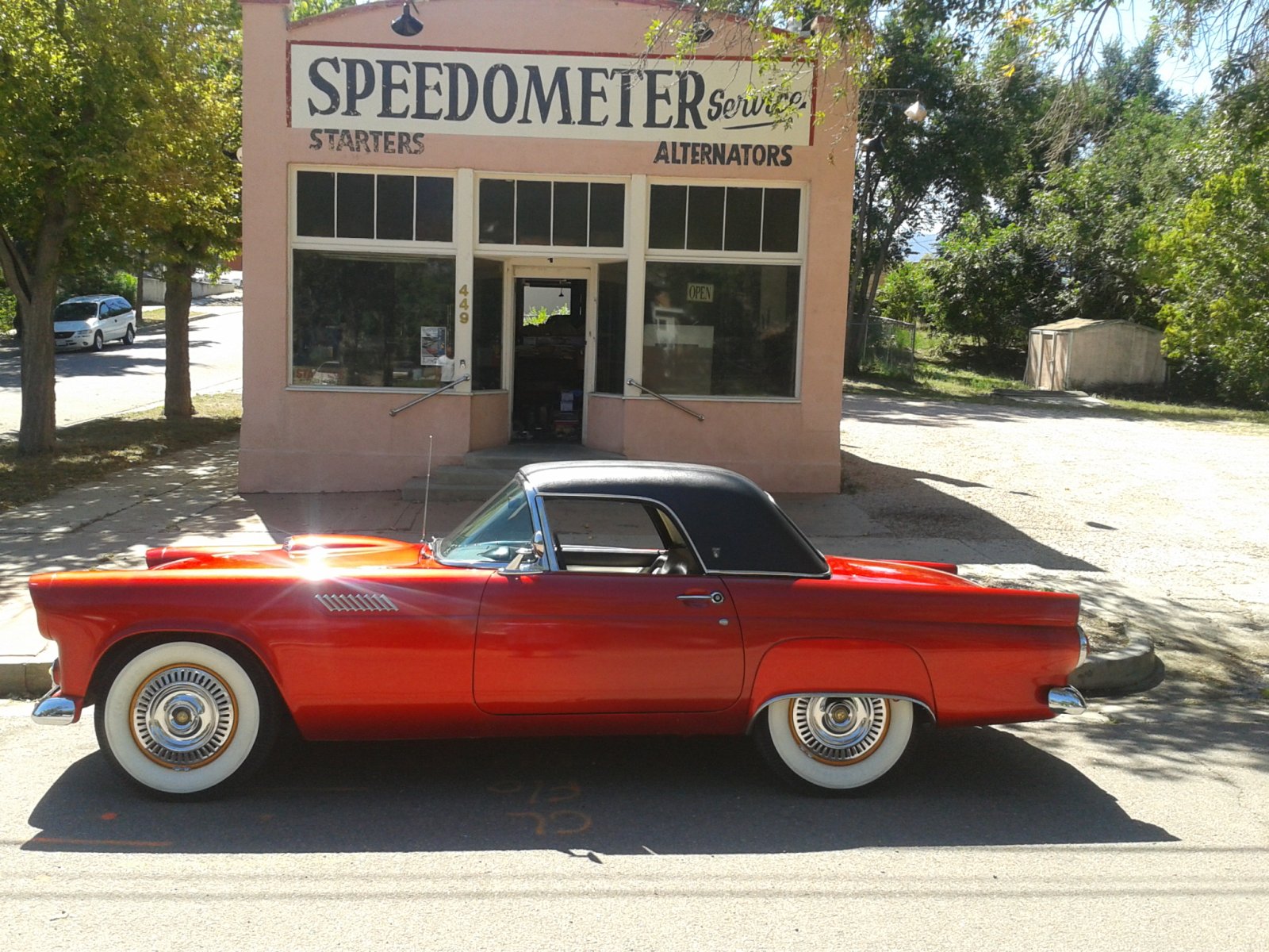

    That T-Bird was a Colorado Springs car, a friend of mine Chris owned it.
    I rebuilt the speedometer, generator and starter on it. If you click the link it will take you to more pic's 20140919_121419.jpg

  16. Wow! WOW! WOW-E! That is so cool.

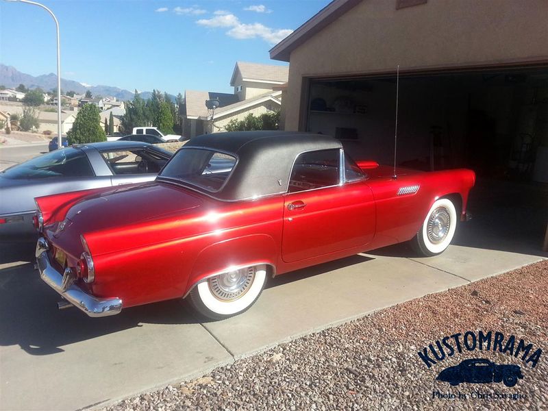

    Hmmm....I'm on the fence with those rear big wheel arches. I do like the look of the factory openings without the fender skirt. The rear Dodge taillights look to be a cool BOLT ON modification with no changes to the sheet metal..
