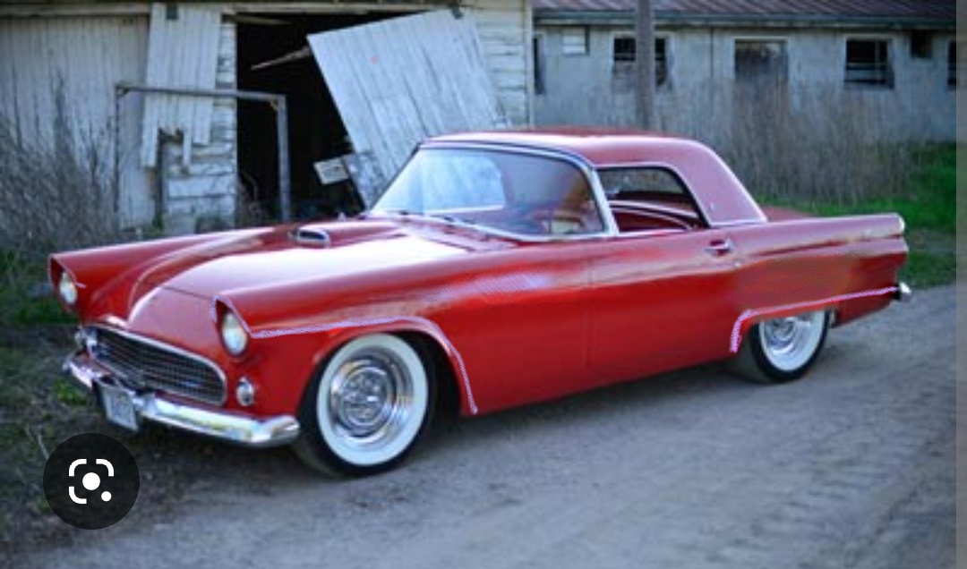

  1. Here ya go, simple but effective. Make your own history....

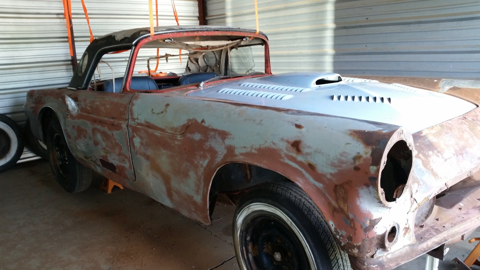

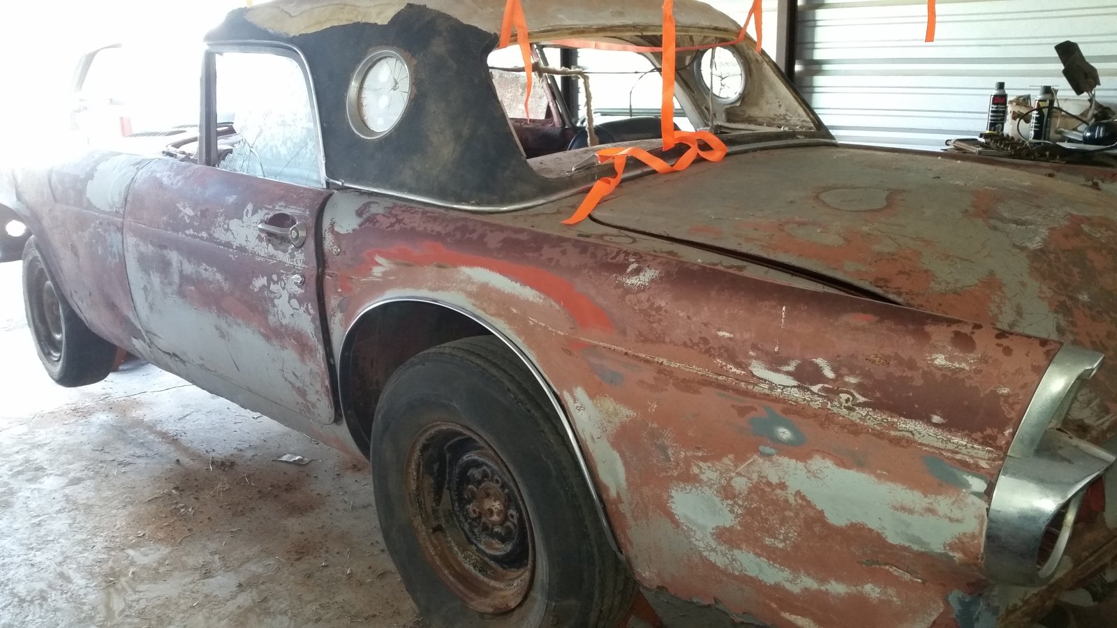

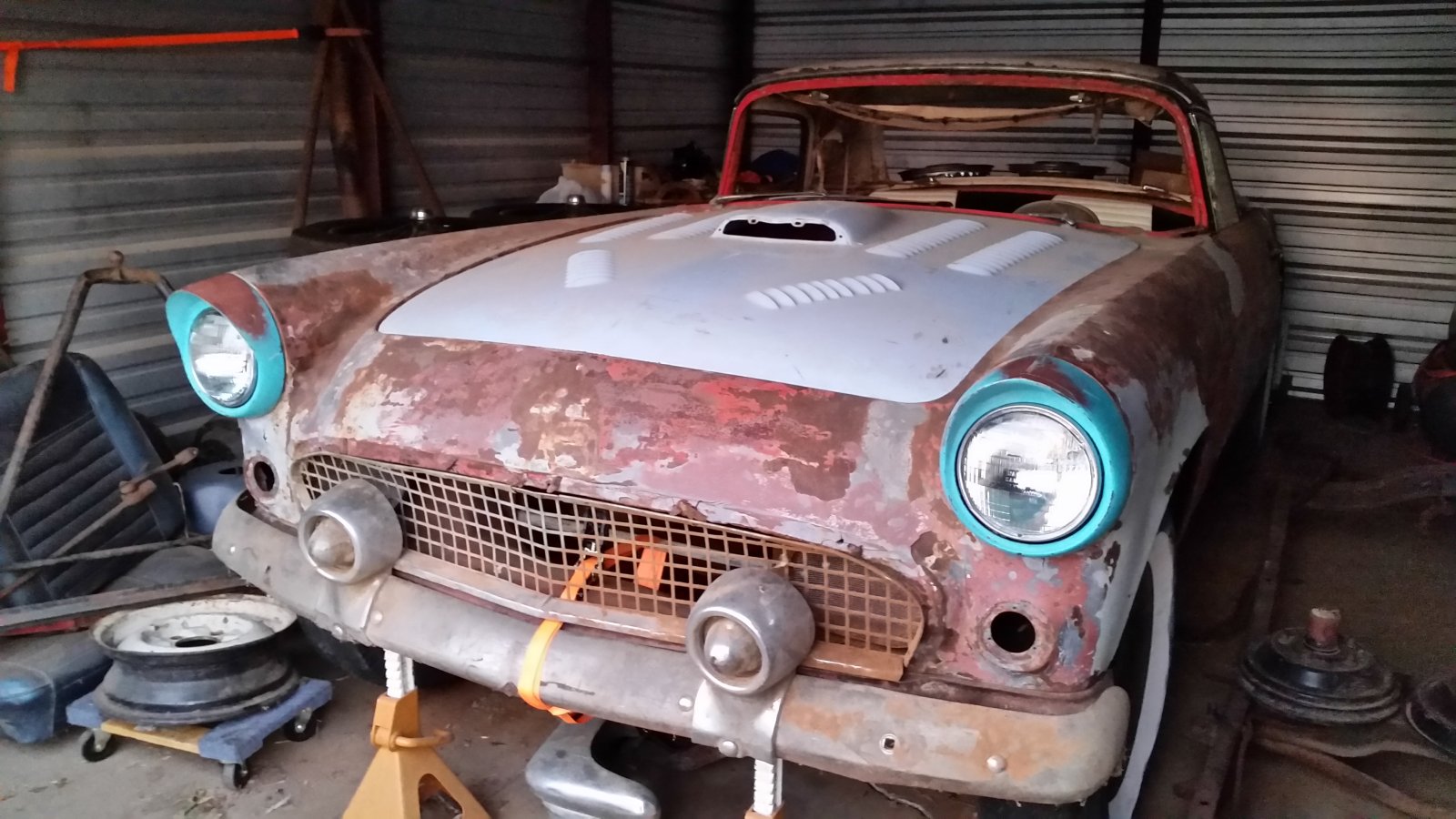

  2. Given the parts you have it wouldn't be that tough to do an "in between" car, and swap that look of the car while honoring it's past as a custom and the unfinished g***er conversion
    Given you have two hoods, could change them . Louvered hood a set of steel wheels and full wheel covers and white wall or chrome wheels you have a custom.
    Many g***ers had custom car cues light swaps ect... Hood scoop, mag wheels and you have the g***er look.

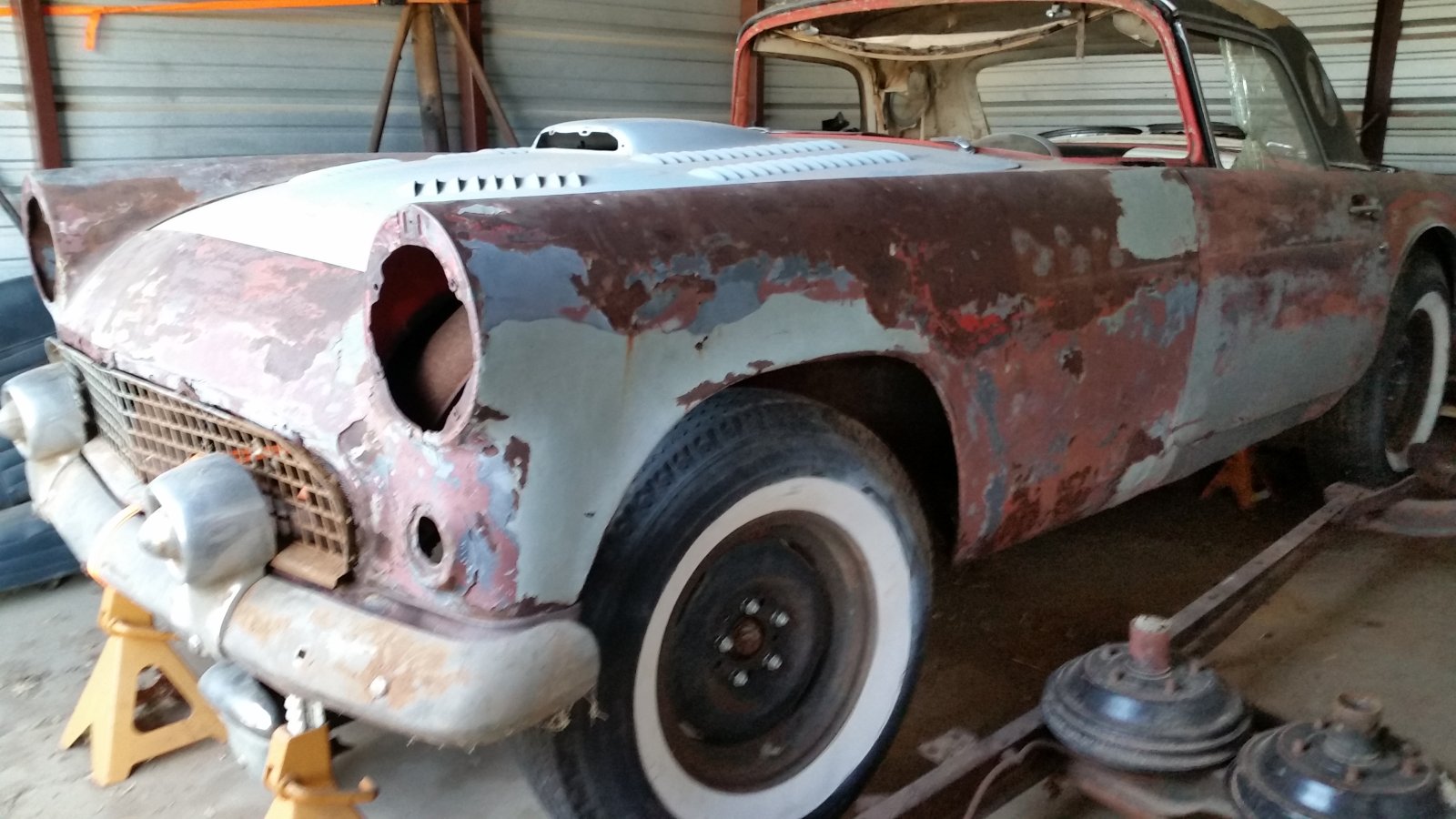

  3. That does help. I was thinking about that very thing. I've got a 312 Y Block from a 1956 Mercury, but it's locked solid. I know that I can save it. I just haven't had the time or resources at the moment. It will happen though.
    If I bring the rear suspension to more of a stock height and the tires still don't fill up the openings the way I like, I will bring them down. Not all the way down. Just enough to make it not look ridiculous but intentional.

  4. I like the louvered hood I have, but I don't like the front set of louvers. If I don't go full fibergl*** hood, I will be hammering the front louvers back into shape while keeping the louvers next to the scoop. I just think it would look better that way.

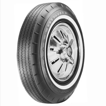

  14. I'd still like to know what size that drag slick is on the Doolittle Thunderbird. I'd run that size all day long. I was thinking something like this up front in the factory 670-15 size:

    I wouldn't be too concerned about what size they are....just do your best to make yours fit to the wheel opening, like those do. Rearend width, wheel offset, etc play into it.

    At one point I had a set of cheaters on the back of the bird. 7” Lincoln rims, original stock centers (built by Wheelsmith). They were 10” wide and I believe just about 29” tall. With a 4 or 4.125 backspace they fit in the stock openings, no skirts. They wouldn’t be large enough with the radius on your car, but they make a larger set. I’ve got a picture, but there’s some OT mods, if you want to see it pm me.
    http://www.whitewallcandystore.com/images/wwcsflyer309.pdf

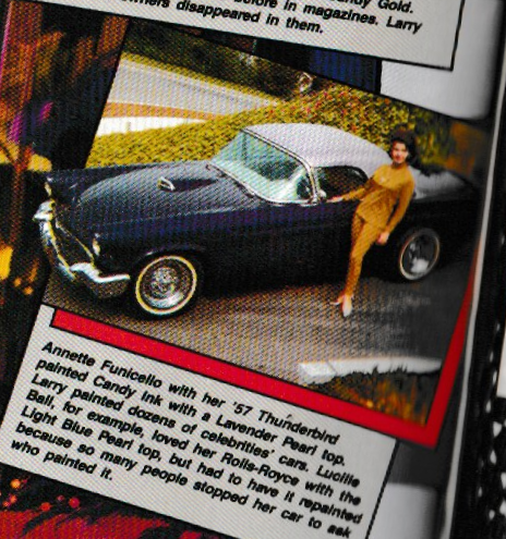

    There isn't much rake on the Funicello T-Bird, although the slope makes it look that way. Here's a shot on level ground from Rik Hoving's collection. Jacked up a little in back, maybe.

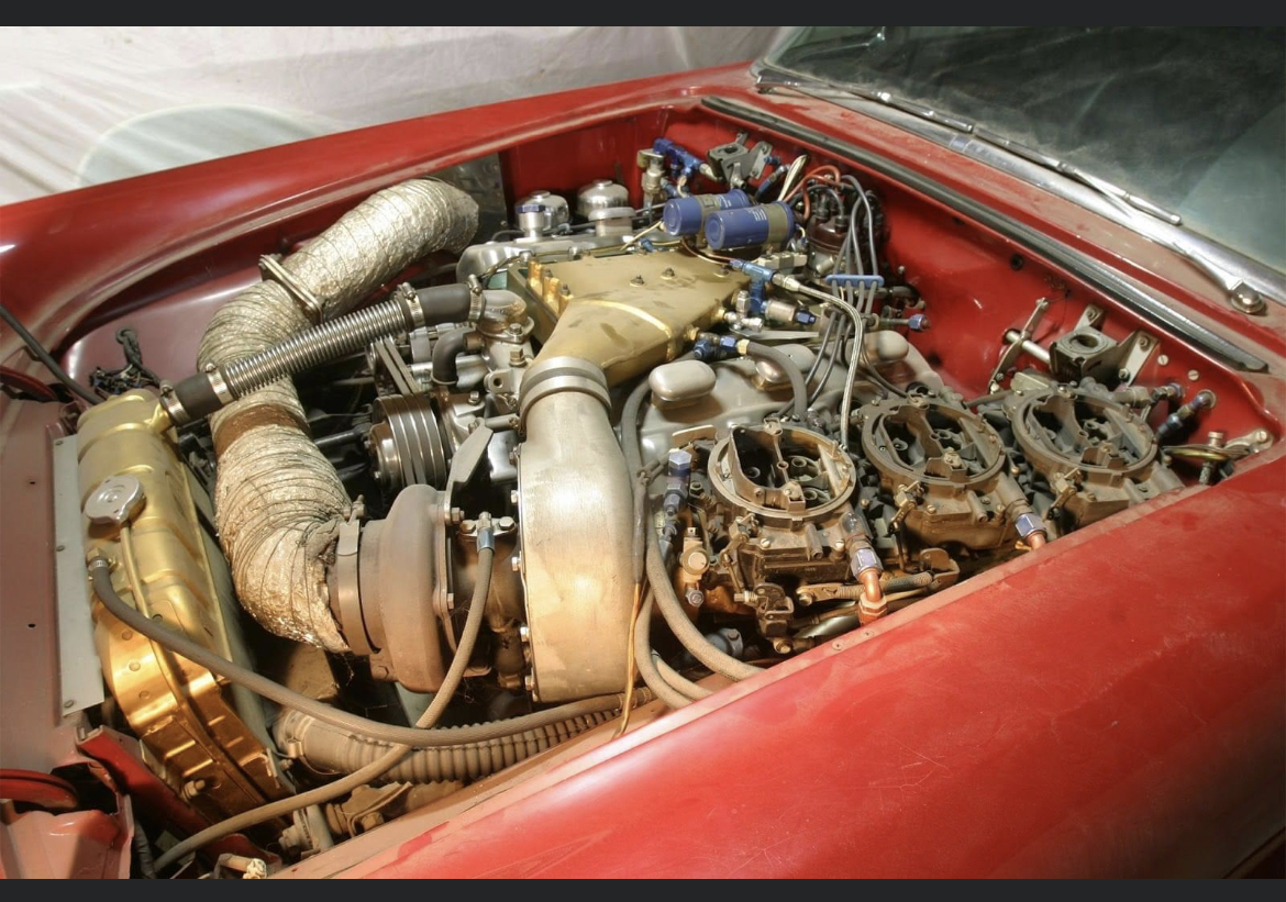

  24. Chrysler hemi tucks in nicely
    Garrett turbo ride, early 60s
    treb11, bchctybob, Tman and 3 others like this.

  26. You've done it now. You brought out the big guns. That's just flat out awesome.

    Three 4 barrels and an offset to the right of what looks like a foot, maybe at an angle? And here I thought I'd seen everything. Impressive engineering, even more impressive if it actually works.
