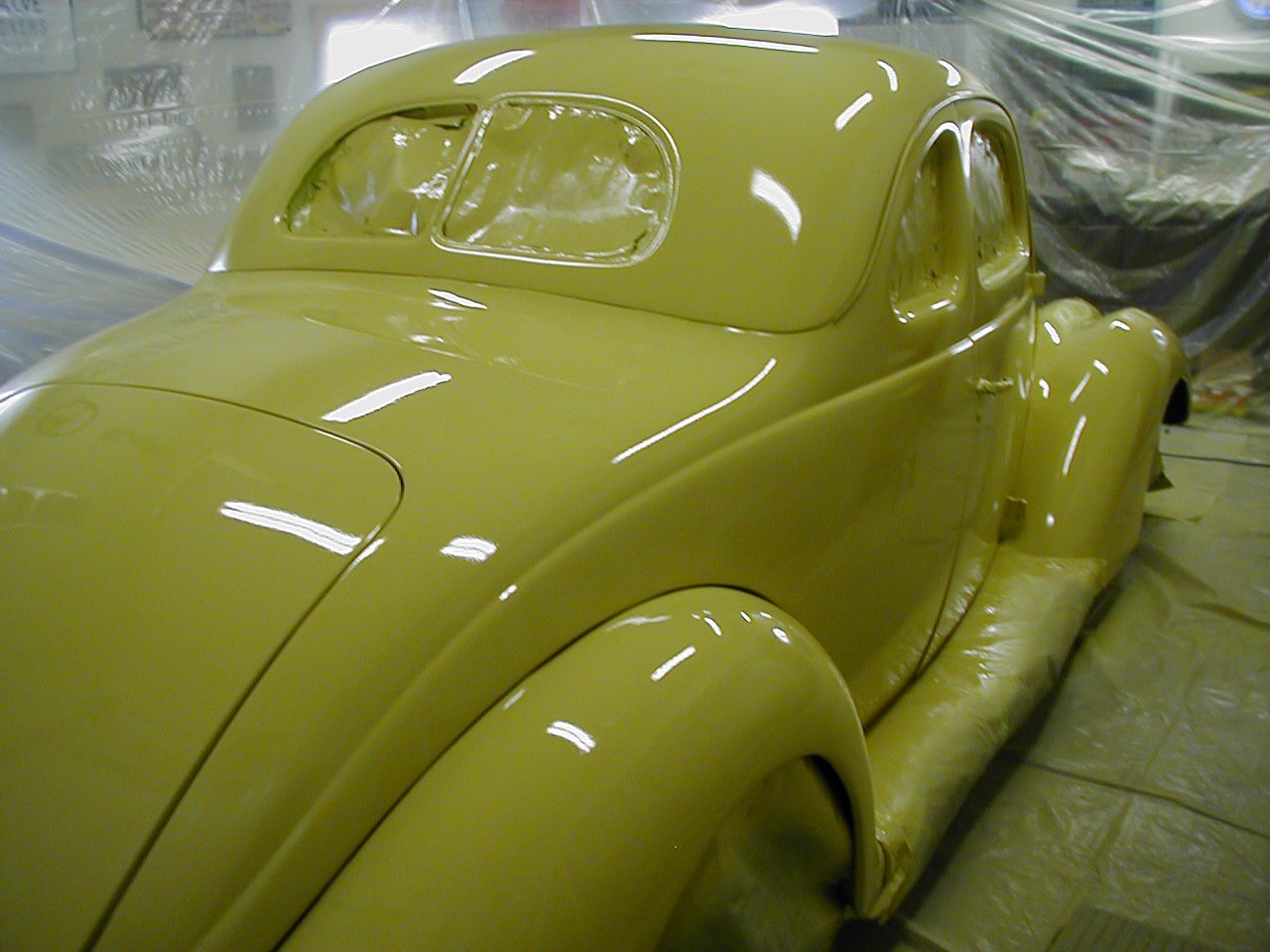

    I'm an amateur, and my first full paint job was on my '39 Chev coupe a few years ago. I used TCP Global's acrylic urethane single stage. A friend is a full time painter and recommended the single stage as he said there's less chance of screwing it up for a newbie than base/clear, and it would hold up better over time.
    I found it easier to apply than I expected, and although my paint job isn't up to what pro shop painters can do, I'm very happy with the results.
    My first attempt at lettering also, and it came out about as good as the paint job.

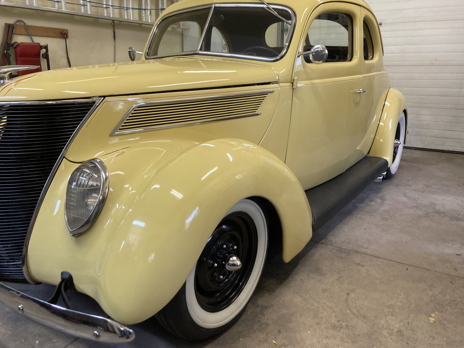

    I used this stuff too. Acrylic enamel with a gloss hardener. Holding up well. 15 yrs old now. 71857516955__5653D26B-7417-4A4D-9CAE-192FF5389E7F.jpeg IMG_0517.jpeg

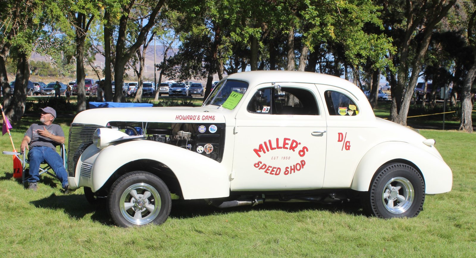

    Aren’t the clear coats all acrylic urethane. It’s just whether you go single stage or multistage. I painted this with acrylic lacquer in 1986, it’s garage kept but has held up great. Any urethane should outlast this. 260E411F-FCC2-485F-8DD4-E6EEBC068D2F.jpeg
