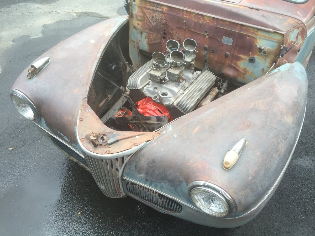

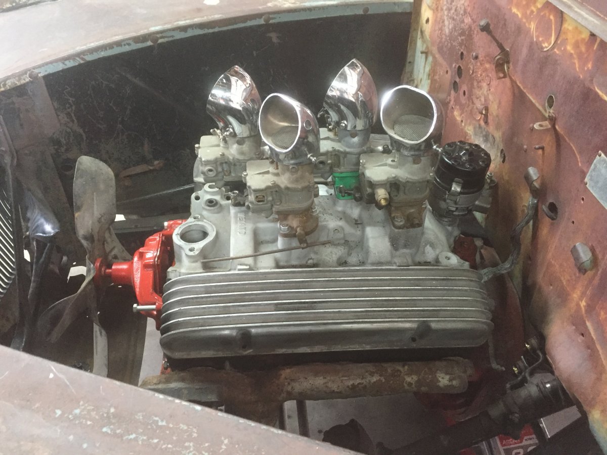

    I have 4 flathead cars already, and just picked up (ironically) a black 46 coupe to put a 283 in. I LOVE flatheads, and even with my dad owning his own engine/machine shop...they are still exspensive. This is a nice car, but the engine is TIRED. It's the perfect car to do the swap, plus I'll have a good 59AB core for down the road.
    The 283 I have is a 58 with power pack heads. Got it for free, have a Weiand 4x2 intake for it
    And here so my engine mocked up in a coupe I had before this one. Has log manifolds, Mallory flat cap, everything fits like a glove
    oliver westlund and Atwater Mike like this.

    Thanks, looks like my 46. Now you got me thinking again!

    What exhaust manifolds did you use. Are you using your original drivetrain in the 46?

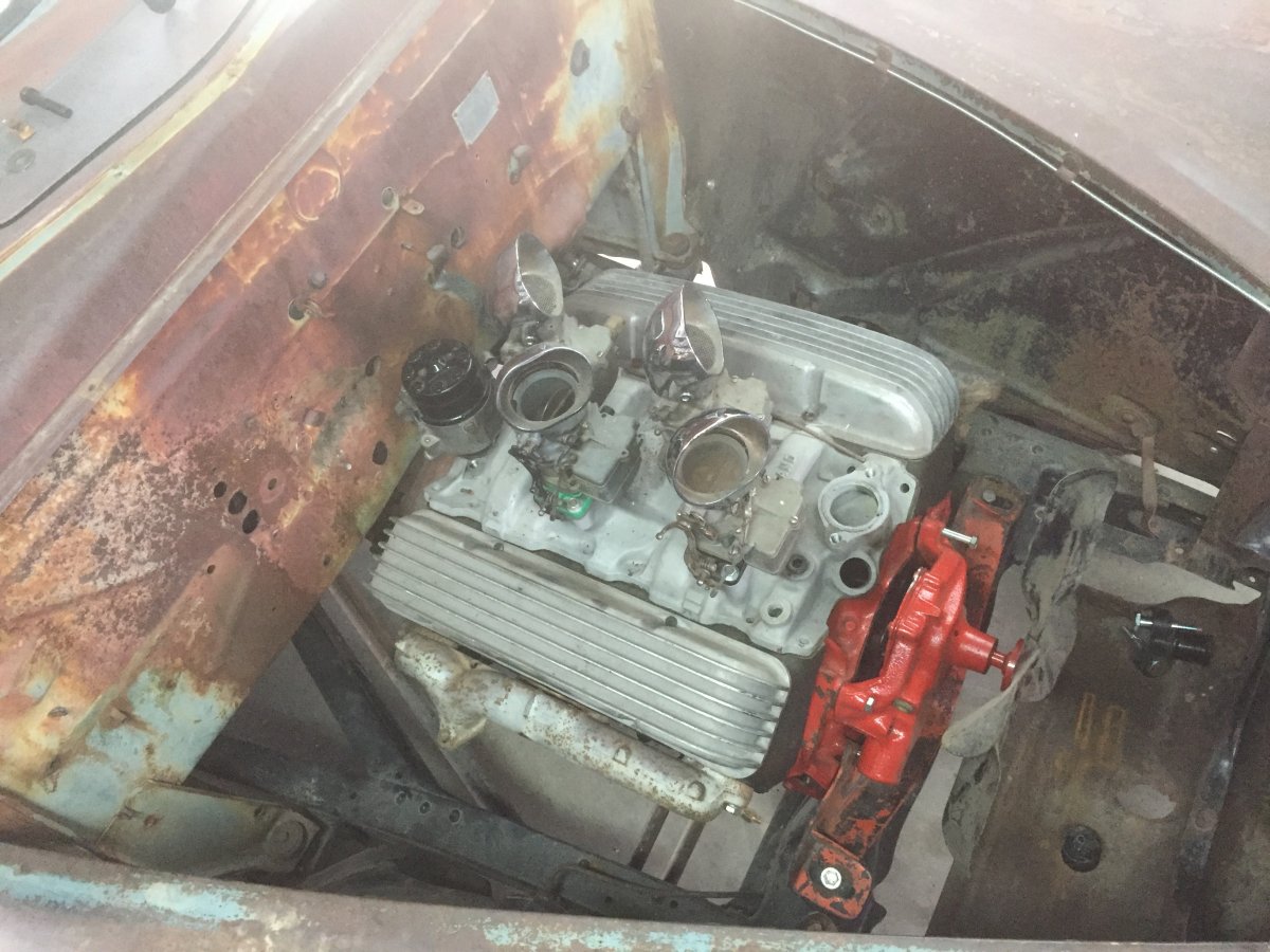

    Yes, original trans and rear. I have a 3.54 center section for it. I reversed the springs front and rear and have a dropped axle for it. Manifolds are stock 55-57(?). Some chev guy will know for sure. Clears steering beautifully

    Not an expert, but those are the manifolds that I mentioned on the OP's thread about manifolds.
    I know they are 55-56 but I think 57 as well.

    Nope, in 1957 Chevy went to the ram horn style of manifolds. 1964 to 1968 Chevelle/ElCameno manifolds will clear the steering box with a ton of room with the added plus of eliminating the grease in the box becoming hot like it would with the ram horns.
