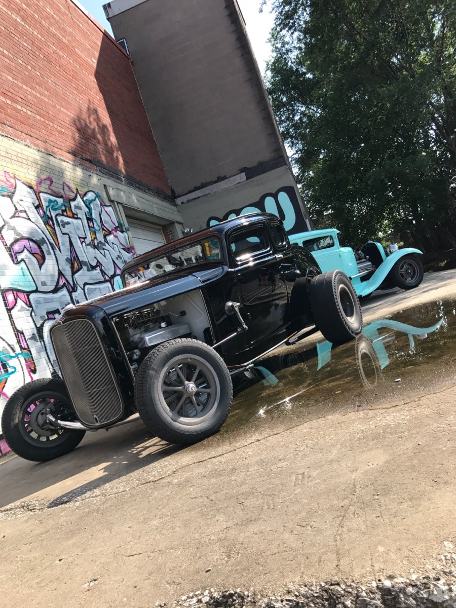

  9. Cool tech. I love the idea.
    I've had removable headlights on the Chemical City Coupe since the build in 2013. I run without headlights unless out after dark. As far as electrical connections, we used the weather pack connectors that House of Fab posted. When the headlights are unplugged, I just leave the exposed end hanging next to the frame rail. No need to cover. I've never had an issue with the lights not working when plugged back in and I've got over 20,000 miles on the car in all sorts of weather. Tons of rain and even some snow. Lol.
