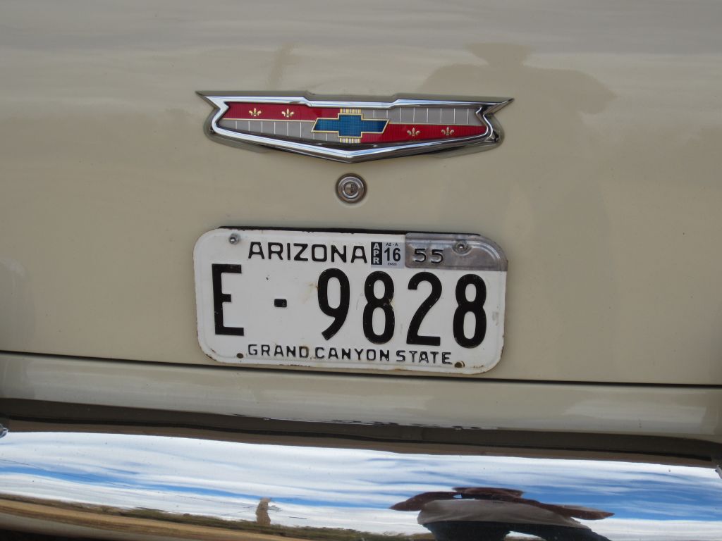

    I just put my new 54 plate on my 55 chevy. I had a nice 55 year tab and a rough 54 plate that I found years ago, but never got around to restoring. Recently I bought a nice used original 54 plate, has a few scratches and minor dents but it's very presentable. I kinda like the fact that it's still original. And the cost for the plate was in line with what it costs to get one restored. The fellow I got it from is a friend of a friend, he has been collecting/selling/restoring plates for years and has a pretty nice collection of AZ plates. you might want to hit up the swap meet plate vendors, and see if you can find a nice one that doesn't need restoration.
