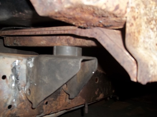

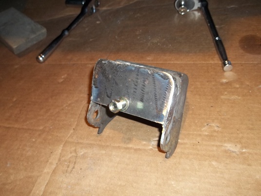

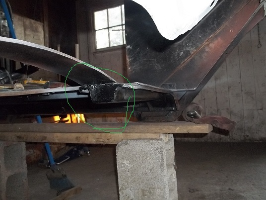

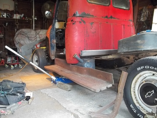

thanx mcnally, im slowly getting there. so i wasnt happy with the front cab mounts. after looking around the garage and thu my parts i found one of my 6cyl. motor mount brackets and looked it over and said this will work. first thing i did was drill a hole thu the cab floor and brace at one of the holes the the stock mounts bolted to. marked the motor bracket and drilled the 1.25" hole for the cab mount. i then welded a plate to the bracket as a backing that i could atleast bolt it up to the frame till i get the cab off to weld it to the frame. pics will show what i did.
That's perfect! Once again it proves my theory, never toss anything cuz there might be a need for it later! No wonder my garage seem so small

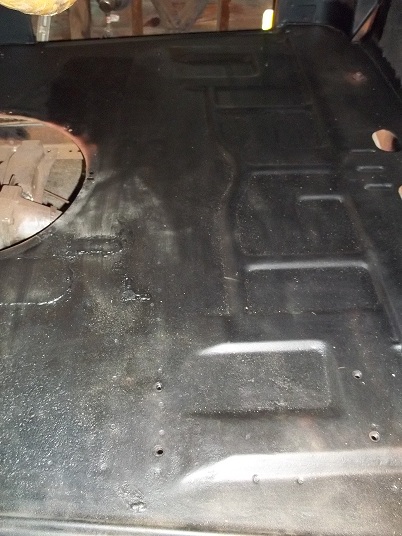

been busy the past couple of days working on the truck. 1st thing i did was the p***enger side cab mount. i cleaned up the floor of the heavy rust, gave it a coat of rusty metal primer and then a coat of bed liner. then i needed to figure out something at the firewall to slip the column thu, so i took a piece of 18g metal and put a 2.75 hole in it and then split in 2 pieces. took a gas filler rubber gasket and split that to fit around the column i flanged the one piece to fit over the other correctly. i will be cutting out a rubber gasket to put behind the plate when im ready to install for the last time.
i also snagged a gas pedal out od a mid 80's monte carlo. i did have to do some tweakin to it and some kind of mount if it. will get mount pics later. i did make sure the stock fuel tank was gonna fit in place right with using a different fame and it does, but not sure if i want to run the stock tank or go with a jeep cj tank i have here and mount it in the rear of the frame. either way its looking like the running boards will be about 8" off the ground at this point.

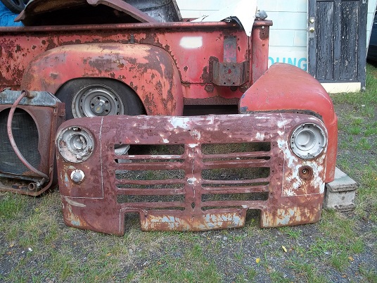

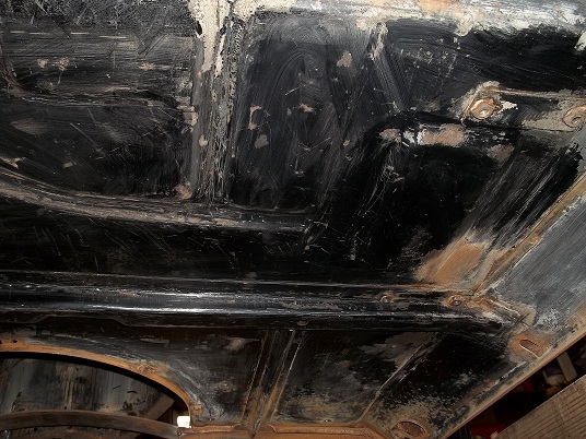

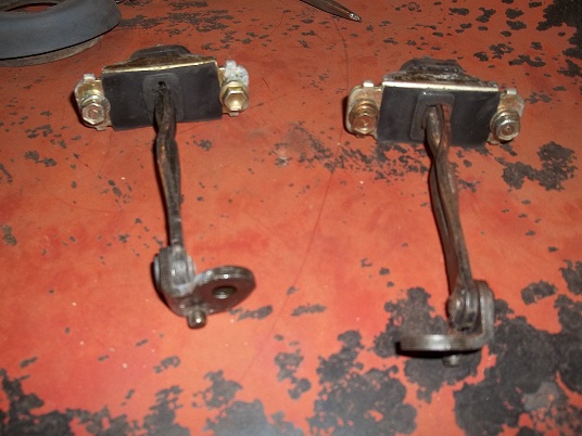

well i took the cab off the frame the other day and after two days of s****ing the bottom it and primering i finally got it bedlinered. i hit the yard today to pick up new door stops, i got a set off of a hyundia as the bolt to the door and the jam. after checking over both of my grill the do need work around the head/park lite area and been thinking of a good way to fix them. i came upon this dodge grill at the yard and figured i could cut the areas off this and fix one of my grills up. then i stood it up against a fender and thought well maybe i could split down the middle and stretch it 2-3" and trim the bottom a few inches and graft in the top section of one of the IH grills to match the hood. anyway a few pics of the progress.
So if I understand you correctly you wanna use the headlight area for your ihc grille and use round parking lights instead? I like it a lot! I did something similar on the wife's truck, since the whole bottom of the grille was completely gone too. I kept the recessed area though but shaped it somewhat like a Buick '53 headlight. Sent from my iPhone using TJJ app
well back at it again today. sanded, primered and alittle filler here and there on the the firewall. also capped off the floor brace where i cut it out. klaus, thats the plan is to use the headlite areas of the dodge grill to fix the IH grill.

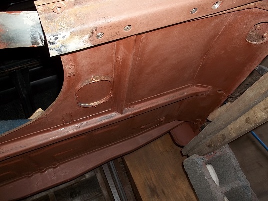

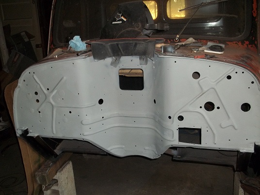

well slowed down abit with having lower back pain this past week. i did start cleaning and primering on the frame, sanded, primed and bedlinered the p***enger side cowl area, and also had to do alittle cut and welding on the toe board section i had done for alittle extra clearence for the trans so it would sit flat against the new floor brace piece i welded in. hope to get the firewall all done and painted this week and start on getting the interior panels sanded, primed and painted along with the dash.

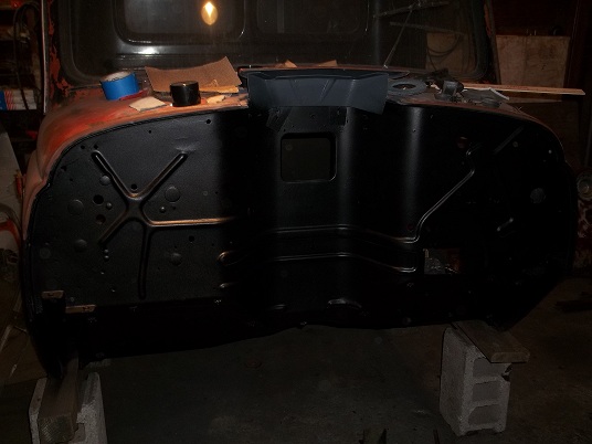

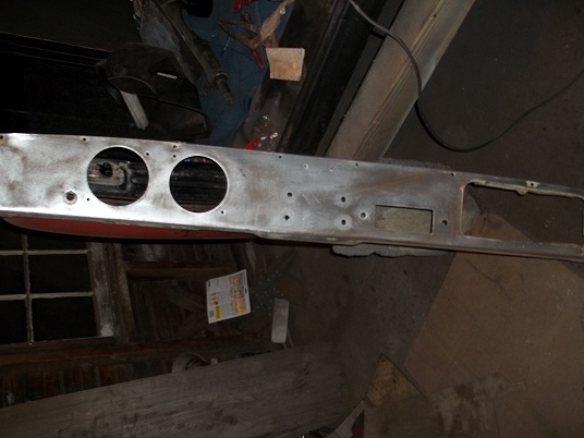

i managed to get the toe board in for the last time i hope. removed everything from the dash and just about hait all sanded to bare metal, not sure what color im gonna paint it yet. well i went and bedlined the firewall also, i like the look of it. over the weekend i plan on pulling the m/t out, bolt the cab back on the frame so i can get the running board brackets on bolted up in position.

nothing really pic worthy but did get the dash totally sanded down and primed, bedlined the inner firewall/cowl areas, also cleaned and primed the running board brackets. its slow going but every little bit is one step further.

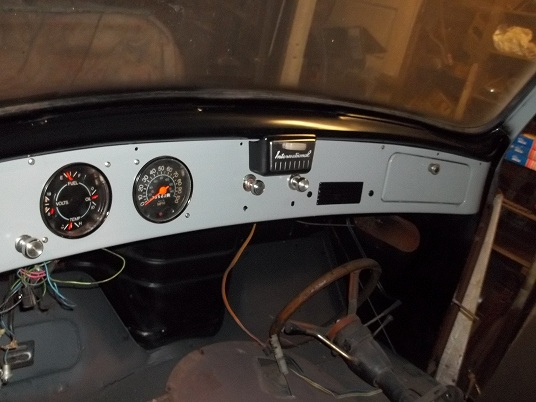

well i finally got the dash painted and all but together. need to get the cowl vent pieces cleand and painted this week and also cover/insutate in the inside of the firewall, so i can then get the heater box and such in and hang the wiring harness and column.
Looks great! Your glovebox door fits very nice! Not very common on these trucks. Sent from my iPhone using TJJ app
