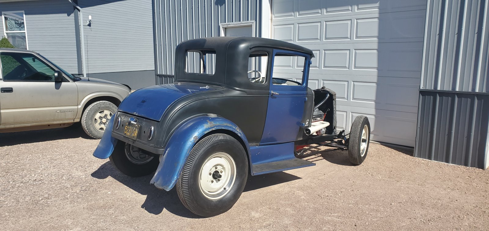

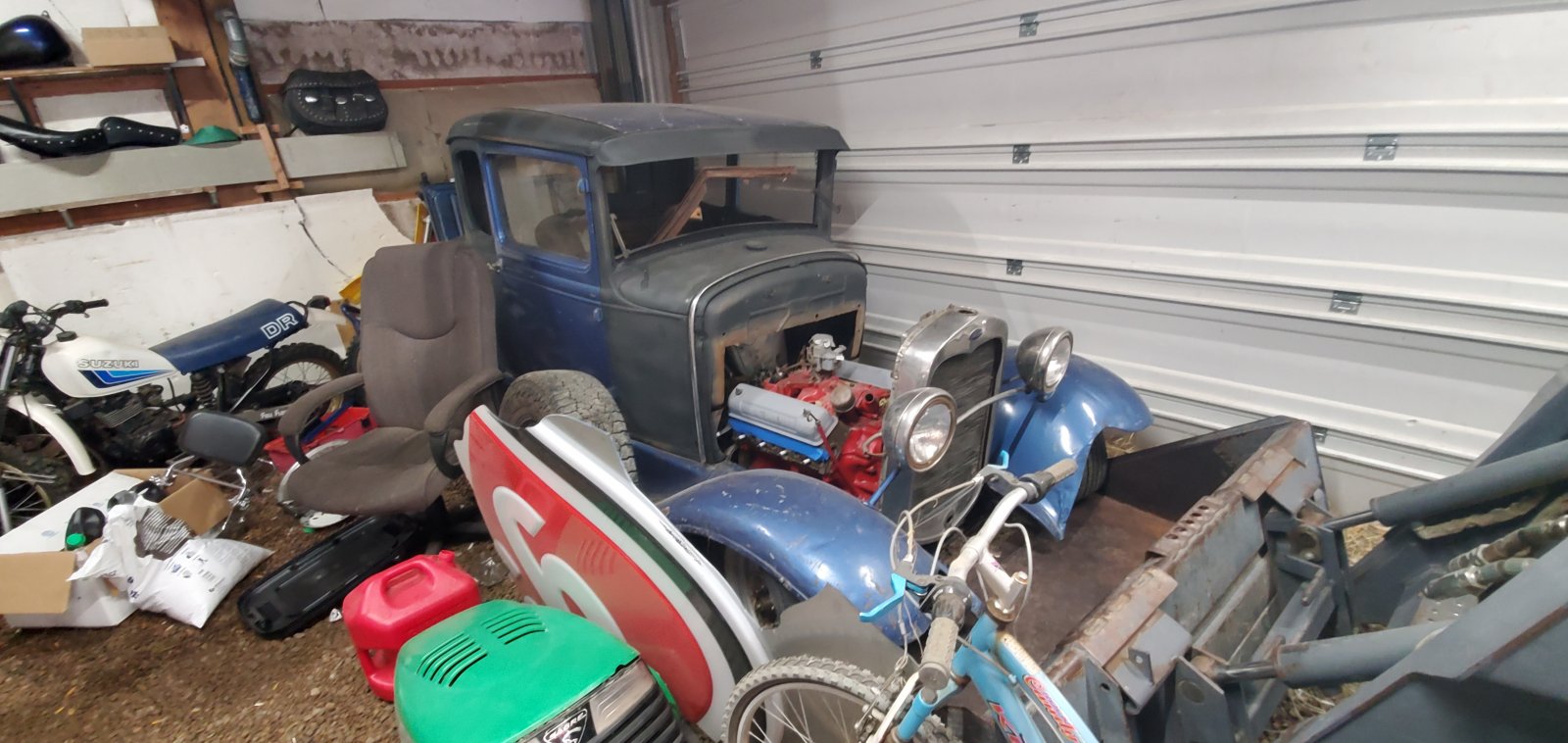

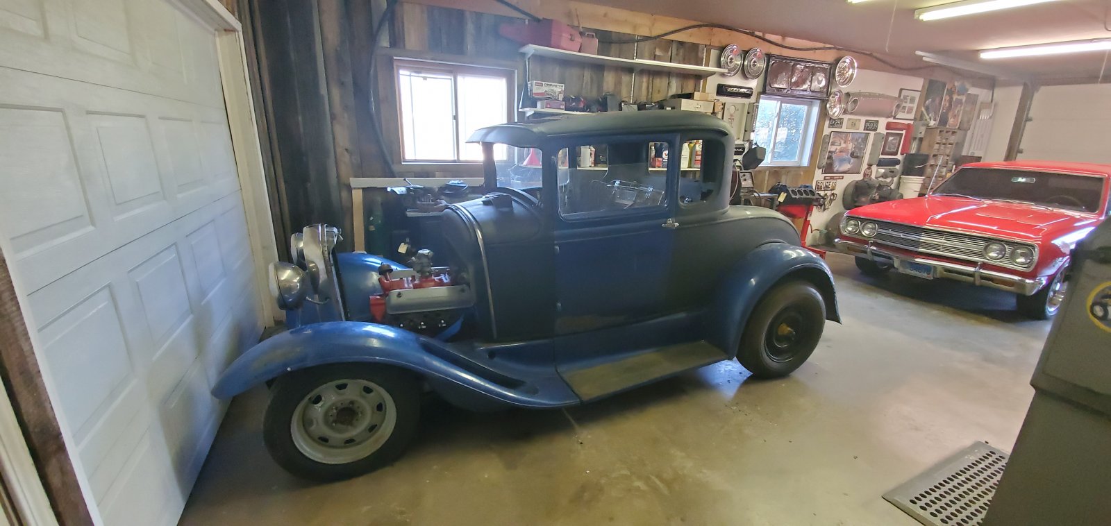

    I recently found this A not far away stashed in a storage building. The owner reluctantly sold it to me and I am in the planning stage now trying to decide the details of the resurrection.
    It has a 54 Ford y block engine 39 trans 48 banjo rearend dropped and drilled front axle with haipins. I am definitely going traditional with 16" bias tires 40 steel wheels 4 " chop and keeping the fenders. Oh, the 58 chev tailights have to go.
    I'm stuck on steering as I can't find a 1948-52 F1 box and column and I really don't want to use vega box and cross steer.
    The goal is to build it safe and be eligible for nostalgia events like the Colorado Hill Climb. I will post progress as it happens.

    Good news! After some networking with my car club buddies I found a F1 steering box and column. For me one of the joys of a new project is scaring up parts.

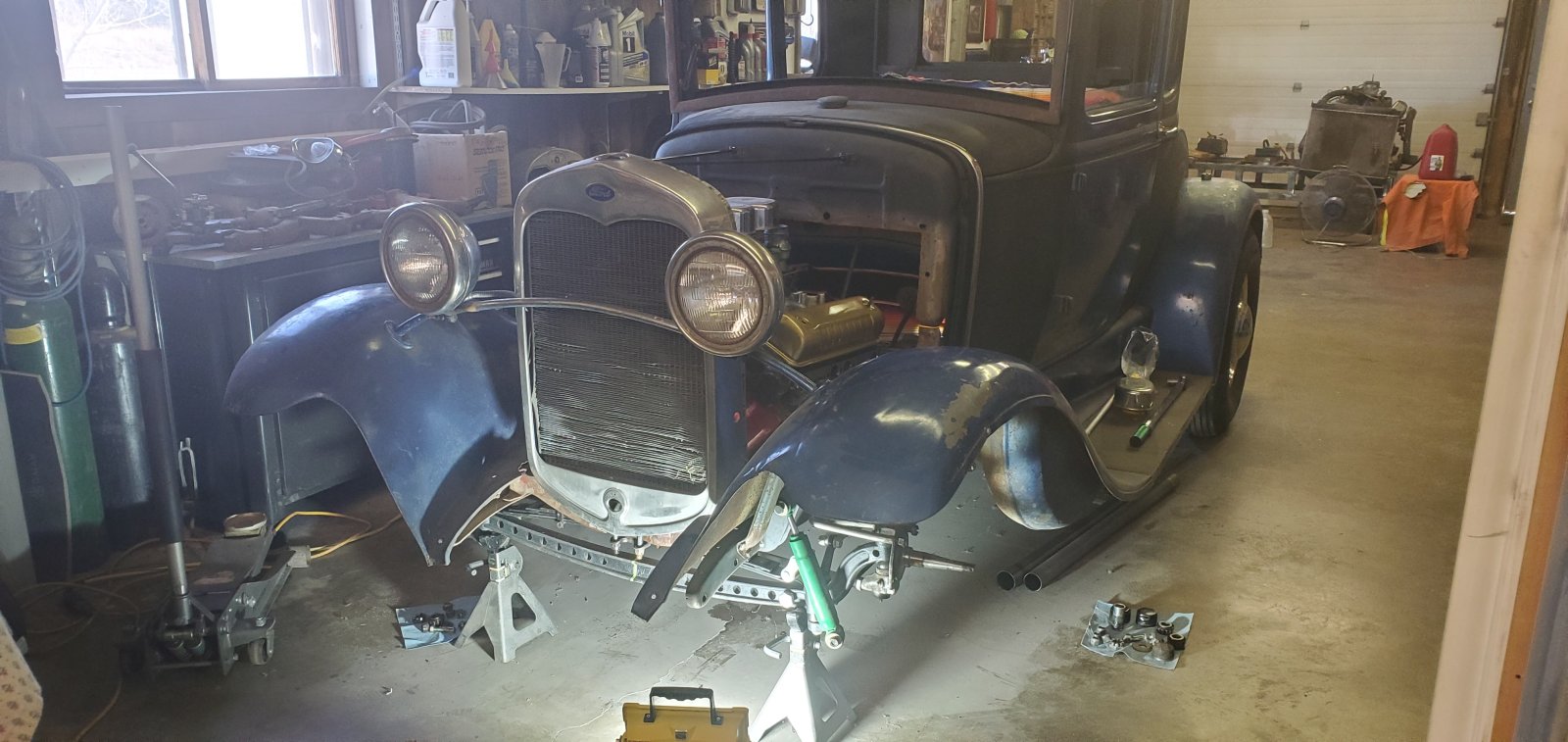

    Update on my Model A. After a accident in early September that laid me up for months I'm back on the project.
    This is going to be a traditional revival so I sourced early drum brake parts and replaced the disc brake in the front. I restored 1940 16" wheels and bought Firestone bias ply 750x16 rears with 550x16 fronts. I found original 46 hubcaps and ribbed trim rings and after polishing the parts the rolling stock looks good. The tire stagger helps with the vintage rack too.
    Next I started building a Speedway lakes style header kit. Everything went smoothly until I realized I welded up the rear feeder tube without cutting the hole in the collector tube DOH! I fixed it.

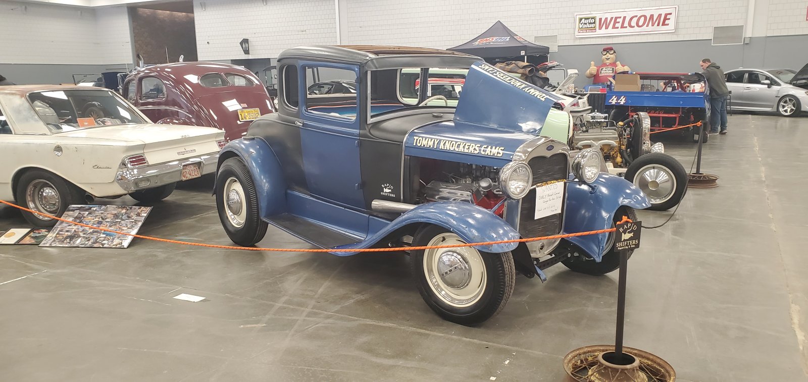

    The annual Counts of the Cobblestone car show was fast approaching so I turned to cosmetics by cleaning the paint and interior...more details later. I made it on time to display the car with the Rapid Shifters car club display.

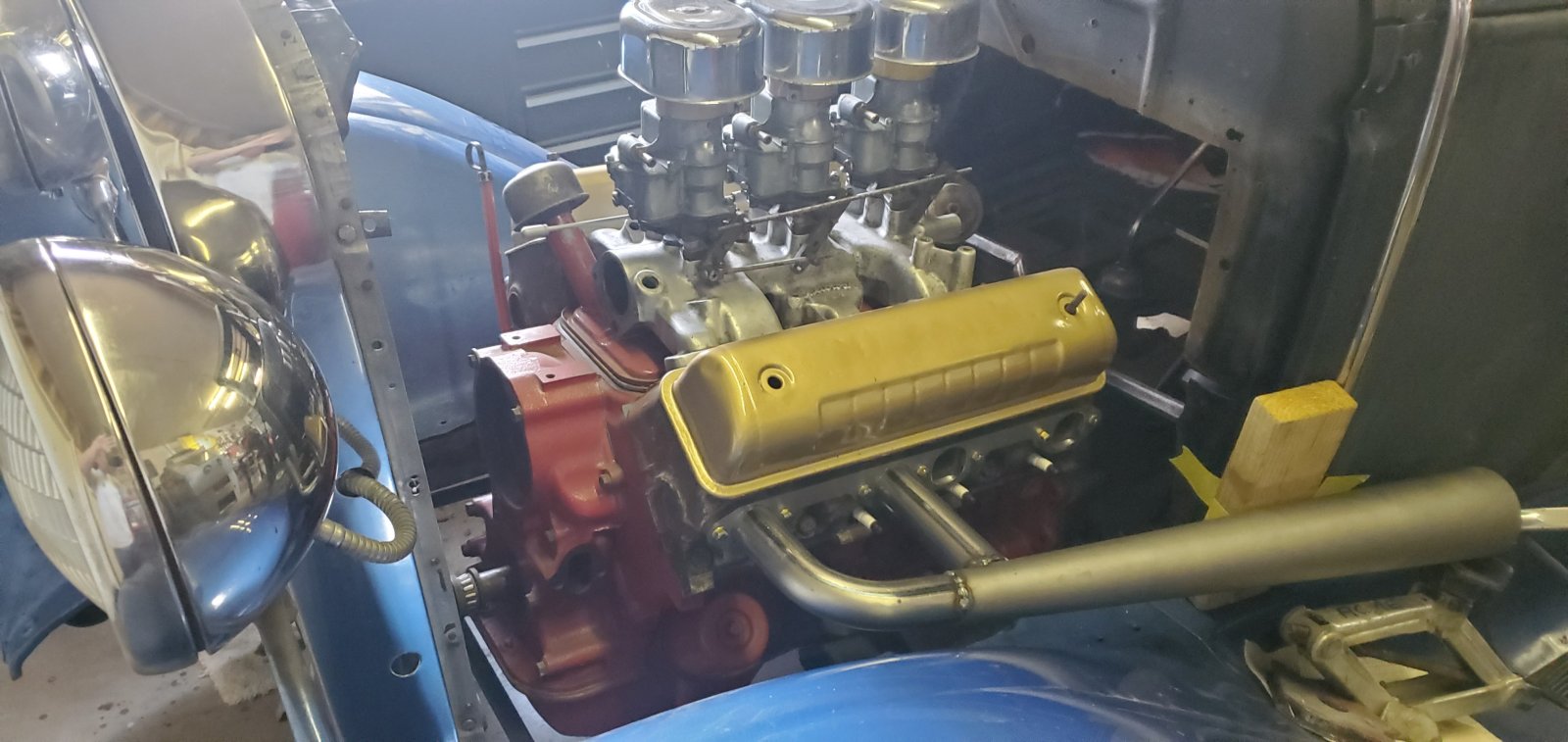

    Progress report on my model A coupe. My 272 y block is sorted out with an Offy 3x2 intake but only using the 2 end holley 94 carbs. Linkage is direct, non progressive and works great. I fabbed the headers from a Speedway kit and coated them with KBS high heat paint.
    I had the front dropped axle replaced cause is one of those **** Hoffman group flimsy pieces. I also pulled the front disc brakes and replaced them with traditional drum brakes.

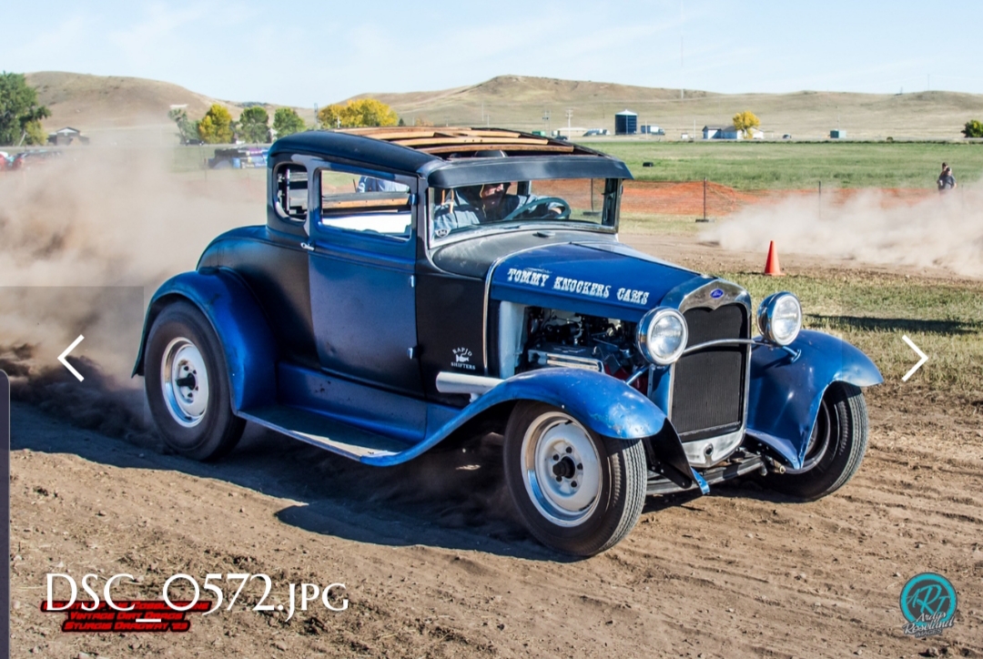

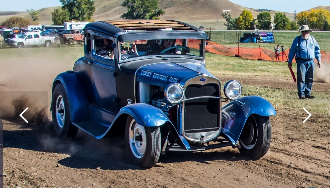

    I haven't posted any updates on the Coupe in a while so here are some random pics. The engine is totally sorted and runs great,. I have full exhaust on the car with cherry bombs. I painted the car with a special mix of blue and added louvered the truck lid. The roof is next in line for a louvered insert. The custom door panels are aluminum.
    This year I raced it again at the Vintage Dirt Drags in Dakota. If you don't know about the event check out Facebook for Sturgis Vintage Dirt Drags. That page has drag info, dates, pics and vids from previous years.
    Next move on the A...get the louvered roof installed, get the 3 rear windows in and drive the hell out of it.
