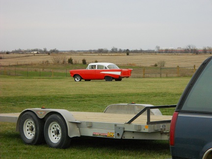

    Thank ya guys. I have no updates to report, other than it didn't get on the last transport up here. The guy is planning on picking it up on his way back to California. He will then drop it off on his way back through to Michigan. He bought a house in California but is divorced and one of his kids is still living with her mother here in town. He comes back through to see her and is going to drop it off while he is here. That means I will hopefully have it in two weeks or so. Hopefully sooner rather than later.

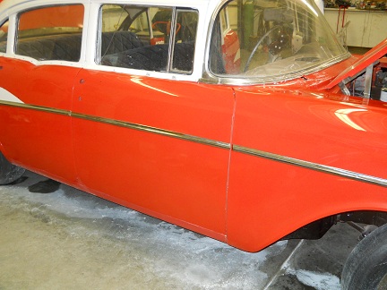

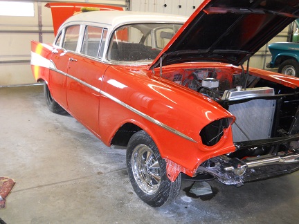

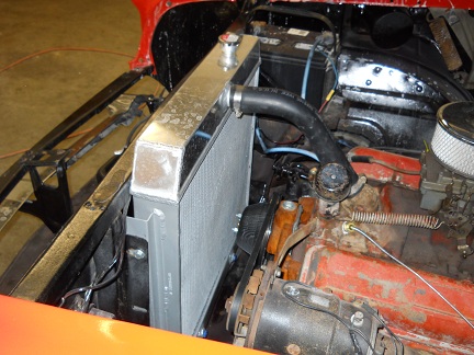

    Well, Sunday night we went to wetsanding on the right front fender because it's the worst. The whole right side it now wetsanded, buffed, and polished. I have all the stainless put back on the right side, too. It looks purdy good, even if I do say so myself. The new radiator came in on Wednesday. I got it put in and we had it running for probably a half an hour or so. We have been working on the brakes and actually have a small amount of brakes. I took it on a little trip around the yard today for probably 20 minutes, just driving in circles. IT WAS AWESOME!!!!:D:D:D Tomorrow we will get the brakes ironed out and maybe I can take it out on the highway for a little test run. It makes some noise in 1st gear but is quiet in 2nd and 3rd. Is this normal???:confused: I will make sure the trans and rearend are topped off before I leave. And check the antifreeze and engine oil, too. Anyways, here are some pictures. Roger, sorry I didn't respond sooner to your emails. I forgot to check my email. A buddy of ours was a mechanic at a serice station for years. Hopefully he will be able to shine a little light on the rearend seal. Wyoruffneck, that's a sweet car you have there. I like the colors. I would like the thank everybody for all the help and encouragement, especially chevy57dude. Thanks to all. Please enjoy the pictures.

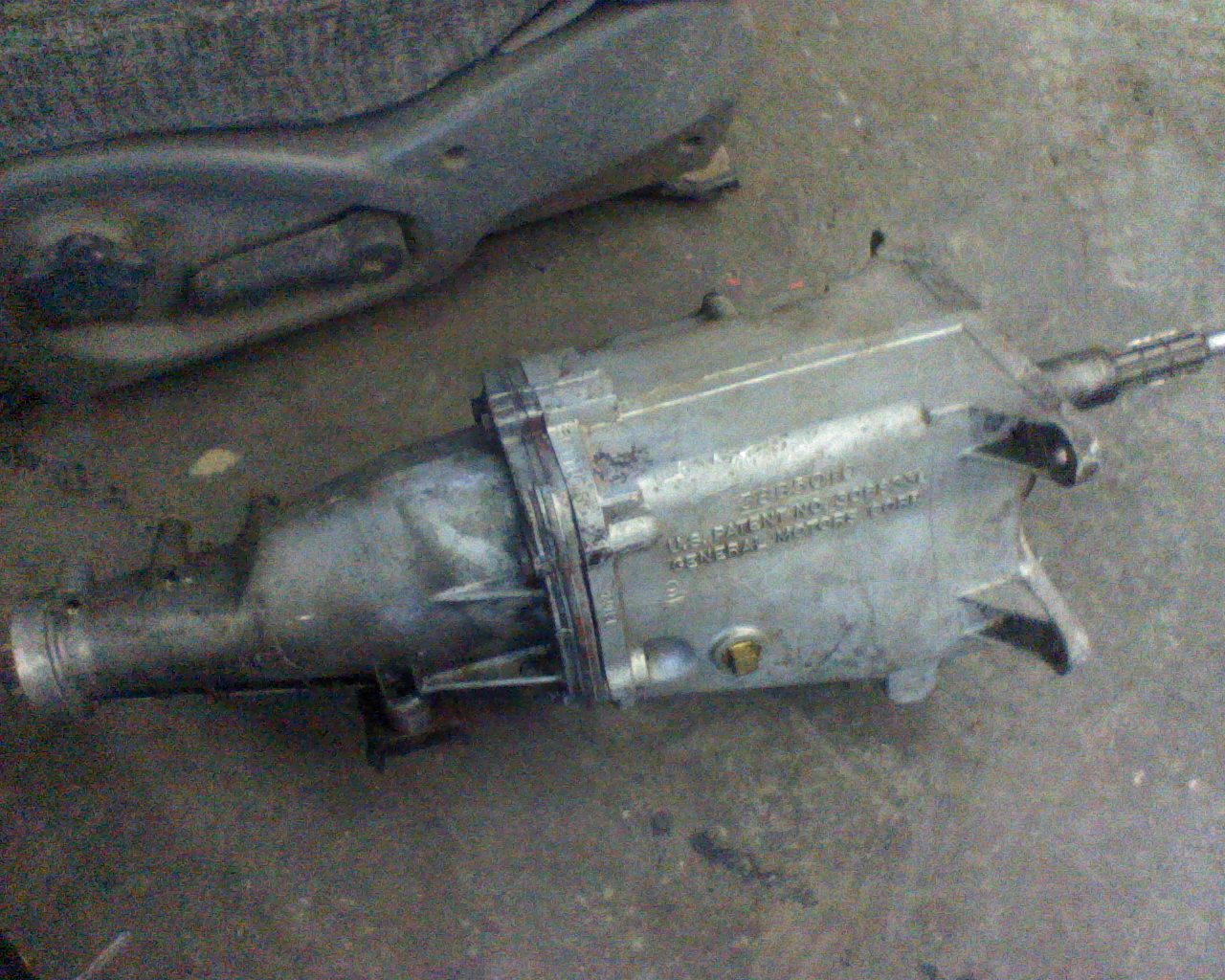

    Well, we got the drivers side floor pan finished. It only took us about 2 hours to do, compared to the 4 or 5 it took to do the other one. Christmas was purdy good to me. A friend of ours gave me an old Muncie 4-speed trans.:D Now I gotta find a shifter...:eek: My parents got me a new carpet for it, and a complete door/trunk/glovebox/ignition lock set and a pair of chrome quarter panel side scripts. I only have pictures of the trans, but hopefully I can get some pictures off the rest of the stuff as I put it on.

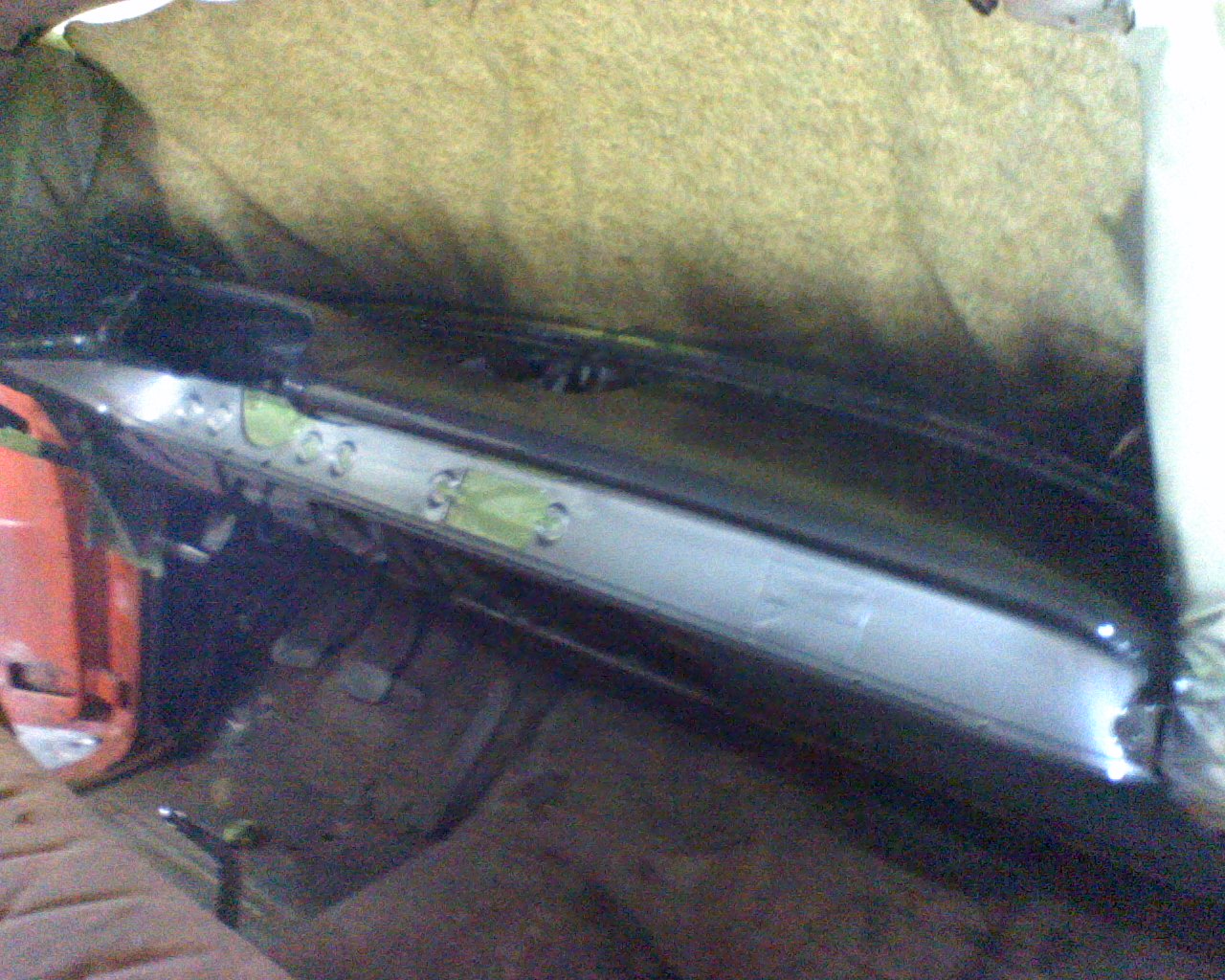

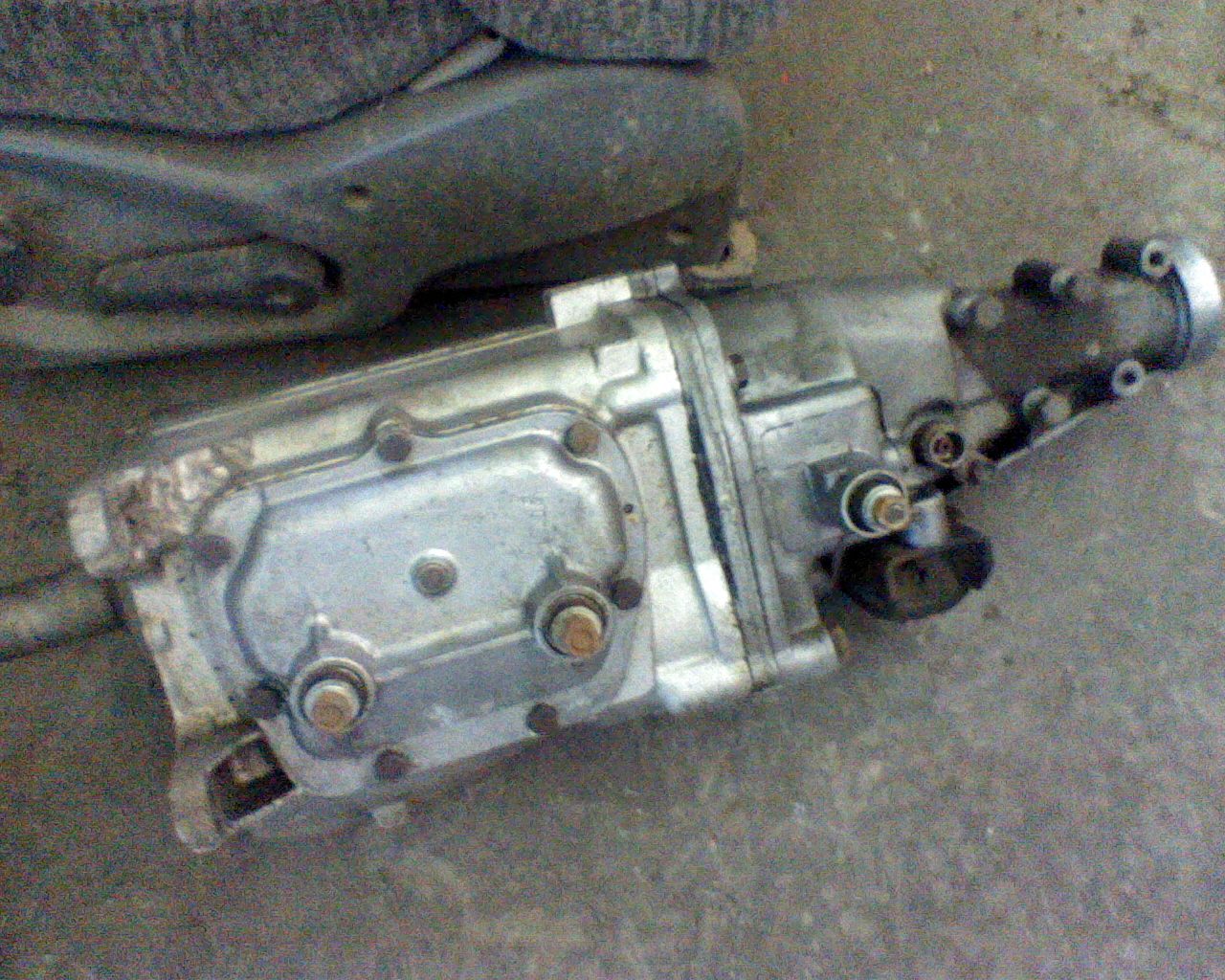

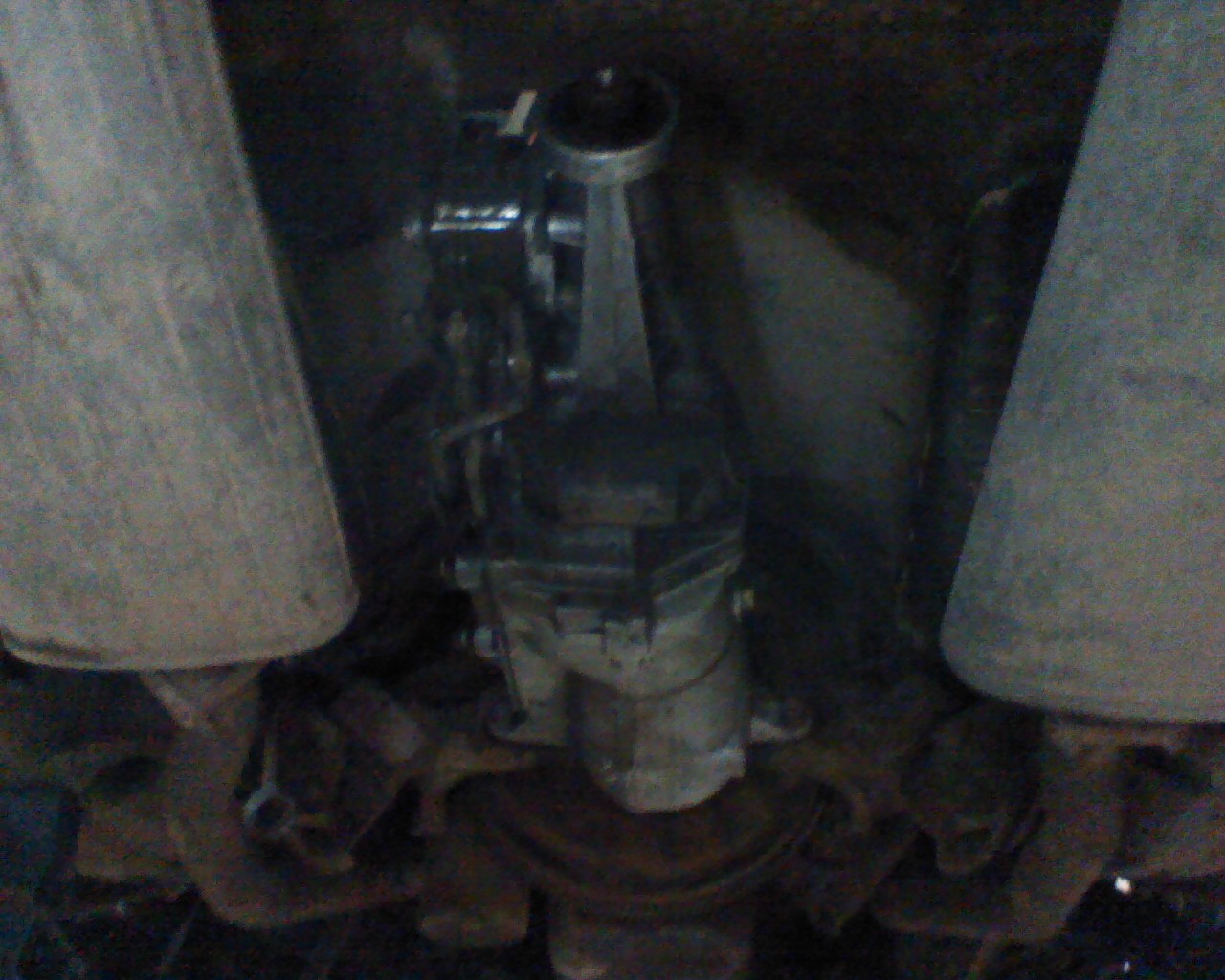

    Thanks for the compliments, fellas. Well, a lot has happened in the last few weeks. We got the 4 speed installed and the rear pinion seal changed. Now it no longer leaves puddles on the shop floor every time we move it. I have yet to drive it with the 4 speed, but I can hardly wait. The guy that gave it to me was able to locate a Hurst Compe***ion Plus shifter for it, so I can't wait to bang through the gears with it. This last weekend dad and I painted the dash. It's not to bad for my first paintjob, even if I do say so myself. The middle part is silver and the rest is a dark charcoal metallic with big metalflake in the clearcoat. I just got my order from danchuk today with my window felt kit. Does anybody know how to install them??? They have me perplexed. Here are some pictures. Enjoy.
    -Philroy
    1st picture: trans in the car
    2nd: dash with basecoat
    3rd: dash with metal flake and clearcoat
