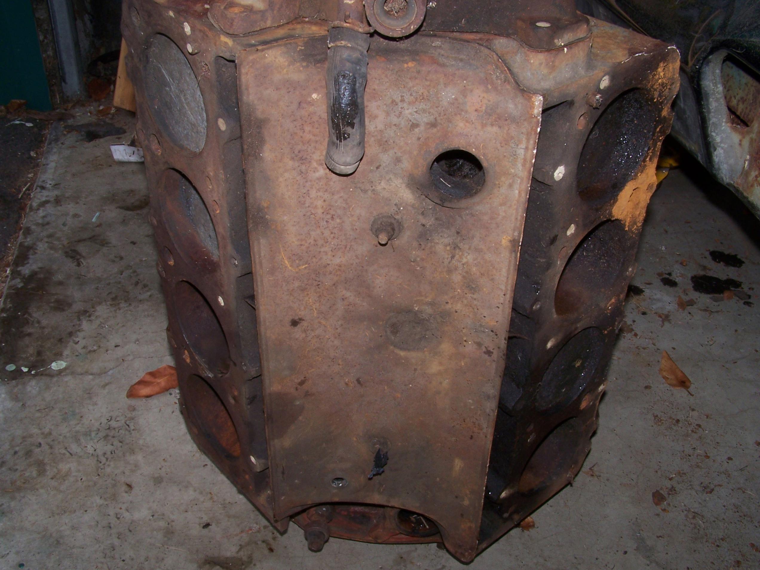

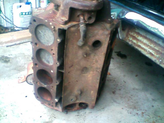

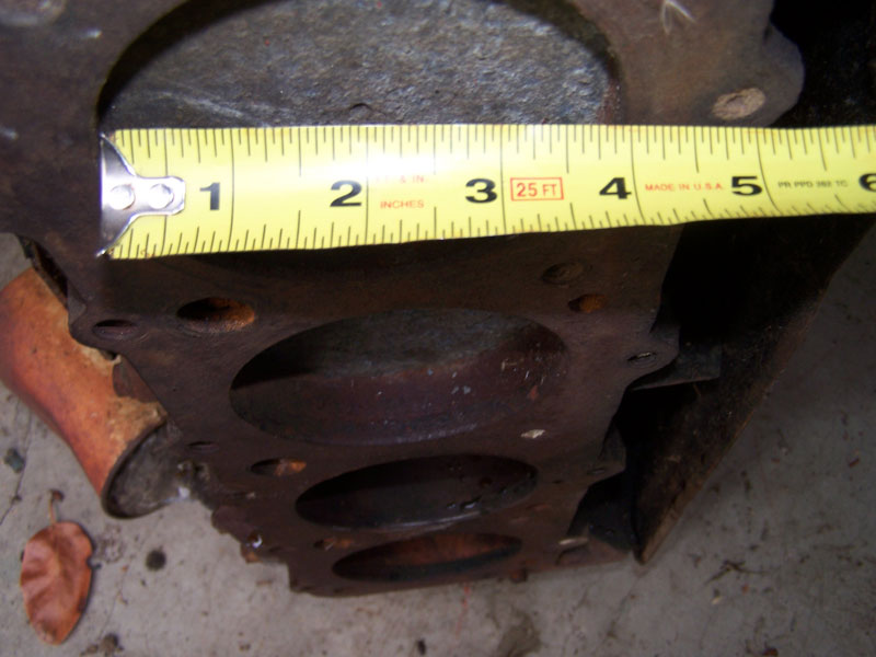

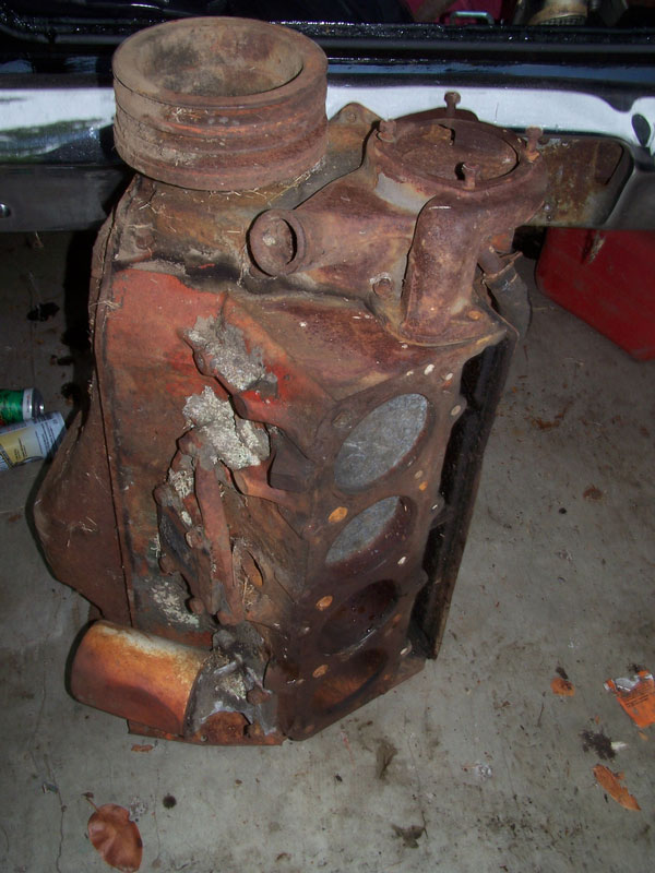

    Just finally purchased a 327 block, and im planning on doing a modification to a torker, to make it fit, Pics coming within an hour.

    Here we go!
    327 pictures.

    Before going too far--check the engine mounts on the block with those that are on the engine in your car. The engine mounts were changed starting in 1963 and 327s were around before that. If it is the same, good for you. If not, you may have to fab something. Not sure if you have looked at American Parts Depot in Ohio or Egge in California but both have everything you need for your engine. Gasket sets are cheapest at Autozone from what I have found. You may want to make a list of everything you will need. Rebuilding one of these can cost $3000 easily if you use all new parts. Ebay is a great source for some parts. Just keep in mind Jeep and Gray Marine when doing your search. Good Luck.

    The engine was out of a 64 ambo. Im not worried about motor mounts, worst case, ill mount the engine in solid.

    The difference is the 63-66 287/327 has two extra bolt bosses on the side toward the center compared to 56-62 250/327 V-8s (287 came out in mid 63). The early engines have two bosses on each side on the front and one a bit further back. The "back" boss is used as the front on the 63-66 models. 56-62 had four point mounts, 63-66 three point. Late blocks have the front mount bosses, early ones don't have the side mount bosses.

    RamblerClassic -- there are no $800 rebuild kits for the 250/287/327 -- not with oversize pistons anyway (you can get one less pistons for under $800). Kanter sells the basic kit that has pistons/bearings/gaskets/timing chain and gears, but no cam, for $1043.08. The pistons are made by Egge Machine -- you might trim $20 or so off by going directly to them, but that's about it. Check with NAPA -- they might have a set of oversize pistons languishing in a warehouse. Have them check nation wide! Good luck on that...

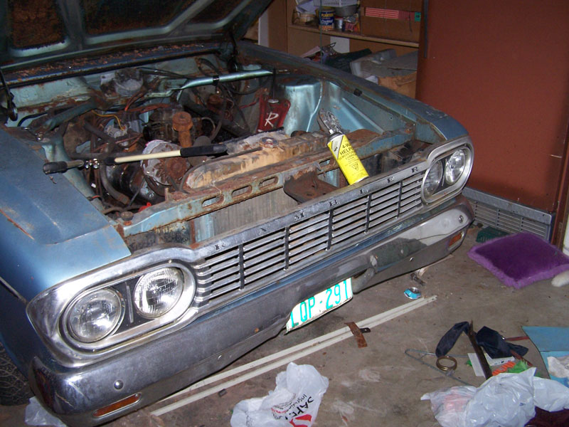

    Well, the project is taking a drastic turn. (I believe for the better)
    Over the past 3 years of playing with this thing, i still dont have any progress on the engine (but quite a bit of progress on the chassis) and pardon me if this is not considered "traditional".
    Im going to rebuild my 327, not bore it, and build the engine around Turbocharging, i want to have the biggest, most badass gen-1 Rambler engine ever conceived by man, due to low aftermarket support, doing this all-motor would be next to impossible, so forced induction is my only method, and no superchargers were ever made, and turbocharging is quite popular nowadays, so i might be able to get pointers from people i know. I hope to push upwards of 700+ HP with this engine. The idea would be more of a "Thunderbolt" type deal, a Factory Experimental dragster.
    Sorry if i just lost interest with the traditional-resto guys, but i want something i can have fun with, not sit in my garage getting no miles.
