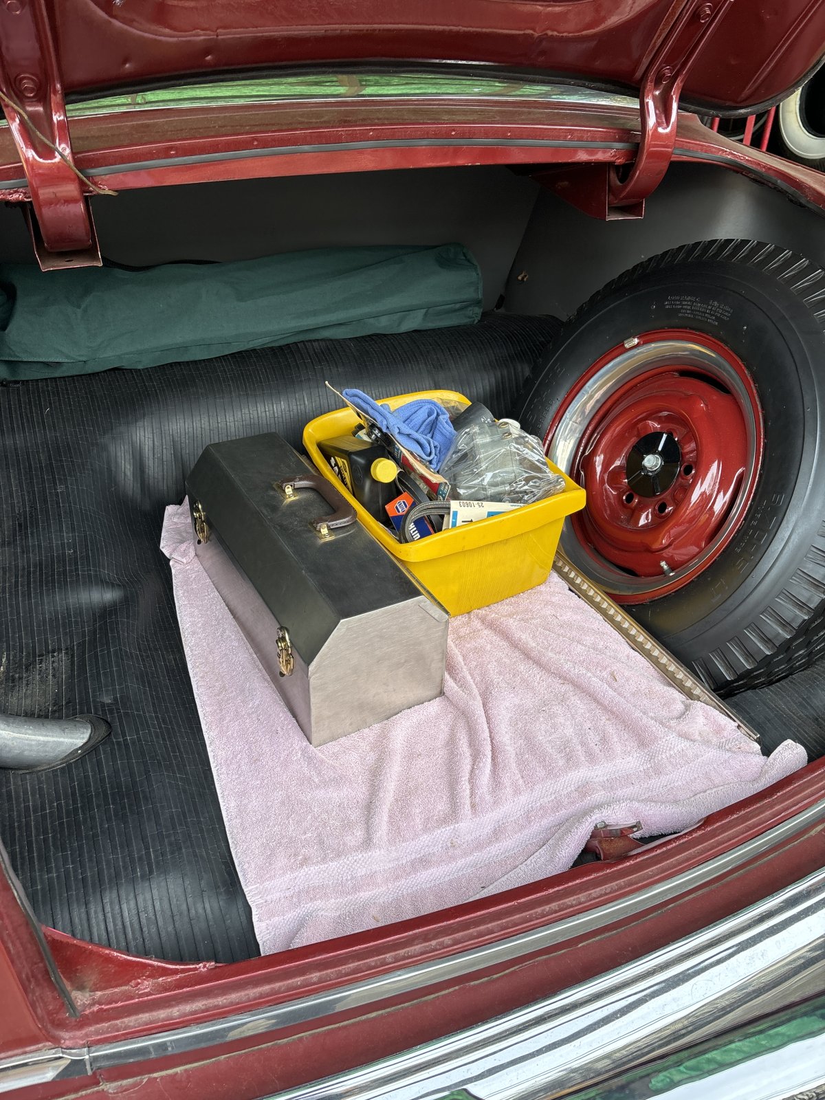

    The over riders are crazy cool, but it must be a right pain to get into the far corners of the trunk or the hood.

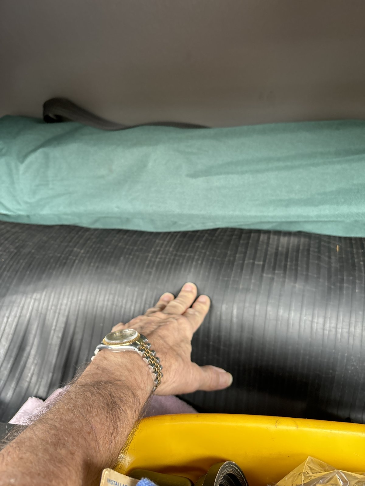

  12. lostn51
    Joined: Jan 24, 2008
    Posts: 3,331
    lostn51
    from Tennessee
    You know I really haven’t tried digging in the trunk yet but as far as under the hood it’s not bad at all.
    Okay tried the trunk and it’s not too bad but I’m reaching in as far as I can over the trunk guard. So yeah it looks like it might take a little finagling

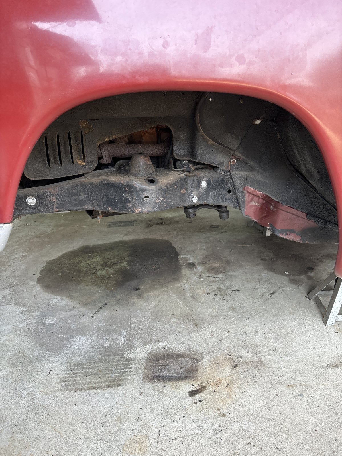

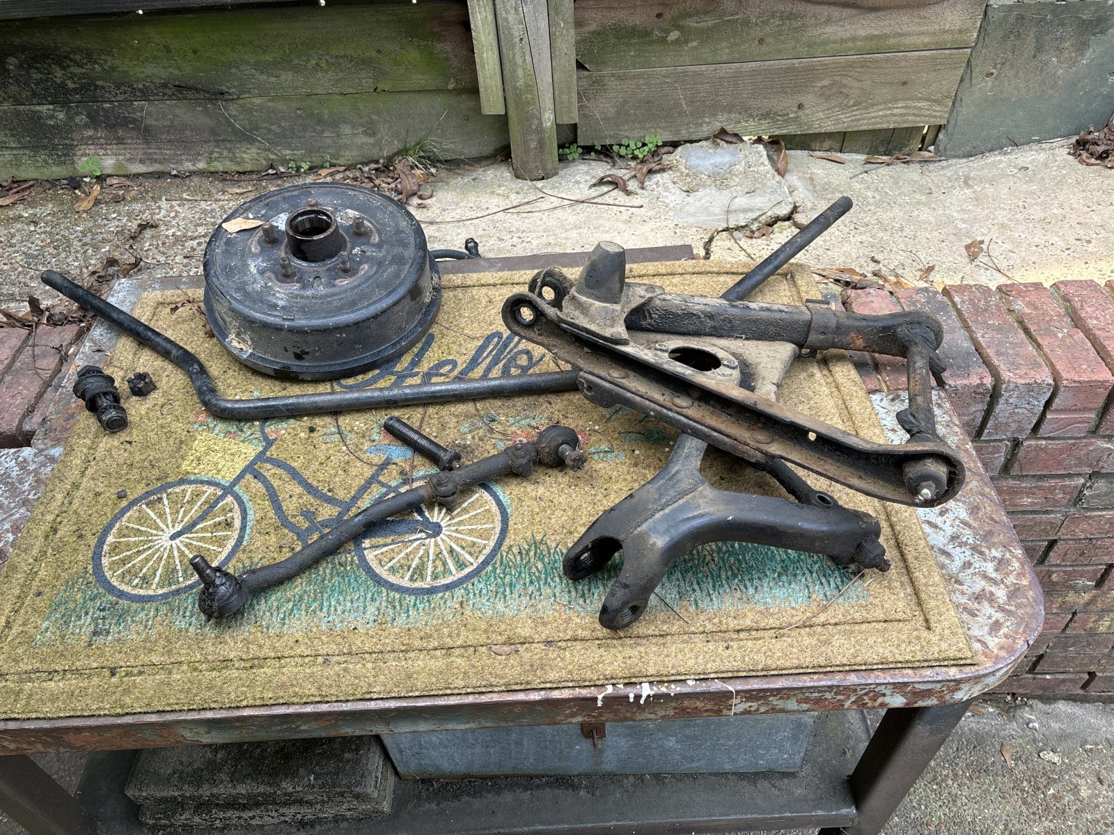

    I finally ordered the parts I was missing from Shoebox Central for the front drop and got a call from Chris wanting to know if I would be okay with some shocks that were returned or I could wait until next week for a unopened box set. I told him that it didn’t matter and while he was here……. I ended up buying the rear leaf spring kit to drop the back a full 5” and it should sit nice like my previous Shoebox. I will say this Chis is one hell of a nice guy and super helpful!!
  20. lostn51
    Posts: 3,331
    lostn51
    from Tennessee
    Well kids since it’s warm out (70’s) I couldn’t wait to get out of the house and start doing something to my car. So I started putting the disc brakes on and while I’m at it go ahead and put the dropped springs on. After messing around with trying not to mess up anything I said to hell with it and pulled the entire front end off the car so I can clean up the frame rails and under the wheel wells and paint them. And even though the front end didn’t have around 10,000 miles or so on it the rubber around the ball joints and a arms were looking kinda soft and since it’s been 25+ years since dad rebuilt it I figured I would replace all of it since I only have 20 of everything you need to rebuild one. :D So now I need to clean and paint all of the stuff I pulled off and maybe paint it next week if it’s going to be nice out. And yes it does kill a car just sitting there not doing anything because it’s nasty and tons of spider webs underneath it. image.jpg image.jpg
