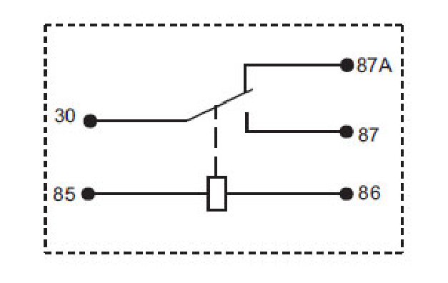

    Paul, put a relay in the ignition circuit [if you have good oil pressure :D]
    #30 goes to ignition switch
    #85 is bridged to # 30
    #87A goes to Coil/Ballast etc
    #87 is left "dead as a dodo"
    #86 splices into the oil pressure sender for a ground
    [you can also use a "disconnect button" on #86 to start, but you're better off leaving it alone and always having oil pressure when it starts]
    A VW flat 4 oil pressure sender switches off at 8 psi
