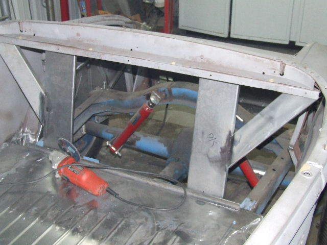

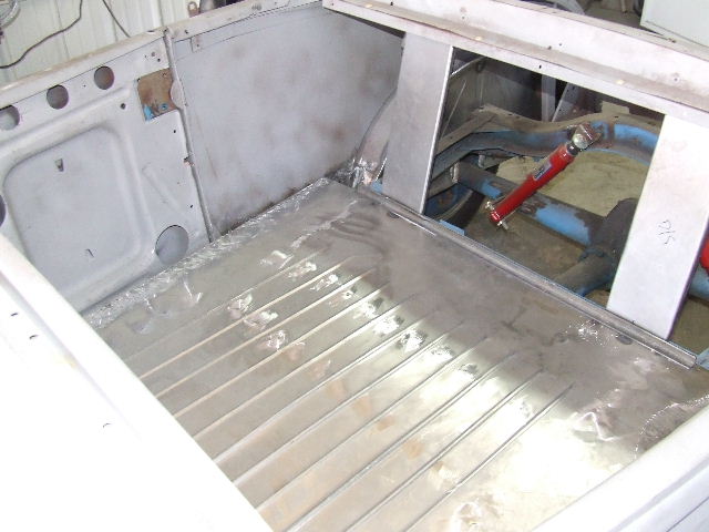

    Finally figured out how I wanted to construct the new subrails/floor ***embly. Which presented a tiny bit of a challenge because the body was originally welded to the frame, and I couldn't afford to lose any interior space nor raise the body from the original design. Also, the body needed to be better supported, so I came up with the idea to construct new subrails that channeld the body....

    Good idea...especially in light of the safety issues.

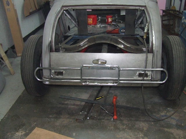

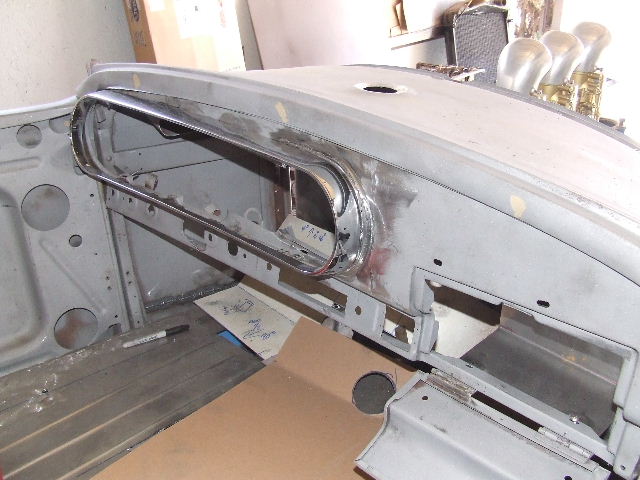

    Still moving ahead on the roadster, lots of little tedious things are done, plus got the rear bumper mounted in a better manner, body bracing, the dashboard has been fine tuned a bit, floorpanels are finished, pedal ***embly hung etc etc. Closing in on being done with the body metal work.
  26. Looks like you're gaining momentum!
    I was just looking back at those ch***is pics....were there any mods done to that rear cross member or spring? It looks a little lower than stock. (The wheels are turning in my head if you can't already tell)

    from Central NC
    Stock cross member
