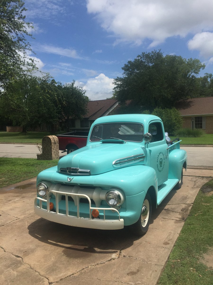

    Yall might have seen my 1951 Ford truck pop up on the forums before, and I appreciate everyone who has indulged me on my crazy build ideas and non-traditional thoughts. The original plan was to take the 8BA flathead out of the F1 and drop a 351W out of a cougar 1969 XR7, and do a mustang II front and a 9 inch rear, but I worry that is going to lose its soul and character and become just another cookie cutter custom F1.
    So I want yalls opinion and thoughts and experience on this, but you have to know the truck. Its a 1951 Ford F1 that has been the family farm truck for years, and it used to be a prison truck at Angola in Louisiana. It has a prisoner built bush guard, headache rack, and steel bed, and it has an 8BA Flathead and 3 on the tree trans. The flathead is pretty tired, so I am faced with a decision. I dont want it to lose that rough and tumble farm truck appeal, and I would like to make it look and feel like something you might find hauling a Model A hot rod in the 1950s. THIS IS GOING TO BE A DAILY DRIVER AND WORK TRUCK LIKE IT WAS BUILT TO BE
    The engine choices are: The 8BA flathead that is in it VS a 1958 Edsel 410
    Edsel pros - period correct sound and style, 350HP and 475 Ft lbs of torque, done and machined and ready to go, perfect power curve for a truck, oddball engine that adds character
    Edsel Cons - going to need a trans for it, parts are a little weird, probably will need to swap the rear end to handle the power
    Flathead pros- original engine, Flatheads are cool and sound awesome
    Flathead cons- tired and low on power, needs a complete rebuild, still needs trans upgrade, definitely going to need speed parts to keep up with Florida traffic
    So what do yall think? also, What am I getting myself into?

  3. willsullivan
    Joined: Apr 16, 2016
    Posts: 83
    willsullivan
    Haha yeah you know its! Im not really concerned with beating those rice burners, I know my ol truck looks better than they ever will. I just want it to be able to keep up with modern traffic and give my seat a tug every now and again
    Sent from my SM-G970U using The H.A.M.B. mobile app
