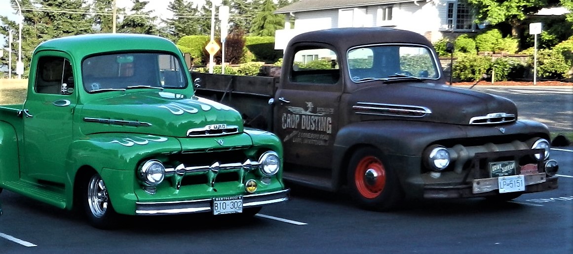

    How much does A/C draw on an upgraded flathead? I would not be keeping it stock

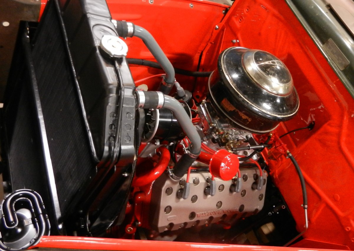

    390 cfm Holley
    Edelbrock intake
    Fenton headers
    Isky cam
    Ross pistons and crank
    Wilson Woods heads
    I will double check but I think 3.50:1 with really tall tires.
    The Tremec is out of a Ford so it has a deeper 1st gear. With the combination I can easily go from first to third, showing off I can go first to fourth and lug it out. Engine 274.jpg
