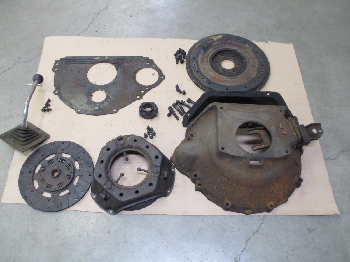

    I'm finding the 4 speed stuff to be pretty pricey, kinda makes me want to just bite the bullet and do a 5 speed. It uses all the original stuff from where the trans mounts to the bellowing forward

    The MEL motors are torque monsters. But they're heavy. Maybe more of consequence... they're huge. Are you willing to move the firewall back and lose leg room in a truck with limited legroom already?
    If I had this choice, I think I'd prefer...
    4in stroke Flathead... dressed.
    4-71 supercharger
    5 speed
    Traditional
    Good power
    Easy highway speeds
    And it fits right in there like it was made for it.
    PoTaToTrUcK and willsullivan like this.

    I've got room for days looking at it, and didn't these trucks have an optional 6 cylinder? I would think that would be longer than a large 8. Though I would definitely take that into consideration, I dont want to get halfway into it and then have an issue

    The 5spd is a great way, but(if you can find one!!) a Borg-warner "T-85" with OD was "Factory" behind that motor... Just another option, that's all....

    Yup, '70s-'80s Fords had the RUG 3-speed+OD trans. I have one in my '31 A-V8 and it runs great on the highway.

    Concerning the 5-speed, everybody knows there are always limitations and concessions made. You can't see 'em and it sure helps to have the overdrive, so transmissions are at the top of the list for an upgrade. Ya still got three pedals and a floor shifter.

    So I think the edsel with manual is the way to go, will need to build the car to suit the engine, I found a wilwood disc brake kit for the fronts, anyone have any experience with those?
