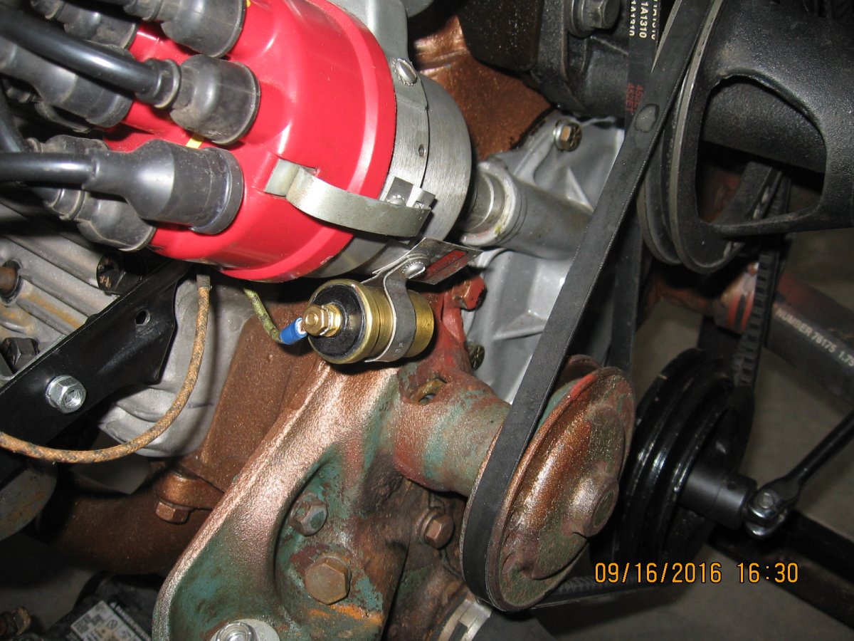

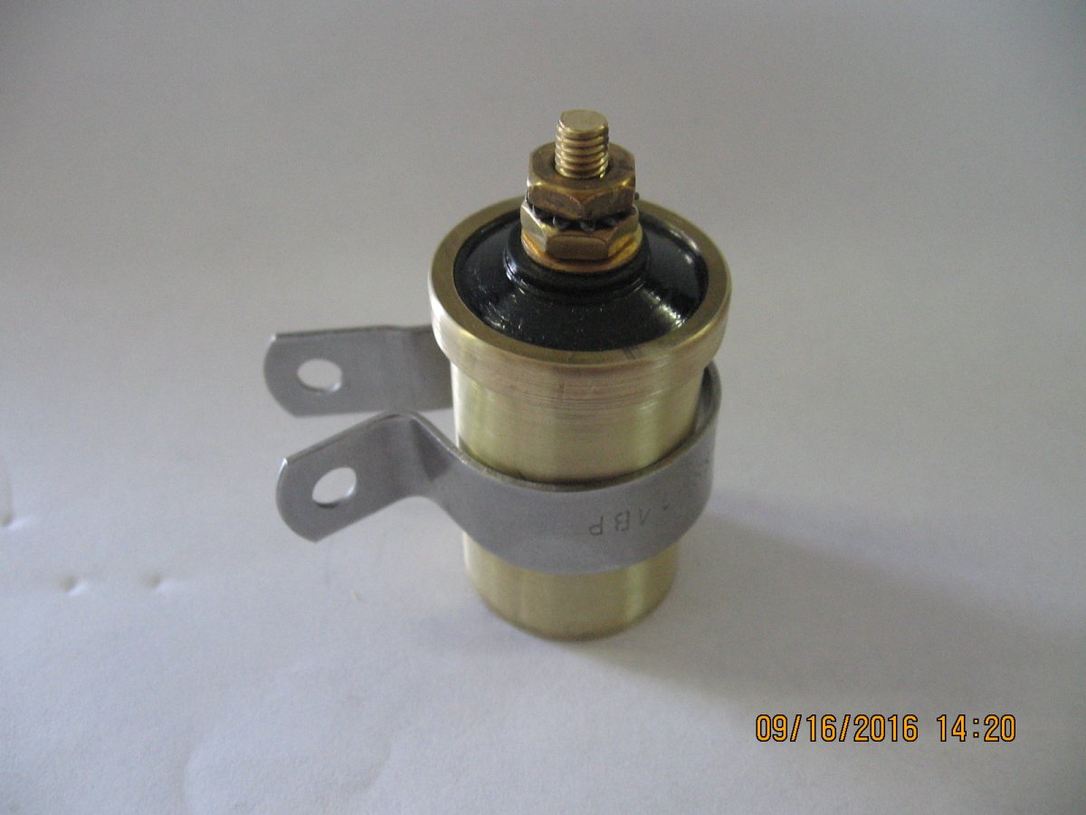

    "Rusty" - About condensers; I make my own "Trash Can" style condensers using modern severe duty film capacitors, and have quite a variety to pick from. I am making .22 micro-farad units (single points) and .33 micro-farad units (dual points) at the present time. My biggest problem is getting anyone using them to put enough miles on them to see if there is any pitting happening at all. So far, everything looks perfect.
