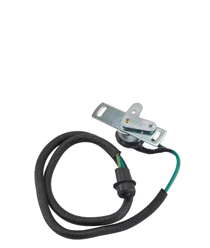

    Don't use the column..use the shift arm on the ****** and look into Muncie back-up light switches.
    Easy to fabricate a mount and wire rod to trigger the switch. Lots of different ones out there.

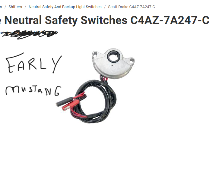

    First step is to look on the side of the transmission and see if it has the Neutral safety/backup light switch on the side of the transmission. As Nosford said, many of the C-4 transmissions had the switch on the side of the trans or it is real easy to install one in most cases and that solves the neutral safety and backup light situations without a h***le. This image is upside down as apposed to how it mounts on the transmission.

    Would this be where that part you mentioned hooks up to

    Yes, that is where the switch mr48chevy would install at. You definitely have a Ford C4 transmission from that picture. The switch will have 4 wires, two are for backup lights and two are for the neutral start switch.
