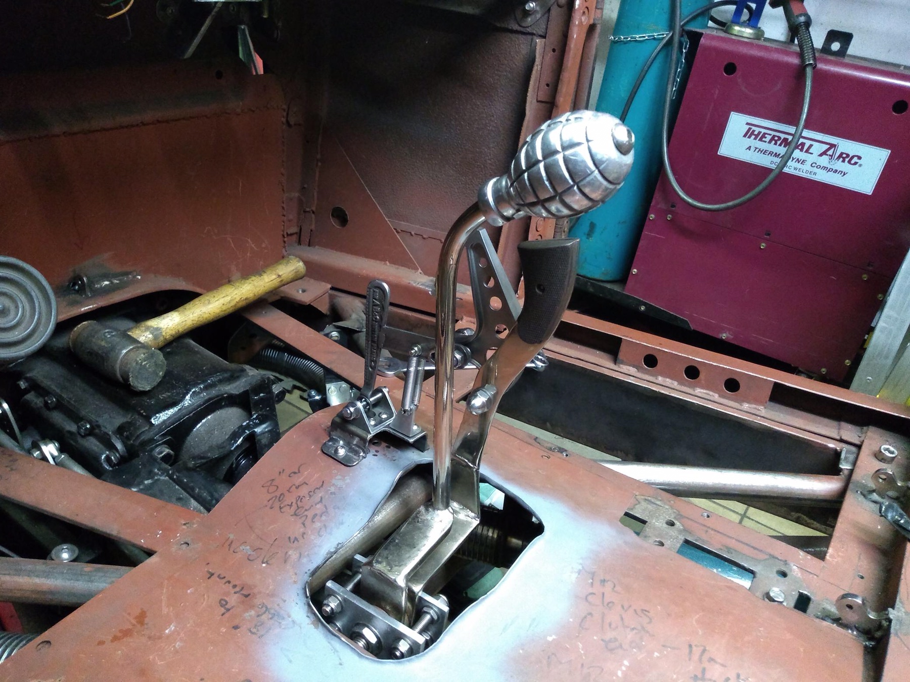

  1. Nearly finished the reverse lockout for the home made dirt track levers on my Modified. Will finish today and post pictures of the spring loaded catch.
    Handle is from a Viscount and the grips on the lever are from my S&W Combat Masterpiece. IMG_20181020_163845985.jpeg

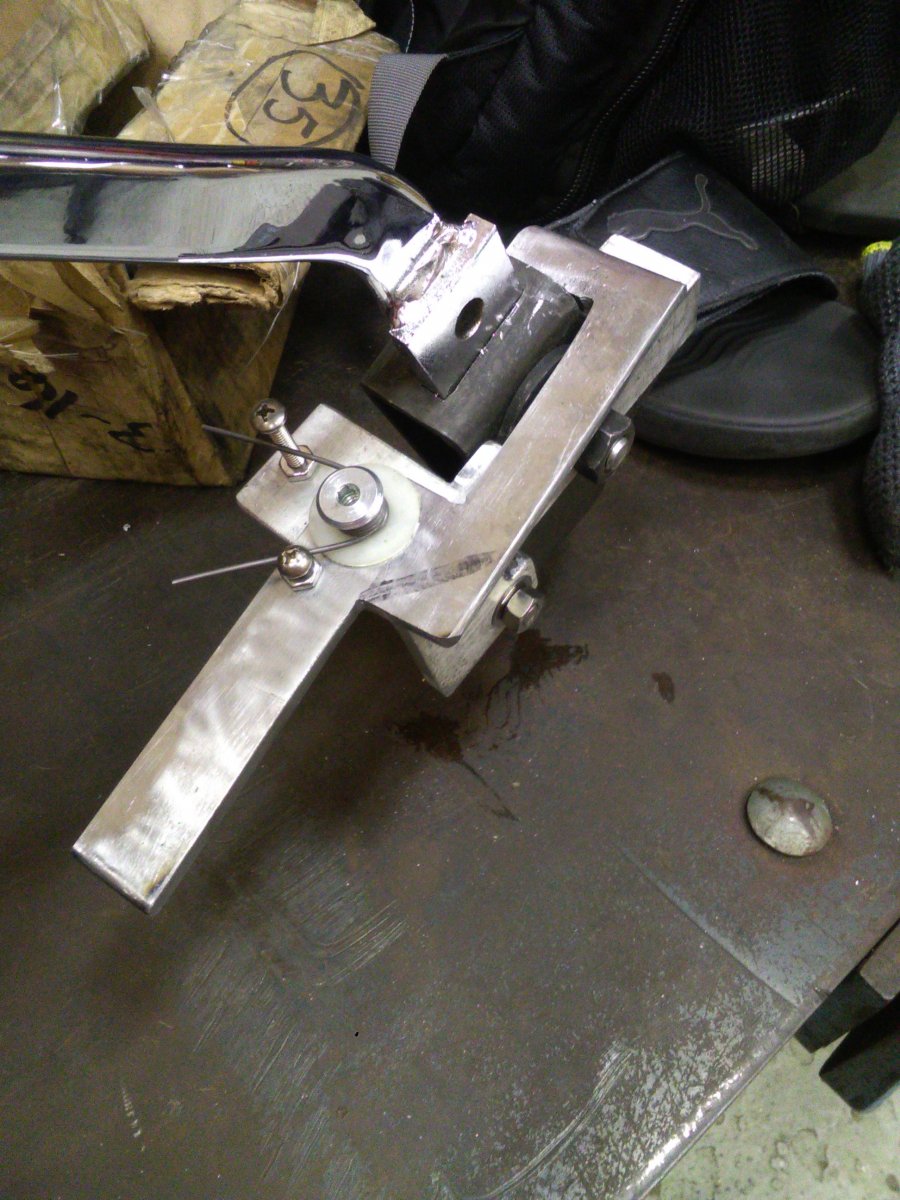

  2. Nice looking work. I'm looking forward to seeing the rest of it. Is this for an automatic or manual transmission? Here are a few pictures of the lockout I built for the Hurst Auto-stick shifter in Dads Dodge gasser. I will finish the lever when I get the car back from chassis shop purgatory. KIMG0058.JPG KIMG0059.JPG

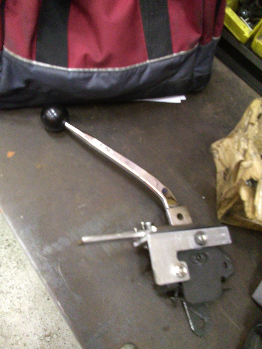

  4. Reverse lockout now done. Just need to put some rivnuts in the floor to locate it and prepare it for paint. IMG_20181027_184554901.jpeg

    Nice. I like the mechanical steampunk look.:cool::cool:
  7. I wasn't really aiming for that but I used bits I had (mostly aircraft stuff) and it just turned out that way. I didn't want to buy anything. The bit that gives it the steampunk flavour is the Jackson Patent Button Spanner - pre WW1 I think.
