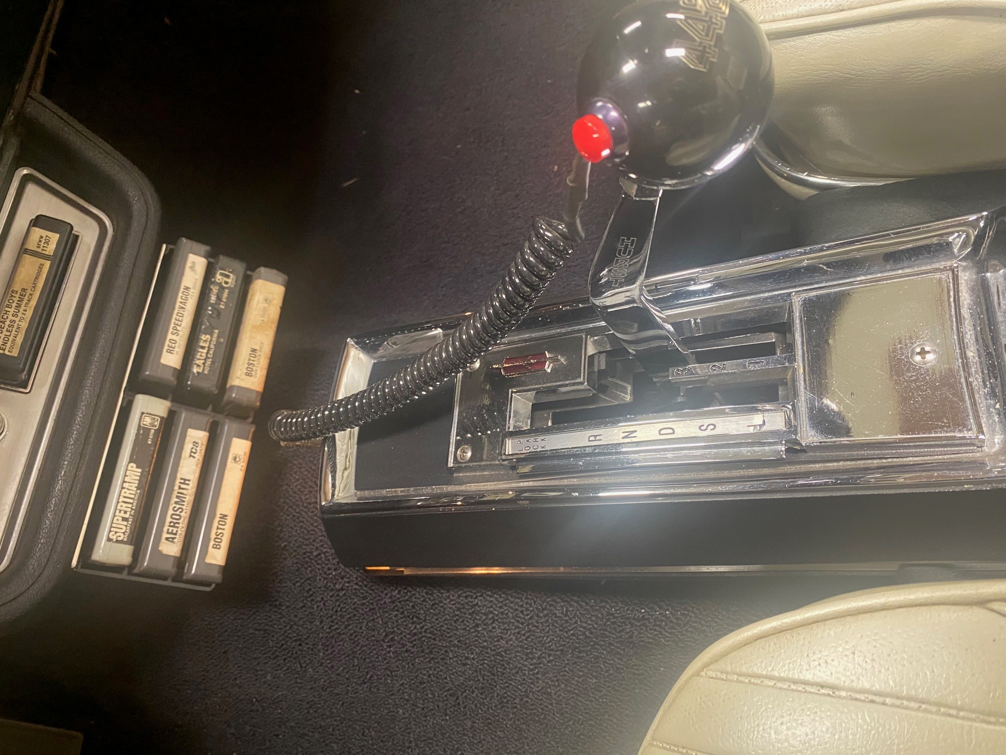

    Here's one. :cool:

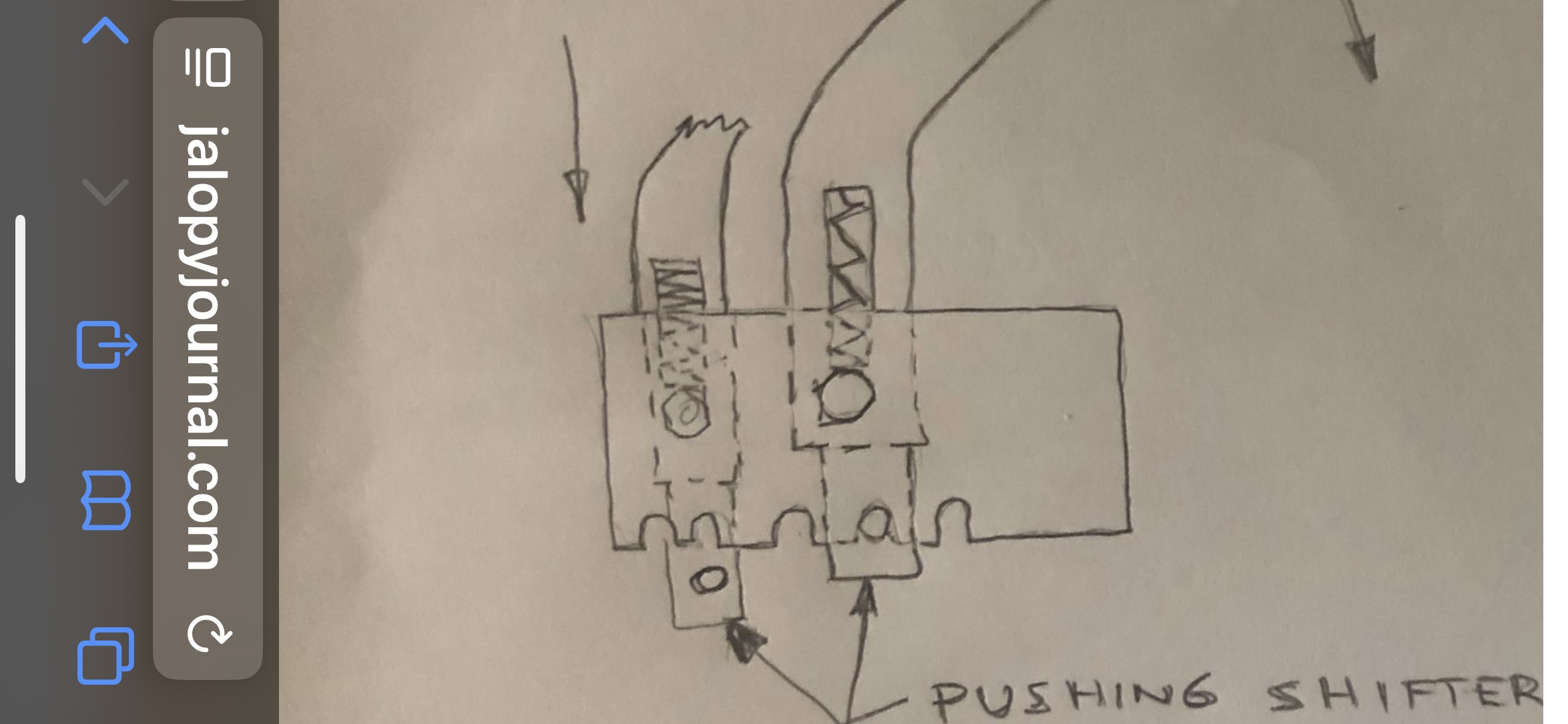

    Have to push down to move shifter. It’s a cheap shifter, I filed the detents a little deeper for a more positive shift. However it’s still fairly easy to push through the gears. I think the shifter could be bumped into neutral or reverse while driving. I think a lock out will be easy to fabricate.

    from VA
    @Sharpone
    With out seeing gates & in hand ,
    Most can be modified , weld up
    Filed & gated like you described
    You definitely want a positive
    " Reverse" lockout especially Neutral to Reverse Side

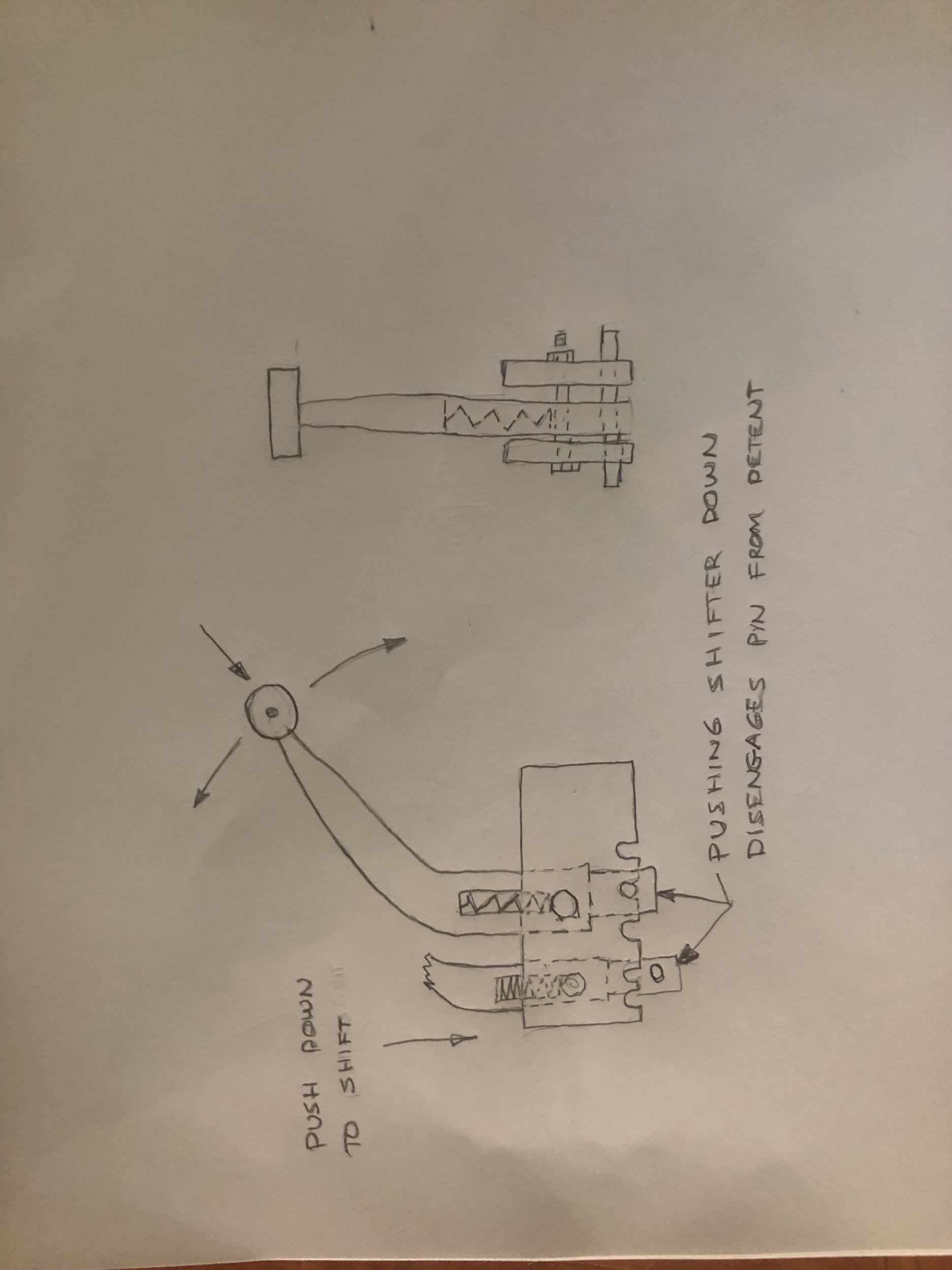

    IMG_3543.jpeg I think I’ll just make a sliding bar to keep shifter from engaging Reverse. If I can find a stiffer spring I may install that also.

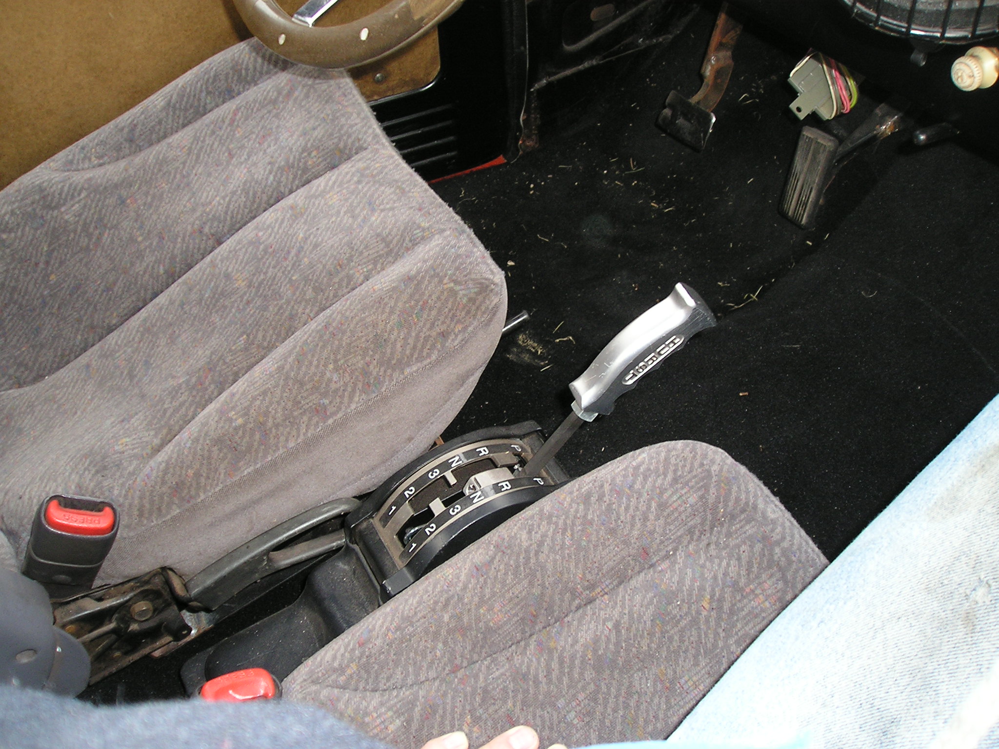

    Here is another aftermarket shifter with a neutral lock out and a reverse lock out. Not that hard to get into neutral if you needed to. Shifting into neutral, reverse, or park was an intentional movement, but could not be done by accident. I liked that shifter a lot, but it was sort of a pain when you were just using it like an old man shifter.
    Doing a "Rockford" turn from reverse to drive could be done with a bit of practice, that would be much easier then going from drive to reverse...

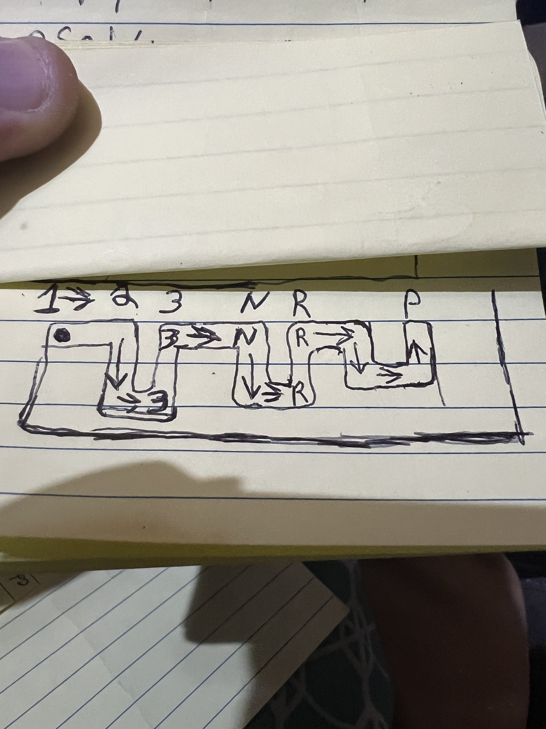

    When that Winters shifter first came out
    Just installed , later that Night , I had a street Race , Hit 2nd , forgot to push over for 3rd , Lost $500 , came home took shifter out & threw it to my woods.
    Really 1 of top 3 shifter's ,simple
    Where well made Hurst 1/4 stick .
    Glide or 3 Speed ..
    @Sharpone
    If wanting to speed time weld & filing
    I would be adding a cross bottom ,
    & Gating something like this ..
    & when I was 12 I drove a 66 c10 with just a rod about 30 inch long straight through the floor to the lever on a 400 turbo and White Hurst round knob ,
    & I had my first nitrous oxide kit ,I cut a lot of gr*** for , also had a Vega with sb IMG_4185.jpeg IMG_4186.jpeg
