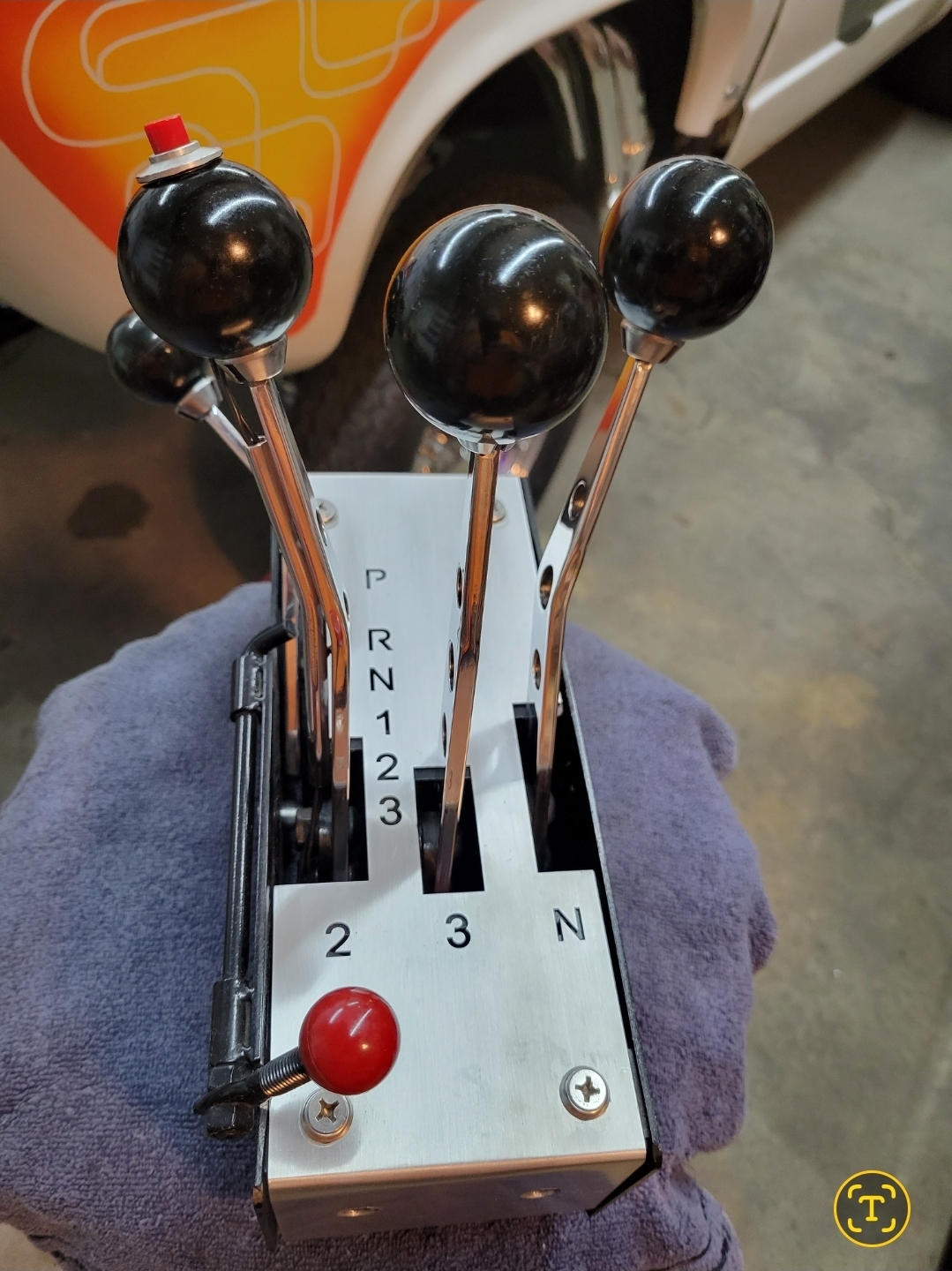

    My Kilduff has a pretty simple reverse lockout, the red knob.
    Screenshot_20251003_223924_Gallery.jpg Screenshot_20251003_223935_Gallery.jpg Screenshot_20251003_224012_Gallery.jpg

    I have that shifter in my 41 with a full manual reverse th400, you wont find a more heavy duty built shifter that's for sure. There's a video showing him hitting his ratcheting shifter with a baseball bat and it only moving one gear at a time.
    He has some great ideas on how a shifter should work and several videos showing them.
    https://youtube.com/@briankilduff?si=1cCtKO_44oZ4MHox
    As far as my shifter goes, there's a round bar with fingers that selects the gear, it's pretty interesting how it works. The shifter on the left is park, reverse, neutral, first and second for sure but maybe 3rd too. I just put that one in 1st, 2nd stick to the right is 2nd gear, pull it down and it goes to 2nd, push it up and it goes back to 1st as well as the shifter on left moves back to 1st. Next stick to right is for 3rd, works the same, pull down for 3rd, push it back up and it goes back to second, 2nd stick stays down in 2nd position but shifter on left moves up to second.
    The stick on far right is for neutral, it moves down as soon as you p*** neutral with the shifter on far left and stays down while in 1st 2nd 3rd. So if you're in 3rd and want to go to neutral you push it up and somehow it byp***es 2nd and first and goes to neutral moving the 2nd and 3rd sticks to the up position as well as moving the left shifter to neutral.
    So effectively while driving forward I only use the 2nd and 3rd sticks, since second is also first in the up position.
    It's definitely fool proof
