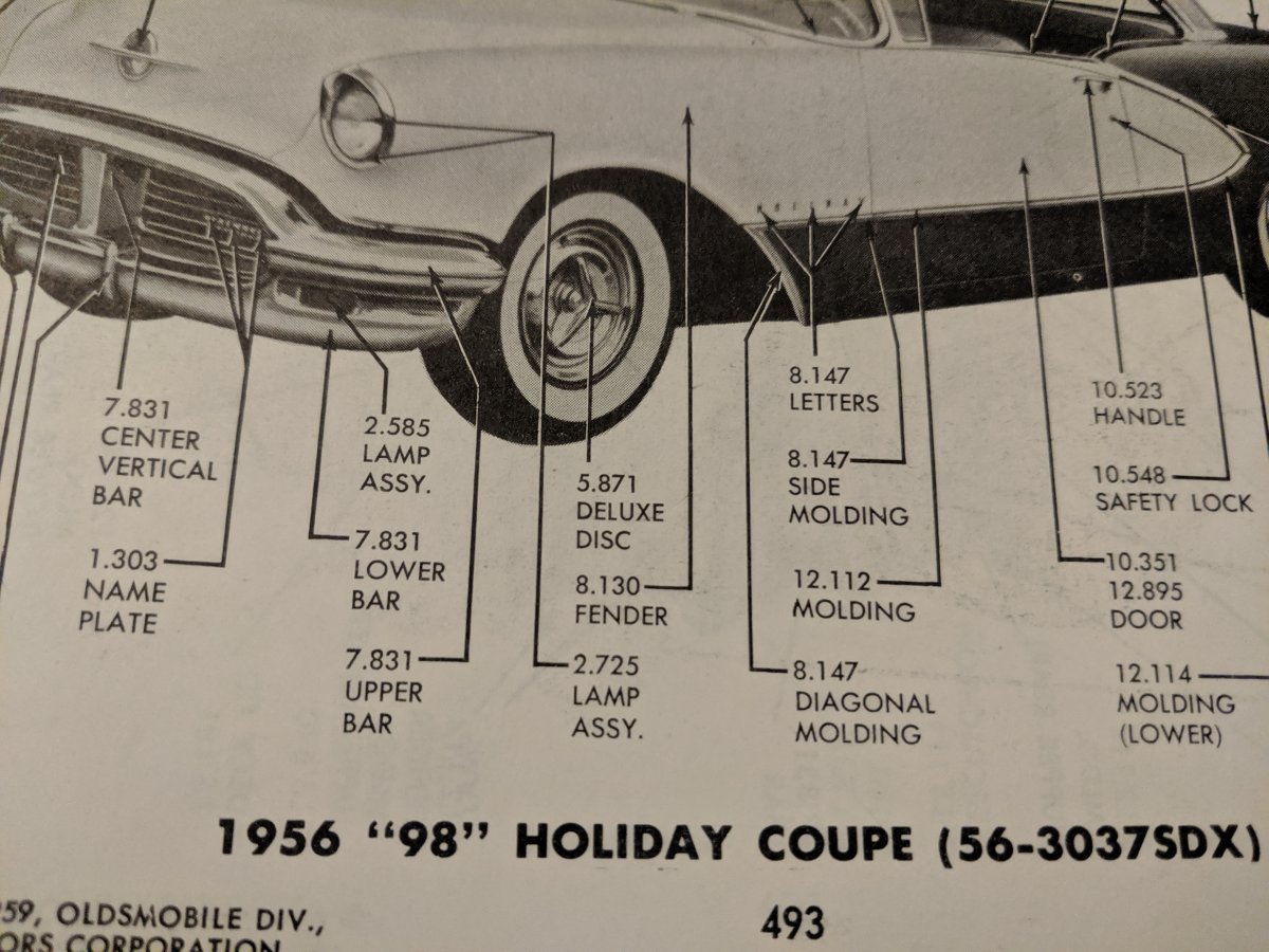

    A little side note from an old guy. The Olds spinner caps that were always called Fiestas were the 53-55 caps with the white rings, the 56 spinner were called Starfires. It probably varied in different parts of the country but that was what they were called in this part of Ohio. My 2 cents, now on with the more important stuff:)

    My parts catalog calls them "deluxe disc" or "deluxe spinner type" no mention of body style or trim package for the '56 model year.
