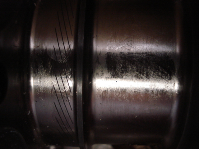

    Anyone have a pic of a "knurled" crankshaft ?

    The knurl pushes oil back into the engine. Turn it the other way, and it pushes oil out of the engine.
  13. Marty Strode
    Joined: Apr 28, 2011
    Posts: 9,718
    Marty Strode
    66 Shorty and gimpyshotrods like this.
