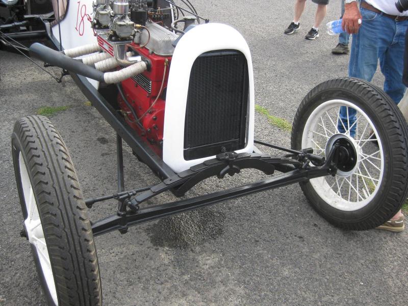

    So I did not think it through haha,
    I will have to manufacture an other front crossmember. Was thinking about doing it like this.

  7. rusty valley
    Joined: Oct 25, 2014
    Posts: 4,373
    rusty valley
    the photo you show they have a stock cross member about 6" back for a motor mount. you can see the side of it. this method was used for sure, but you see it will limit the axle travel, and change drive line length.

  9. rusty valley
    Posts: 4,373
    rusty valley
    looking again, i see the rear has been Z'd, so my guess is they flipped the frame upside down and reatatched the Z'd rear, then add a second T front cross member for the motor mount, shorten drive shaft and torque tube , stand back and smile at your new ch***is!

  11. modelAsteve
    Joined: Jan 9, 2009
    Posts: 382
    modelAsteve
    In Mamel's picture of the white T the front cross member is upside down and has been changes from the stock location on the frame. To just turn the frame up side down a new spring would have to be built with a very high arch. That is an A/ B motor and if you use a B motor mount it is wide enough to almost just bolt to the frame. Must pay attention to engine height and angle and also torque angle. Don't want the torque tube running down hill! Most of the cars were just about level (maybe a "rubber rake) and not as low as we like to see them today. A quick change will lower the rear of the torque tube about 4 '' allowing the car to be built lower. Good luck!

  13. alchemy
    Joined: Sep 27, 2002
    Posts: 22,828
    alchemy
    Your pic looks like a T crossmember, but it has been narrowed along with the frame. And not a lot of clearance between the frame and axle now. Looks cool, but probably a very rough ride. Dirt tracks aren't smooth.

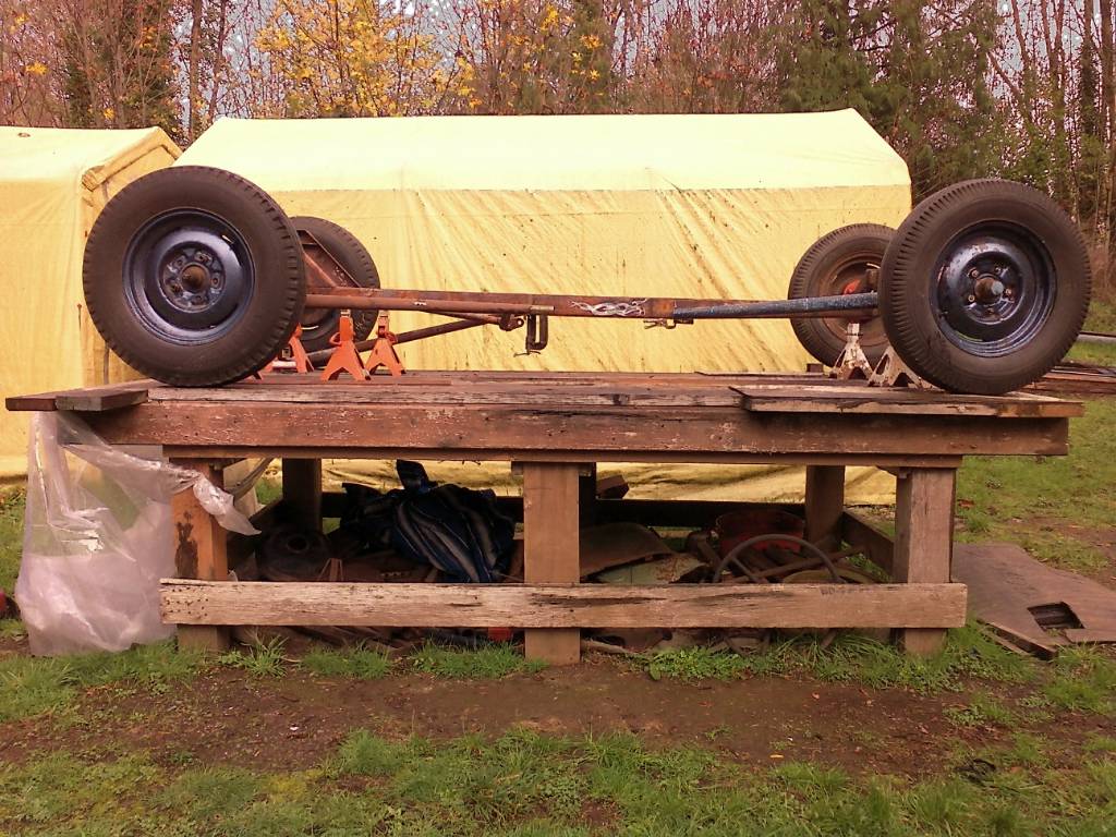

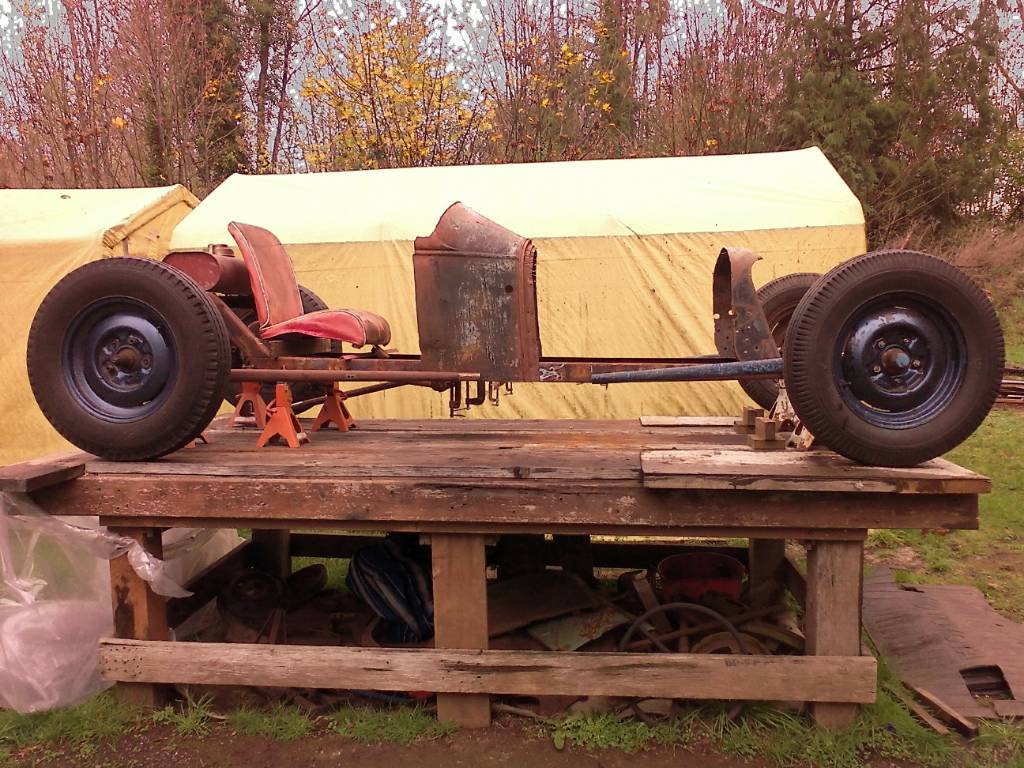

    I flipped my front cross member and stepped the frame 9" in the rear I used part of another T frame for the step piece and did the front axle suicide style, the tie rod will be behind, it gives me a 105" wheel base....the frame and springs are T and the front and rear axles are A it will be Volvo powered.........[​IMG]

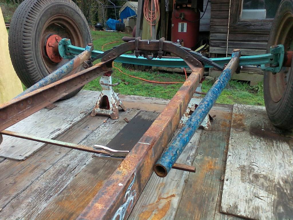

    Thanks alot! I did not know what year frame this T was. I looked like this was already some kind of the speedster in the past. Found this handbrake support on the left side.

    That looks very nice with the early twin U bolt mount rudestude!

    looks great! how much spring travel does the axle have with this set up?
    rudestude likes this.

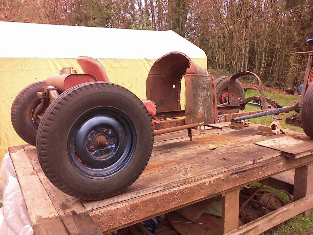

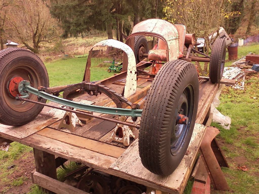

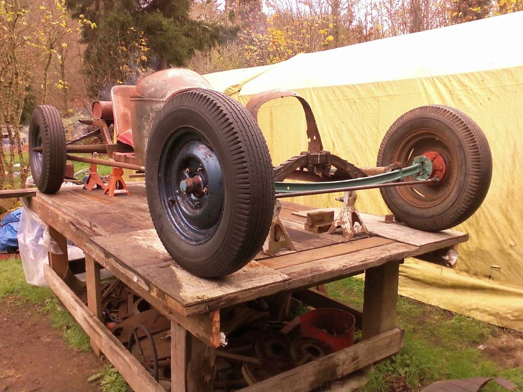

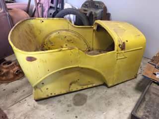

    Okay, so I am building a speedster with this model T frame but with A Running gear.
    It doesn't have to be really low, I just like the look with the reversed front crossmember but still have to see how low I can het the back with out cutting into the frame.
    I have seen a couple of pictures where they rotated the rear end outside castings but could see much in detail how they did it. Is there maybe a thread on here?
    But then I have to shorten the driveshaft some more..
    Also looking for some tips how to do tackle this haha.
    This is the body that would go on this T frame.
