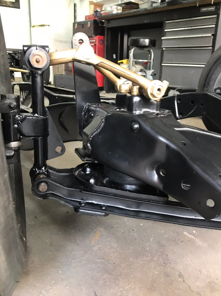

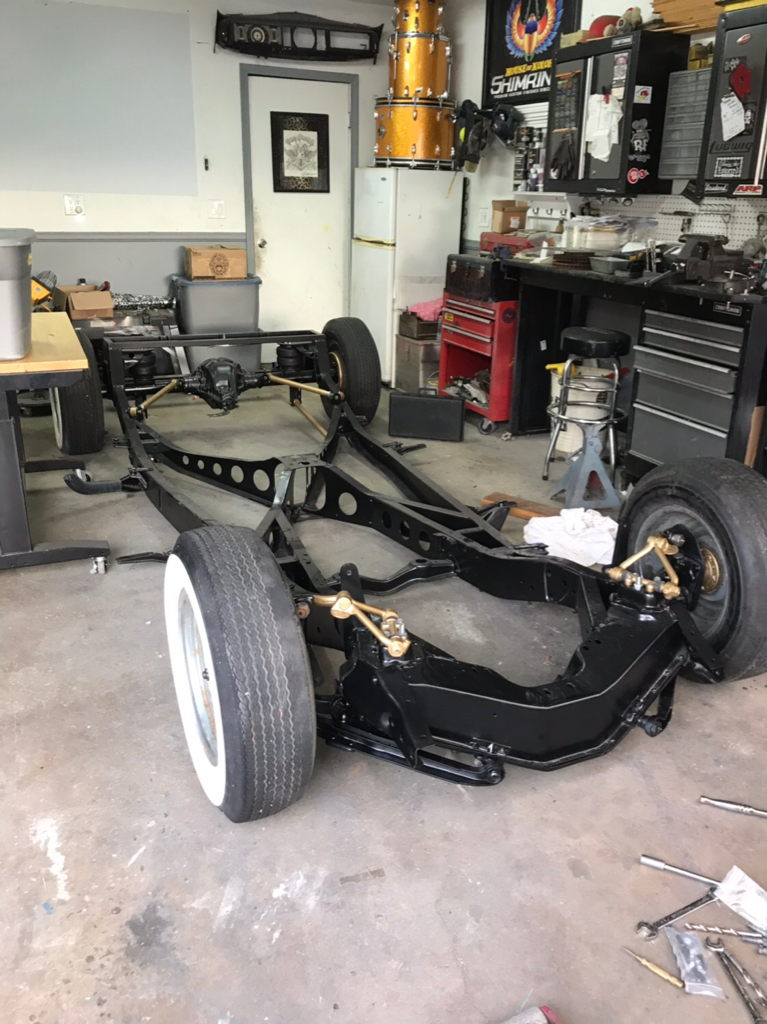

    Im getting back into my front end project on my 1940 desoto. OldDaddy, I might be emailing you for some help on modifying he steering arms.
    Im using a fatman dropped upright, scarebird disk brake conversion and installing airbags.
    for airbags Im using the stock lower control arm, just welding a plate to mount the airbag too.

    [​IMG][​IMG][​IMG]
