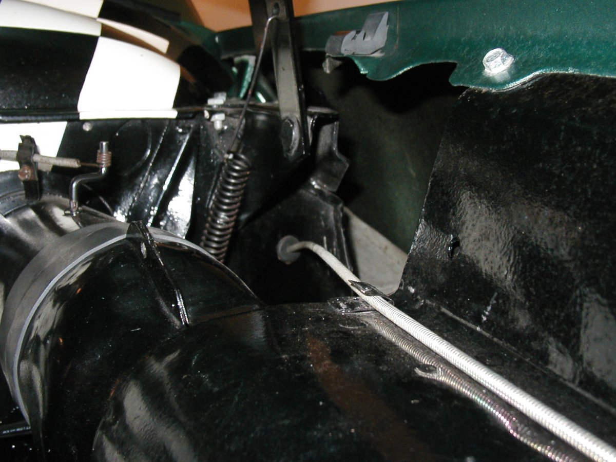

  4. Buddy Palumbo
    Joined: Mar 30, 2008
    Posts: 3,871
    Buddy Palumbo
    That spring doesn't appear to be correct. There should be a spring that has a long wire on one end , reaching from that little stud down to the flat panel below the hinge area (there is a hole in it, iirc) . I'm missing my springs and it catches like hell on the body as well. The 4 hood hinge bolts on a 49 are eccentric as well to help correct that stuff also. Mine made marginal results ...

  10. Kiwi 4d
    Joined: Sep 16, 2006
    Posts: 3,882
    Kiwi 4d
    The lower hole is a small slot near the firewall in the horizontal inner fender panel below the air duct. We don't have the springs but it works ok. We did have to remove the hood brace that the hinges attach to and move it forward to improve the fit to cowl line, not perfect gap but ok.

  19. Kiwi 4d
    Posts: 3,882
    Kiwi 4d
    The spring goes from the stud on the hinge thru the large hole in the hinge plate to the slot below.

  20. '49 Ford Coupe
    Joined: May 19, 2011
    Posts: 1,351
    '49 Ford Coupe
    THANKS for the guidance on the spring, etc.... Only thing is.... there doesn't seem to be any slot anywhere in the vicinity of the other end of the spring when the top hook is on the stud.
    Can ANYBODY post a picture of the correct install ?????????????? Showing whether the "two screw" tab is supposed to be on the top or the bottom of the firewall lip ??

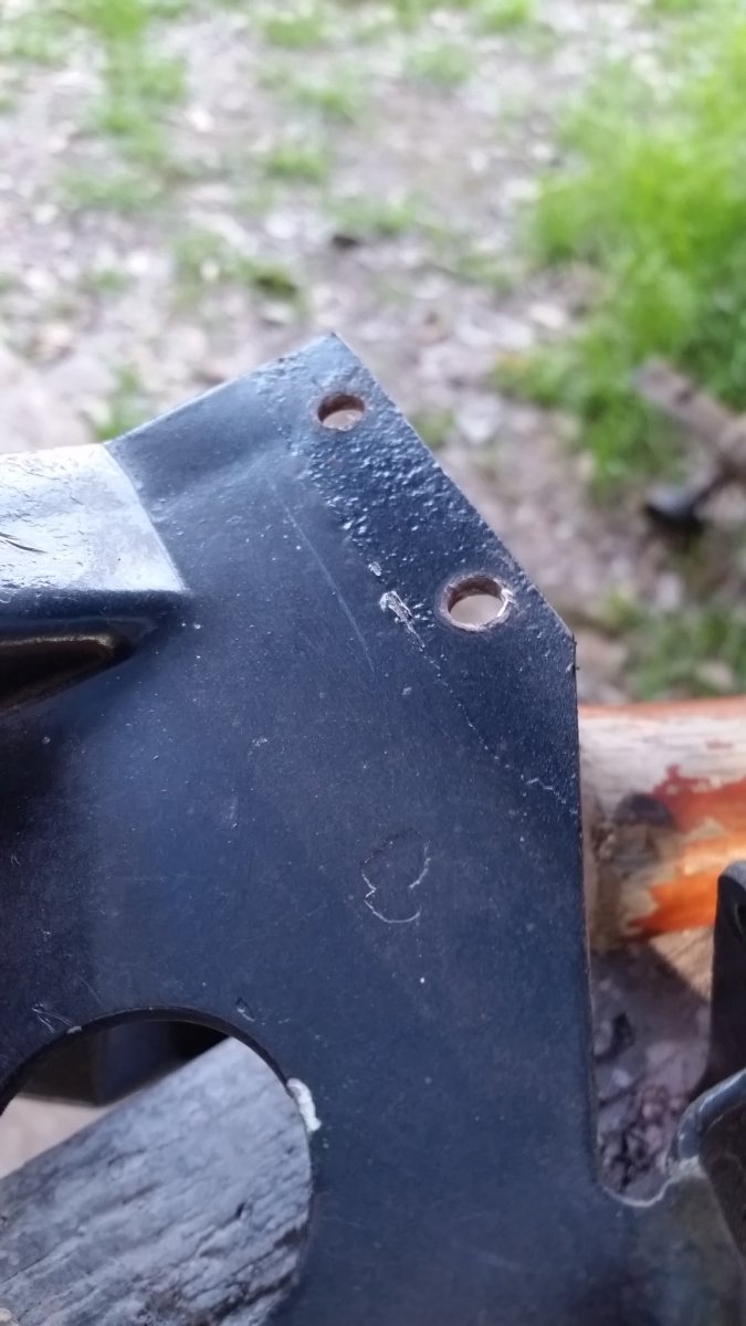

  30. '49 Ford Coupe
    Posts: 1,351
    '49 Ford Coupe
    Guys........sorry to bring this up again....but........I just removed one side of my hinges, and it apparent that the hinge was first mounted at the factory with the rear tab on the BOTTOM of the firewall lip (see picture attached). Channel49 was kind enough to post a picture of his hinge mount, and it's mounted with the tab on the TOP of the firewall lip. In addition, when I try to position the hinge on the top of the lip, I get interference between the part of the bracket that bolts to the firewall vertical surface, so it doesn't "want" to be placed there.
    I wouldn't otherwise bother ya'll, but as you may realize, when a guy is working alone, it's a reeeeal pain in the arsh to remove/reinstall hood hinges by one's self.. And if it comes out wrong, I'll have to do it all over again...
    So... how about this... can anyone else confirm which side (top or bottom of the firewall lip) their hinge is mounted on?? Only because maybe one of the prior owners of Channel49's car may have remounted the hinge in the wrong position. Thanks in advance, guys........
