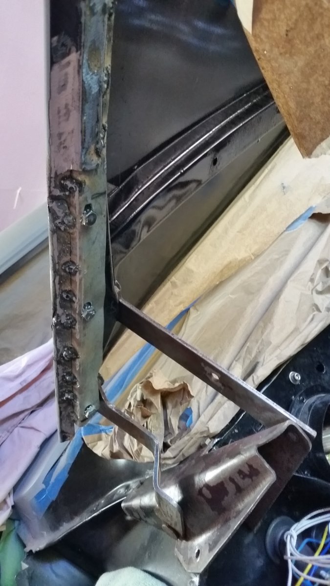

    Well girls and boys, I believe I found the culprit...........bent hood... AND the step in the mounting flange.... so I have TWO problems......When I bought the car, the hood hinge bracket was missing, so I never saw the hood "on" the car, except for just sitting where is was supposed to be without the hinges mounted..didn't notice the curvature... check it out....oh yeah, when I tried to set the fender, it wouldn't mount because all those washers I put under the hinge mount raised one of the arms up so far that it hits on the fender.....sooooo...2x4 and rubber hammer time, I guess...damned hood looks bent in this pic...never noticed...gettin' old, I guess..and will look into taking that step out of that mounting flange...Thanks Wizzzzz... I may never have noticed that difference..

    Today I'll be making a "supplemental " lip for mounting the hood hinge bracket and cutting out the original lip on the hood. Yesterday I cut a template from a 1x6 to match the curvature of the edge of the fender to get the hood fixed. 20160419_130249.jpg

    With the template made and clamped to the edge of the hood, I made a couple of new channels to weld in place of the old flimsy mounting area of the hood, and it's 1/4" closer to the top surface of the hood..

    Pretty dang good! Thanks to the Wizz for helping figure out what the heck was wrong with this configuration. Trial fit indicates only two issues. Drivers side adjustment needs to shift the hood forward about another 1/8 inch and the rubber spacer / seal at the top of the firewall has to be in place. That little gasket holds the hood above the firewall about 3/16" and helps keep the back edge of the Hood from hitting the firewall .It also appears that it would be important to put multi layers of 3M double-sided red / Grey sticky tape on top of the hood hinge bracket. Ford had a piece of tar paper stapled to the bracket to minimize rattling and to help shape the top of the hood. So overall I'm very very pleased with the way it has turned out. Today I'll be doing some grinding and some other repairs to smooth things up for paint. If your hood is flimsy and out of shape near the rear it's easy to make a template off of the edge of the fender then clamped firmly to the edge of the hood to shape it. After shaping one side of the hood then you take those little blocks off of the template and screw them to the opposite side to give you a good position on the other side of the hood. 20160423_174939.jpg 20160423_175004.jpg
