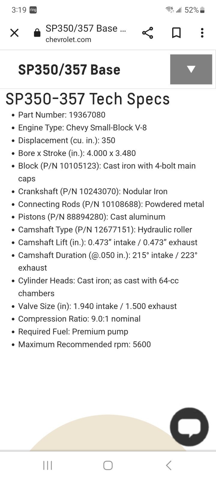

    Just thinking about something @carbking mentioned earlier. Jon it seems like my rich cruise is likely from being in the idle transfer slots even around 2,000 RPMs correct? If I go smaller on the idle pickups the idle goes too lean to run. You mentioned the byp*** holes in the throttle plates earlier. Would those effectively keep me out of the transfer slots more at cruise or am I way past the slots at that point anyway? I was under the impression these holes were only necessary if the idle screws made no change to the idle mixture. I'm not sure I fully understand the IAB's but would opening those lean the mixture in that 2000ish RPM cruise range?

    @carbking thanks for the clarification on RPM ranges....I couldn't find that info anywhere. As for checking the 2nd link in your signature it could be the fact that I worked 24 hrs yesterday or the fact that I slept 4 hours this morning after but I see no links. I've read through your website several times now however.
    I've seen just about everyone state when running tripower the IFRs should be opened up however my truck seems to have the best cruise AFR when they're stock or close to it. Once the throttle is past the transition slots the idle circuit continues to add fuel right? Or does it lose the vacuum signal and essentially shut itself off? I guess based off your post I'm to look at my main jets still if I'm trying to lean my cruise out more as long as I don't go lean anywhere else in the RPM range before the end carbs open? I do have a set of 56 jets coming after the weekend and I can pretty much swap them with my eyes closed at this point in 10 minutes time so I'll see what happens.
    Any thoughts on the end carbs seeming to want jetting substantially higher than the center on WOT? Different venturi sizes?
