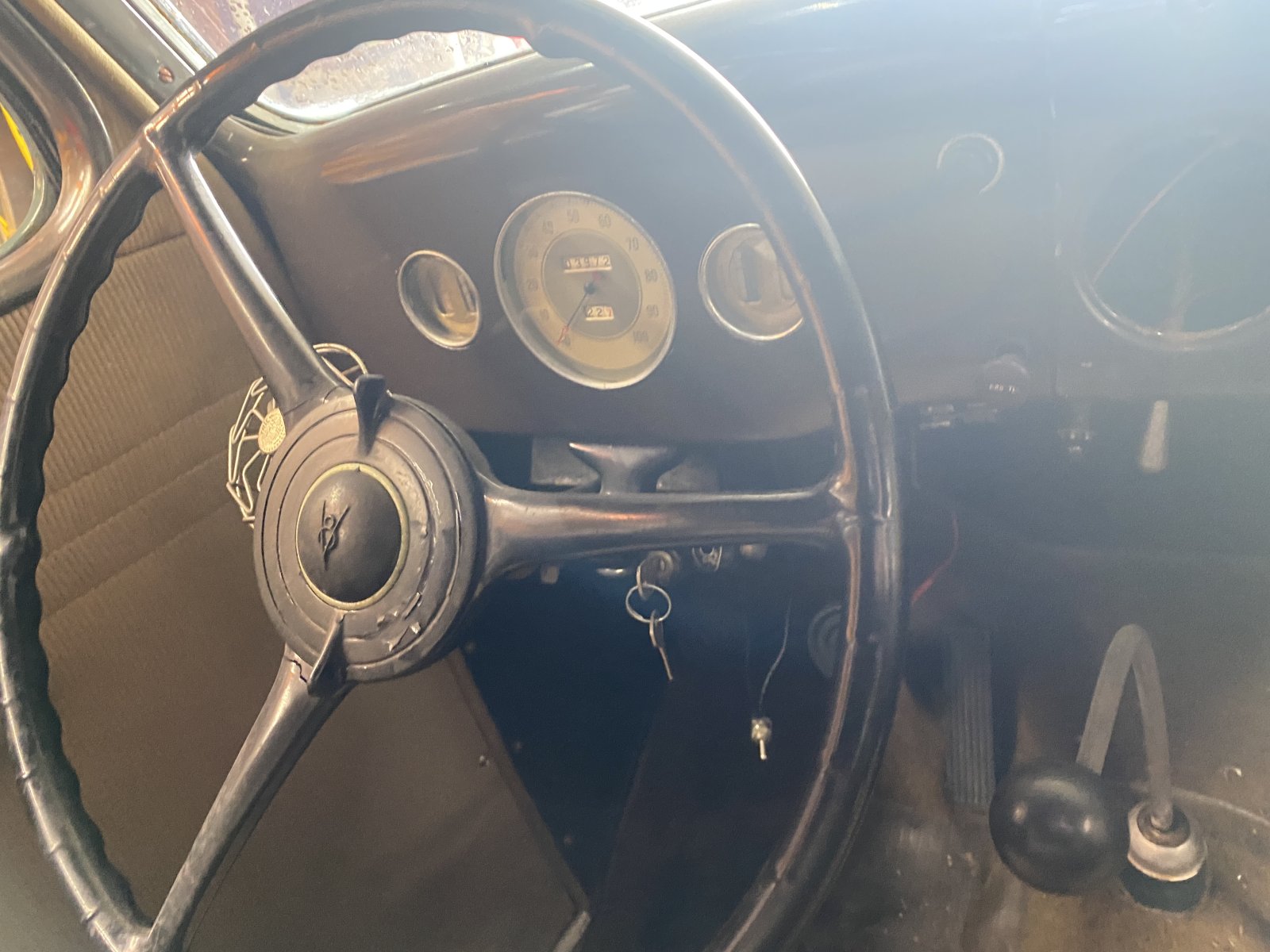

    I am a technician and own a 35’ ford. Long time reader of the HAMB.
    Pics of my 35’ attached.

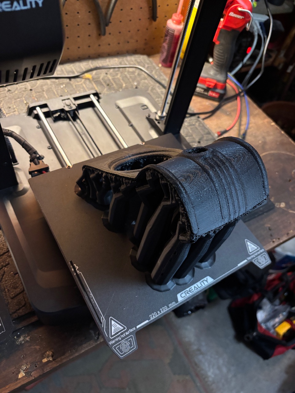

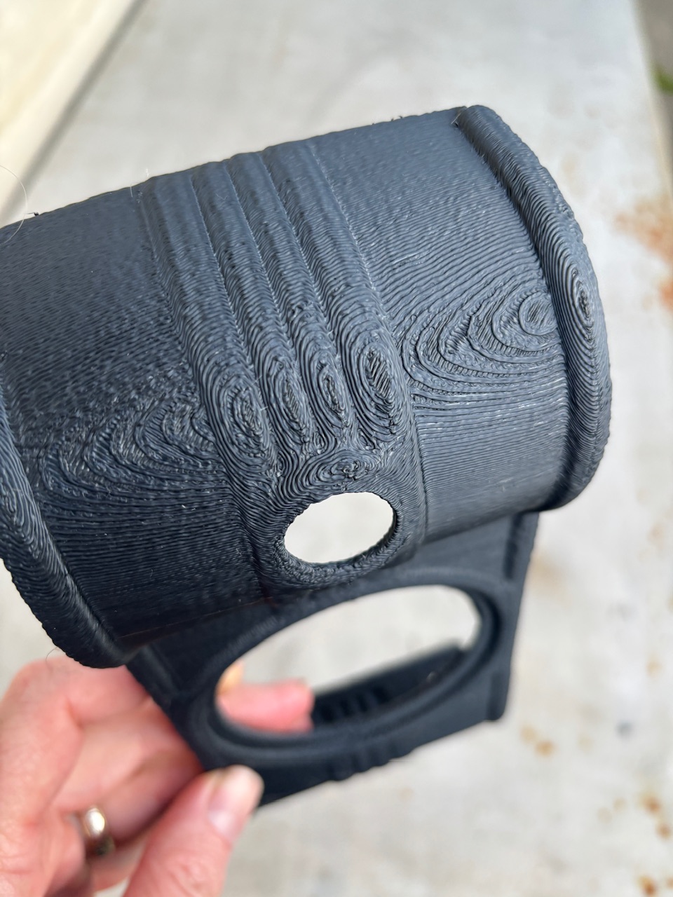

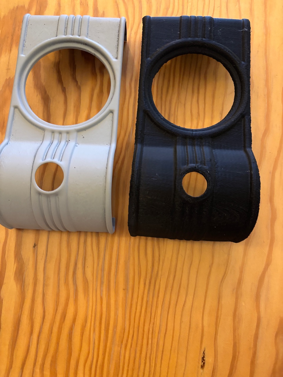

    First print done. Original ford part is primer color 3d print is black. It seems like this will yield a usable waterfall dash eventually. This first print has a very rough finish. It looks like driftwood. I’m going to try other setting on the printer. Unfortunately the item is too big to lay flat on the printer bed so the printer makes a large tree support of very thin plastic to support the print. I’ll continue experimenting and make a better quality model after tweaking the parent file a bit.

  20. Casual 6
    Joined: May 25, 2008
    Posts: 308
    Casual 6
    from Great NW
    What material are you printing with?
  21. Nick35’
    Joined: Jun 11, 2024
    Posts: 11
    Nick35’
    I’m using pla to test the shape then intend to send the file to be printed at a professional 3d print shop out of a more appropriate material- some good quality plastic, I’m not sure what type exactly.
