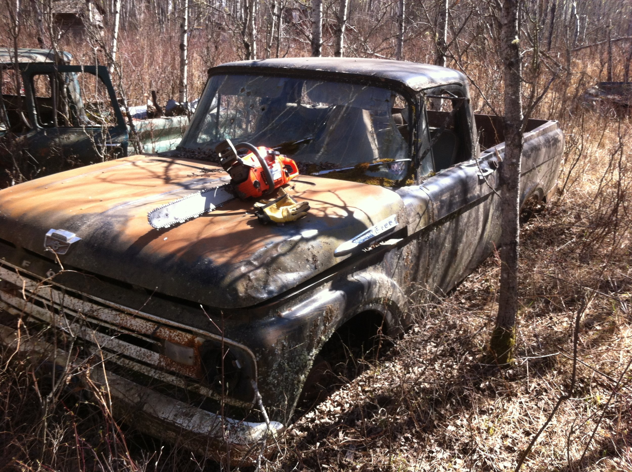

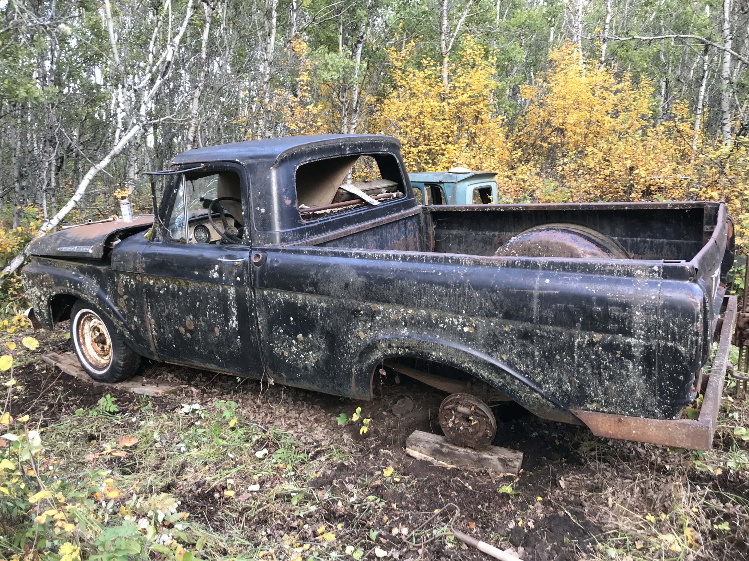

    Guess we all have our own definition of rough IMG_0523.jpeg IMG_0565.jpeg what I brung home

    Bed looks nice on that. Like the rear bumper.
    Looks like a lot of Birch trees there... reminds me of WVa.
