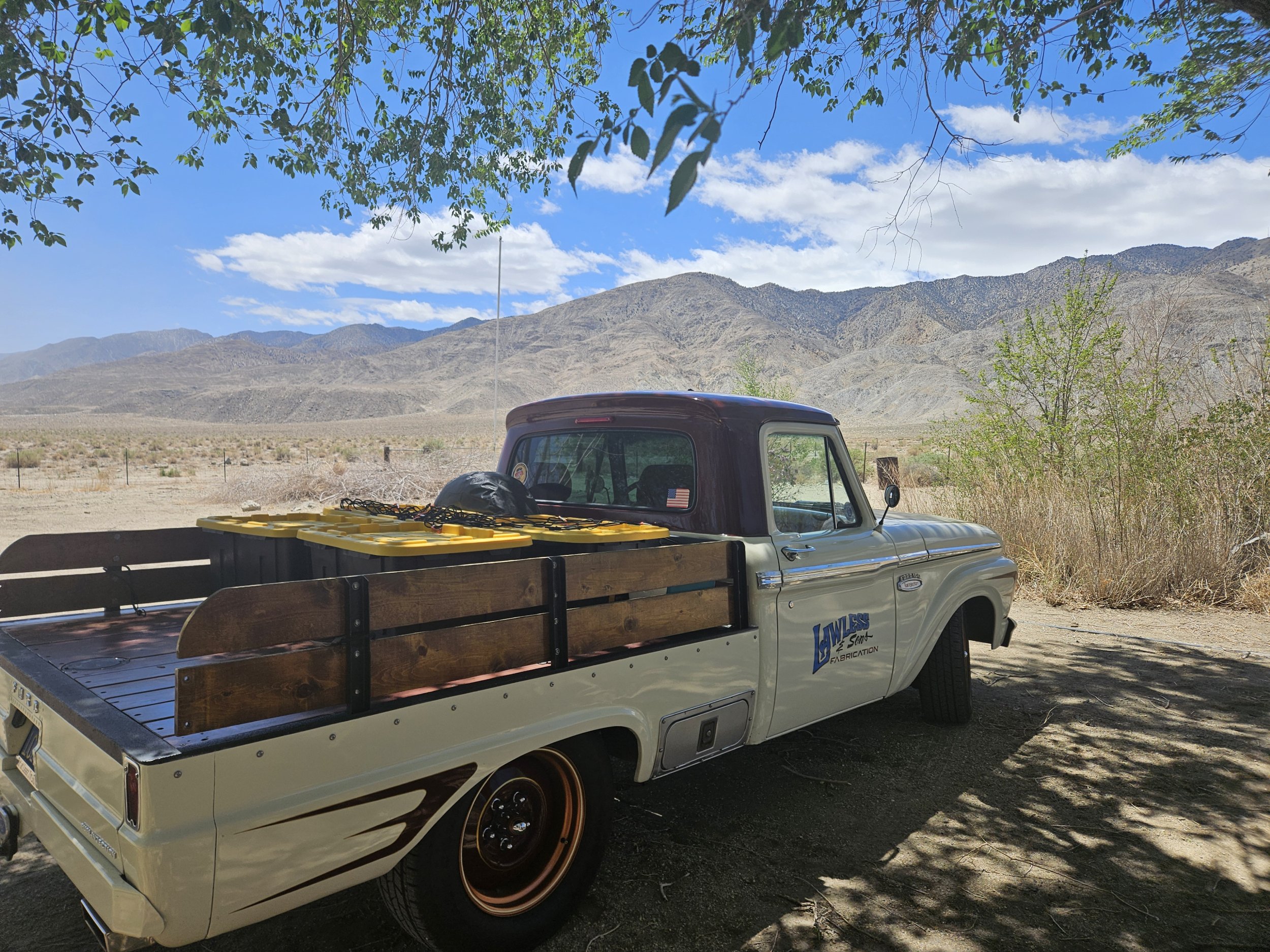

    Pretty good start. Bucket seats were a "Ranger" option. I think I've read somewhere that they were Falcon seats.
    Gene Koning mentioned that a member here was in the middle of a 3000 mile road trip. That was me in "Ol' Furd." My 1965 F100.
    We ended up going 3500 miles, with minimal issues, and none that required roadside repairs. When I got my truck the mechanicals were in far worse shape than yours. I hadn't run or been registered for 20 years. I didn't dink around with anything. I stripped it down to a bare cab and chassis and renovated every aspect.
    I agree with the others. Get it running and driving, fix issues as they pop up, and do what you have to with the bed.

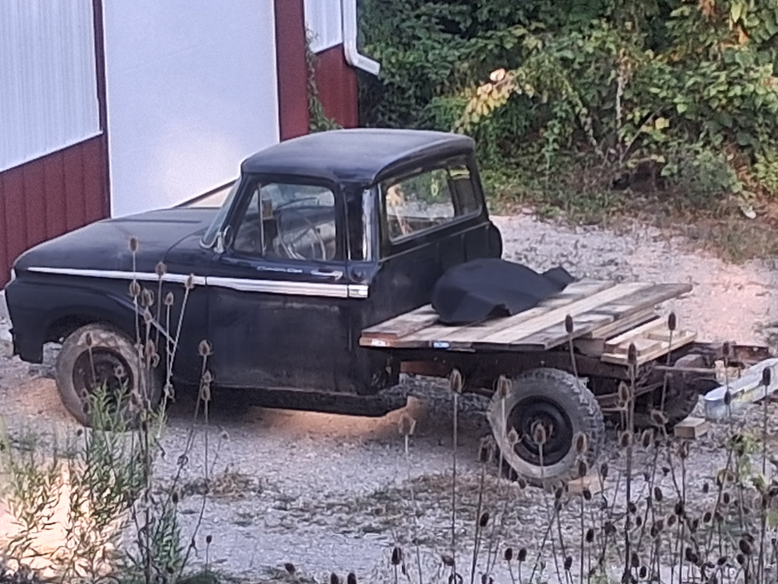

    While mine did have a bed, it had sat for many years with debris....wet debris. Rotted the floor, int inner sidewalls and the top rails. I used the outer bed sides, and built a flatbed to use those because I liked the look of those. Picture below for.....well.....just because! In western Nevada, just east of the White mountains. A-LisasBackyardDyer.jpg

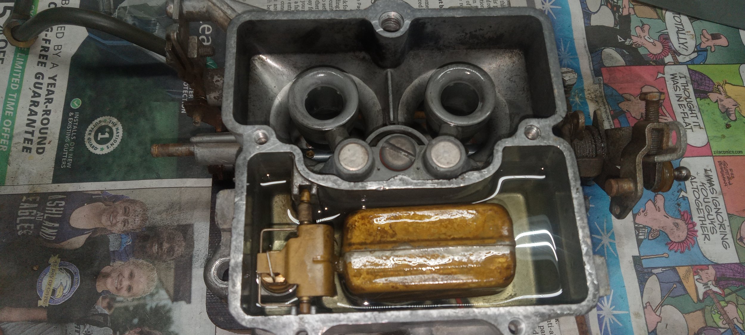

    Holds water.... need a cap. Have the windshield squirter kit on truck.

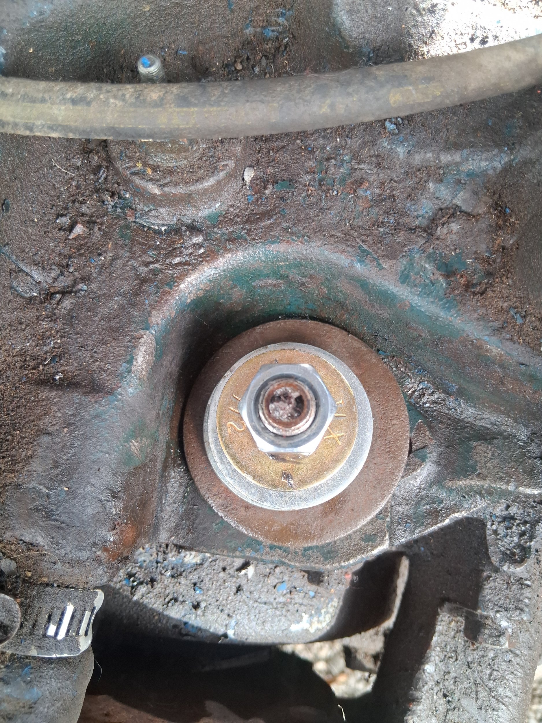

    Got 4 distributors kicking around all have pipe wrench marks on em, Fords are bad for seizing in the block, once you get it to turn with the wrench it’s still a******** to get to move upward. I use a couple dowels to pry up while turning with the wrench and lots of wd40

    Next will be trying to attach a slide hammer to this distributor shaft. Still soaking lower pilot bore with lubricants.

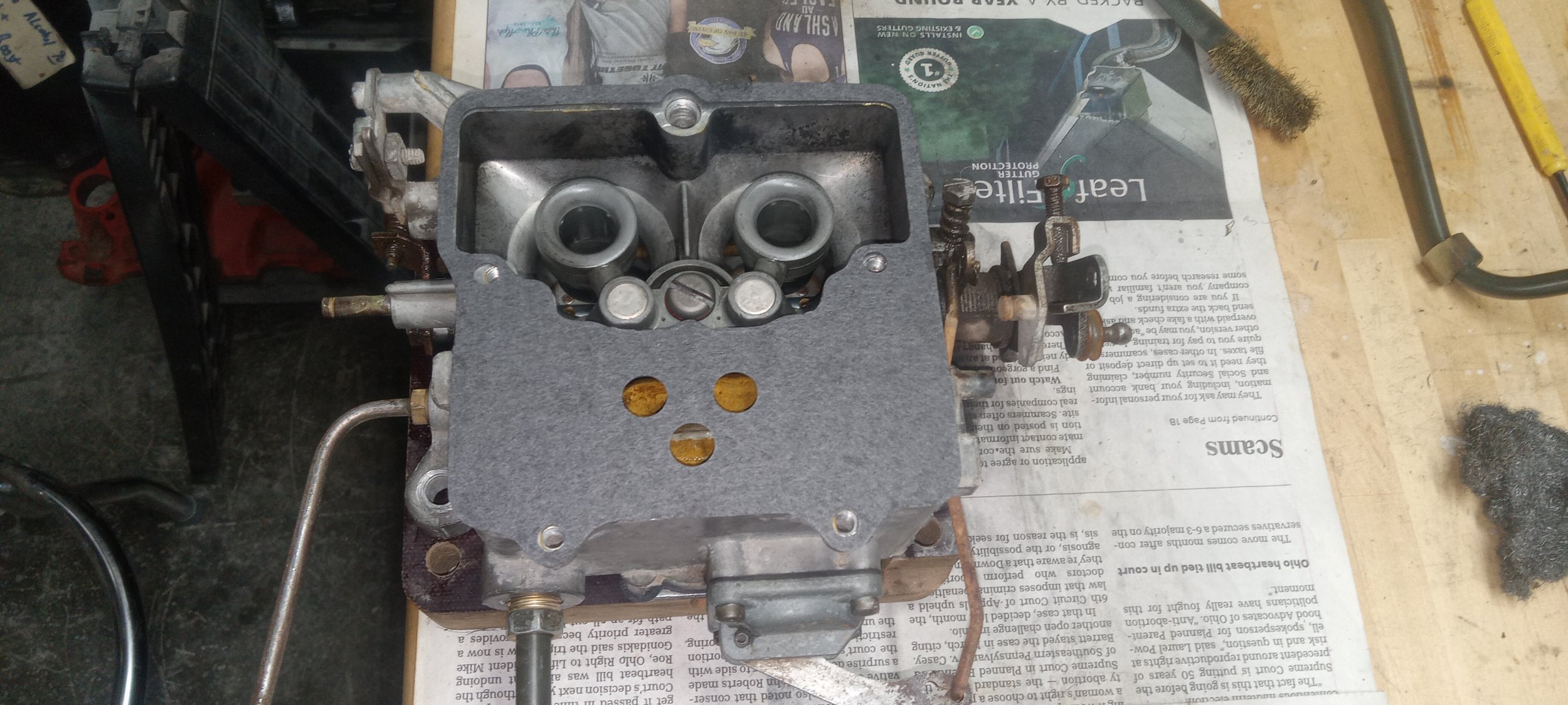

    Is that a early 2 barrel Holley Carb?
    Dustin
    (1Nimrod)

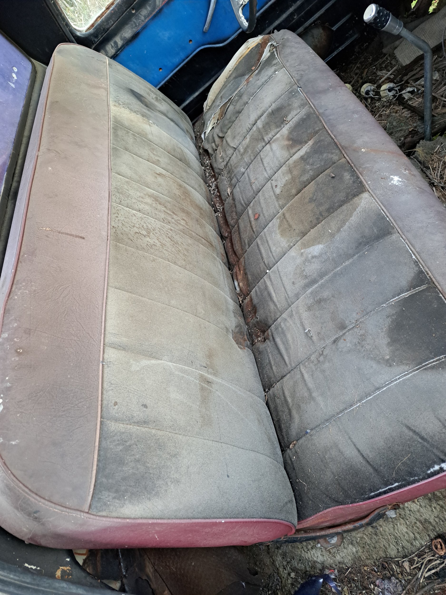

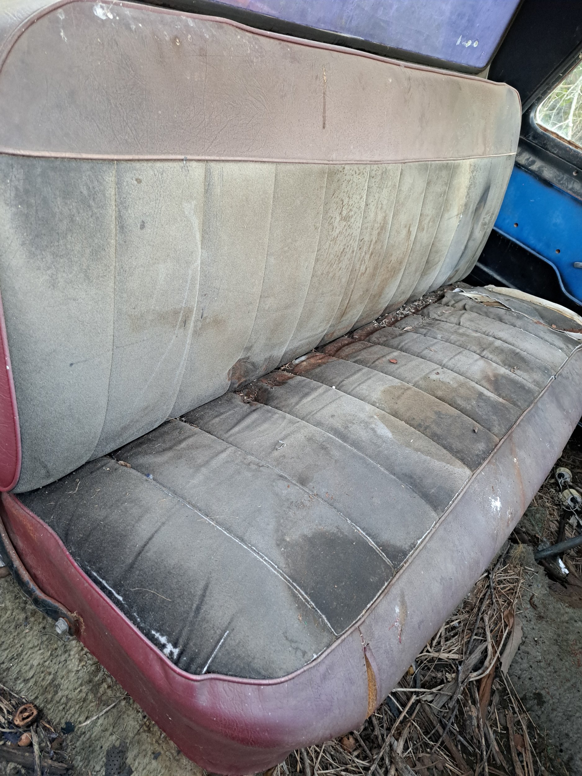

    Was your Bench Seat as bad as this one?
    This is my 2nd 63 C10 from Missouri, Im not looking forward to getting down & dirty inside her, I'm not 20 year's old anymore and the Rats, Mice & Red Squirrels have made a mess with droppings all over inside, on top of everything else the pervious owner put long ugly***** Carpet on the floor year's ago and its full of piss & droppings & with the broken side window leaking water in for many year's it has soaked the piss & droppings deeper into the Bench Seat &***** Carpet. Some hot warm days this week so this old man is diving in, 1st job 20220928_165425.jpg 20221008_182559.jpg 20221008_182608.jpg Beach Seat removal then I'll have to take a long break away from the Cab.
    Good Luck on your Custom Ford Pickup it's going to be a great looking Truck when your finished.

    Distributor Removal Phase 3.
    Tried 12mm die, little to tight starting, found 1/2-20 started perfect and cut nice with KROIL.
    Have about 40ft lbs on nut. See if I can persuade lower portion out of block. Giving it time.
  30. GlassThamesDoug
    Joined: May 25, 2008
    Posts: 1,950
    GlassThamesDoug
    Something moved, after about 8hrs of constant load, washers were loose. Added about 1/4in of additional washers. Re-applied 40ft lbs torque, see what it looks like in morning. :)
