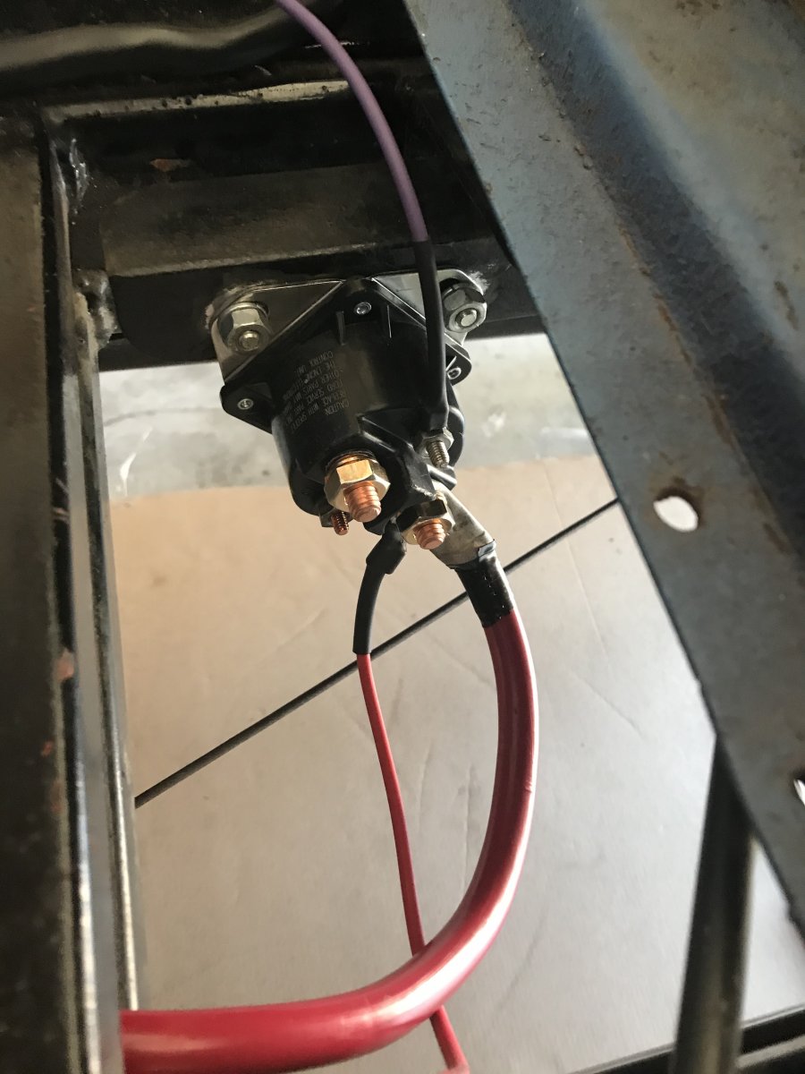

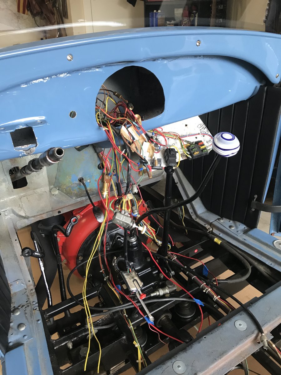

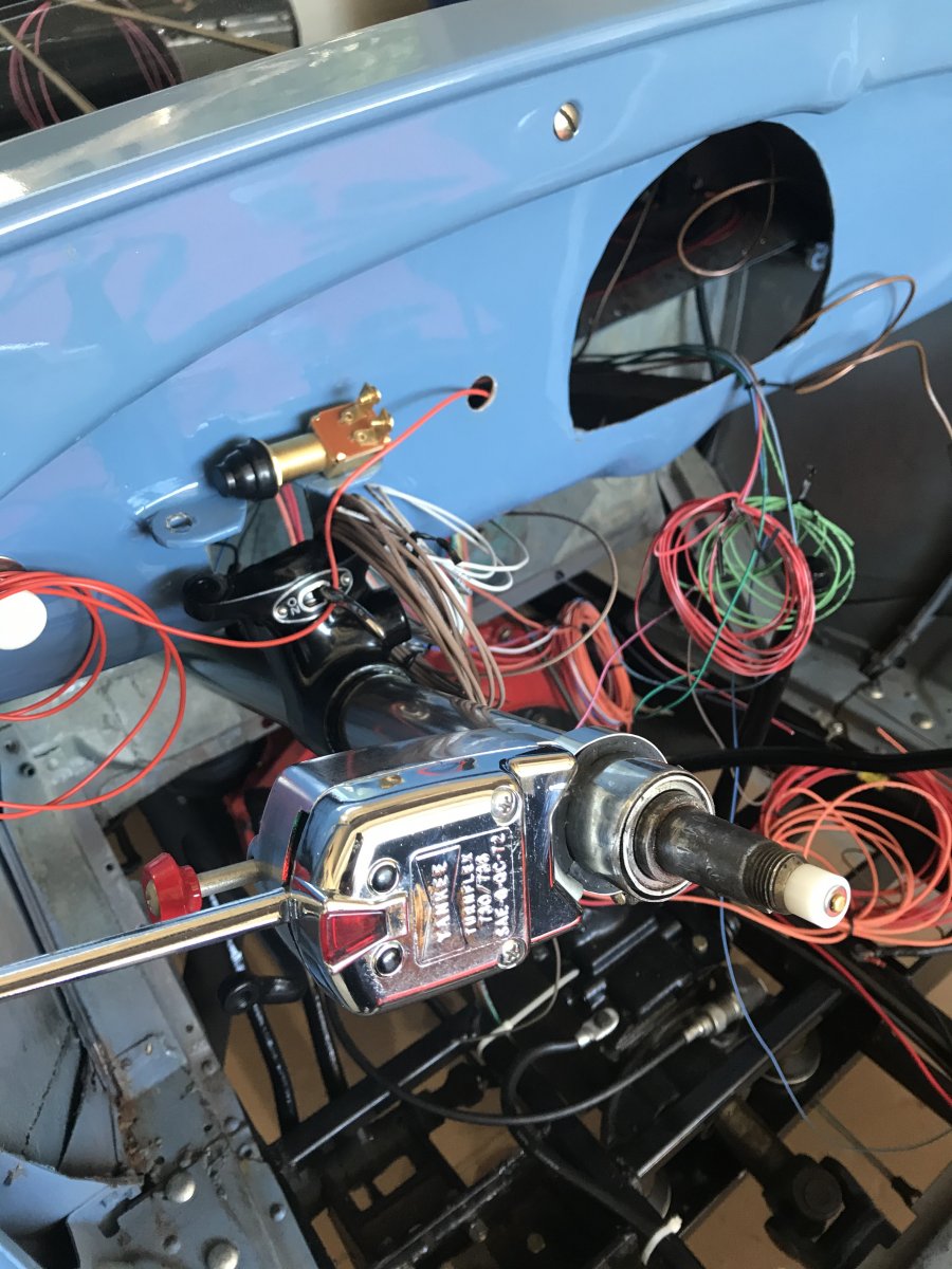

  21. BillyYuma
    Joined: Mar 18, 2020
    Posts: 6
    BillyYuma
    Thanks man, I highly appreciate that! Hope everything’s going well with the oil pump
  22. BillyYuma
    Posts: 6
    BillyYuma
    Nice!.. I wish I had a better picture of what was going on before; but the wiring was such a god awful rats nest my nose bled just from looking at it.. both of those terminals were wired to something before, I just didn’t know what.. installing the painless harness helped me understand a good bit more; I’ll be hitting the books hard after this one.. here it is puking up the old harness
