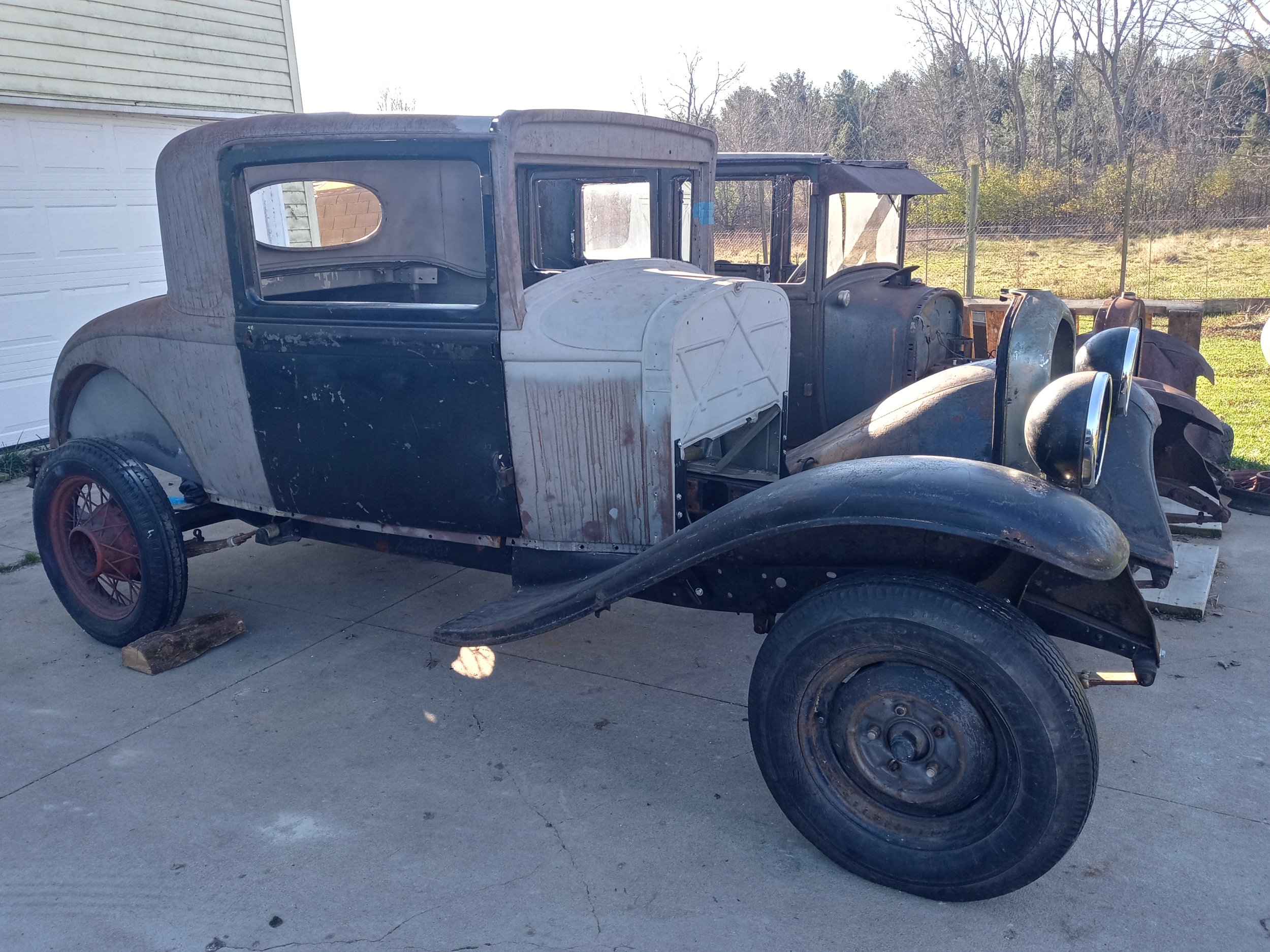

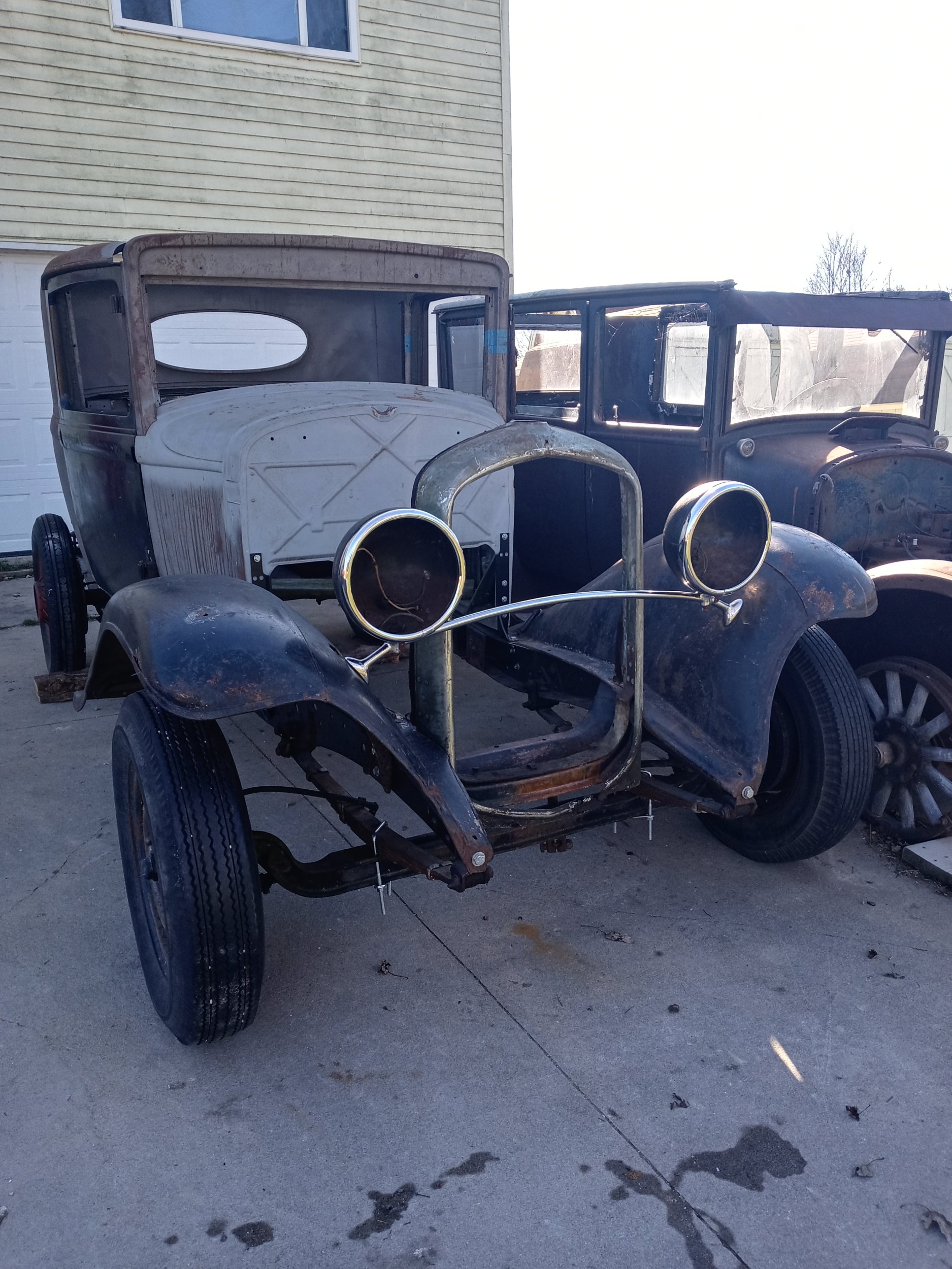

    I put the grill shell on there to see how much room I have for the 440 engine. Dang... it looks like I might not have to move the firewall.
    And I'm sorting through some parts.
    The previous owner p***ed a few years back and his son was selling the car and didn't have loads of interest in it and didn't always have answers for my questions. So it's up to me to figure out exactly what we have here.
    I have to give credit to the previous owner. Tom was his name. He did things that saved me some work. He dis***embled the car and had the body shell sandblasted and coated with some kind of rust inhibitor.
    But it also seems that he got a few parts chromed. The headlight bar. The headlight bezels, although they may be reproduction judging by the fit being off just the slightest. The radiator support rods. And what appears to be the hardware for the windshield. All chrome. Thanks, Tom.

    The chrome (or nickel) on the grill shell is in rough condition. But that's okay. The shell has a nice smooth rounded shape like the grill shell on a '32 Ford. So I think I'll prefer it to be painted body color anyway.

    Do you have the lens for the headlights and that headlight bar is nice! HRP
  18. Rickybop
    Joined: May 23, 2008
    Posts: 10,758
    Rickybop
    No headlight lenses, Danny.
    But of course I might likely mount a pair of Guide headlights on the original headlight bar.
    Stogy, porkshop, mad mikey and 3 others like this.

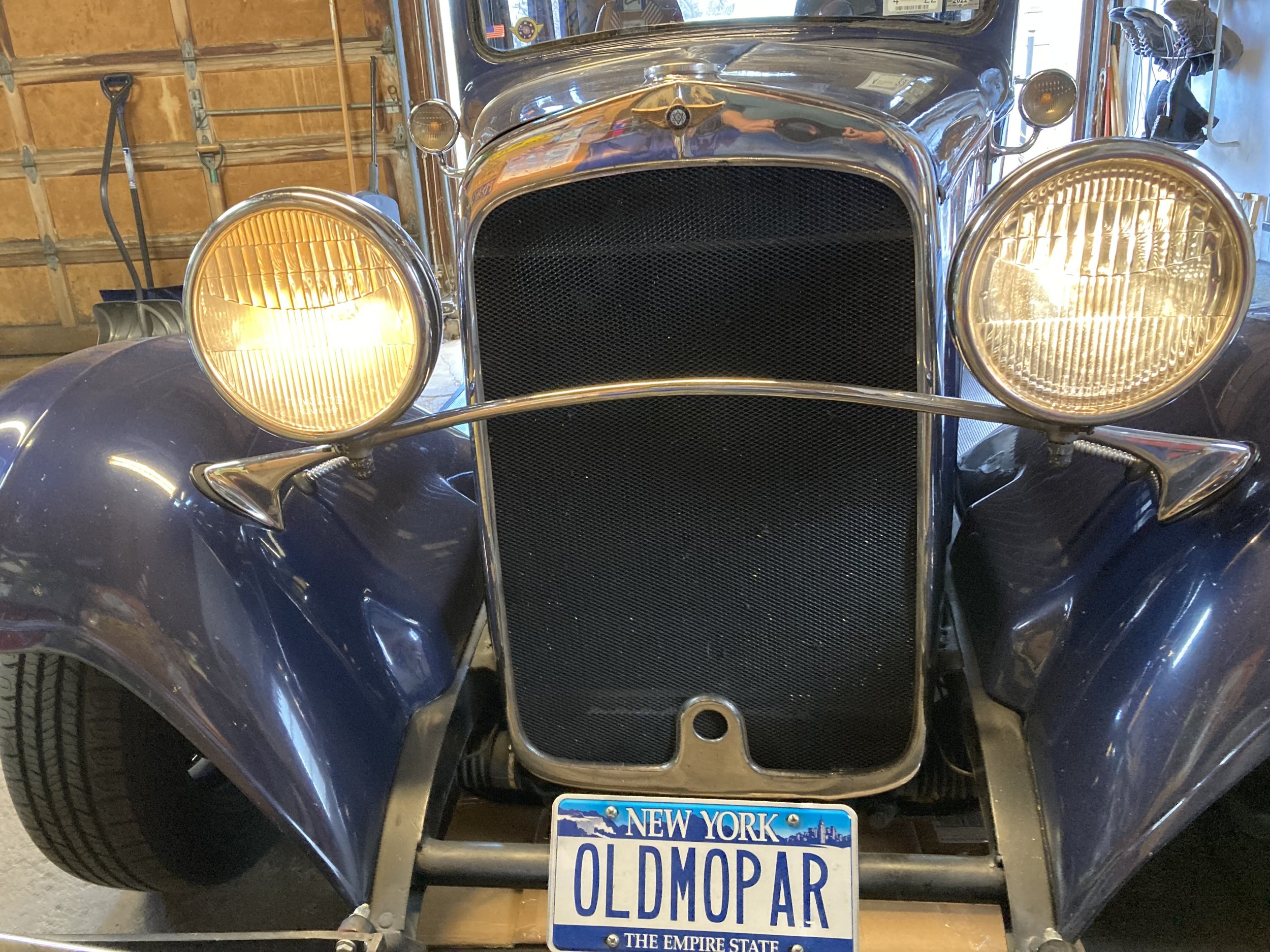

    Rick, take a measurement, I have a set of lens and know they are Ford but I will have to check for the size.
    I think the 30/31 Plymouth is 9 5/16" and the Model A are 8 1/2". HRP
    Stogy, porkshop, mad mikey and 2 others like this.
  22. Rickybop
    Posts: 10,758
    Rickybop
    @HOTRODPRIMER
    I measured the diameter. Looks like you're correct at 9 5/16
    What is the 8 1/2 measurement?
    Stogy and Tow Truck Tom like this.

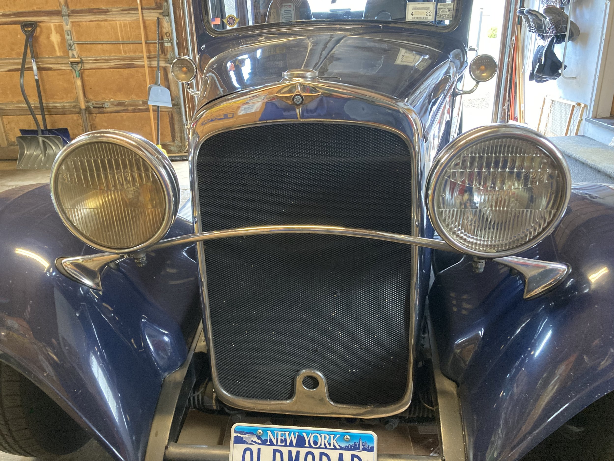

    IMG_0536.jpeg IMG_0535.jpeg IMG_0536.jpeg IMG_0535.jpeg I like the original large headlight look although some of the light visibility lost from modern bulbs. I had halogen bulbs but original reflectors not so good. I added a set of Macs halogen reflectors which fit the fords and with some t******* put them in my lights and made a huge difference . You can see differance between light that’s been done and originsl IMG_0536.jpeg IMG_0536.jpeg IMG_0535.jpeg
