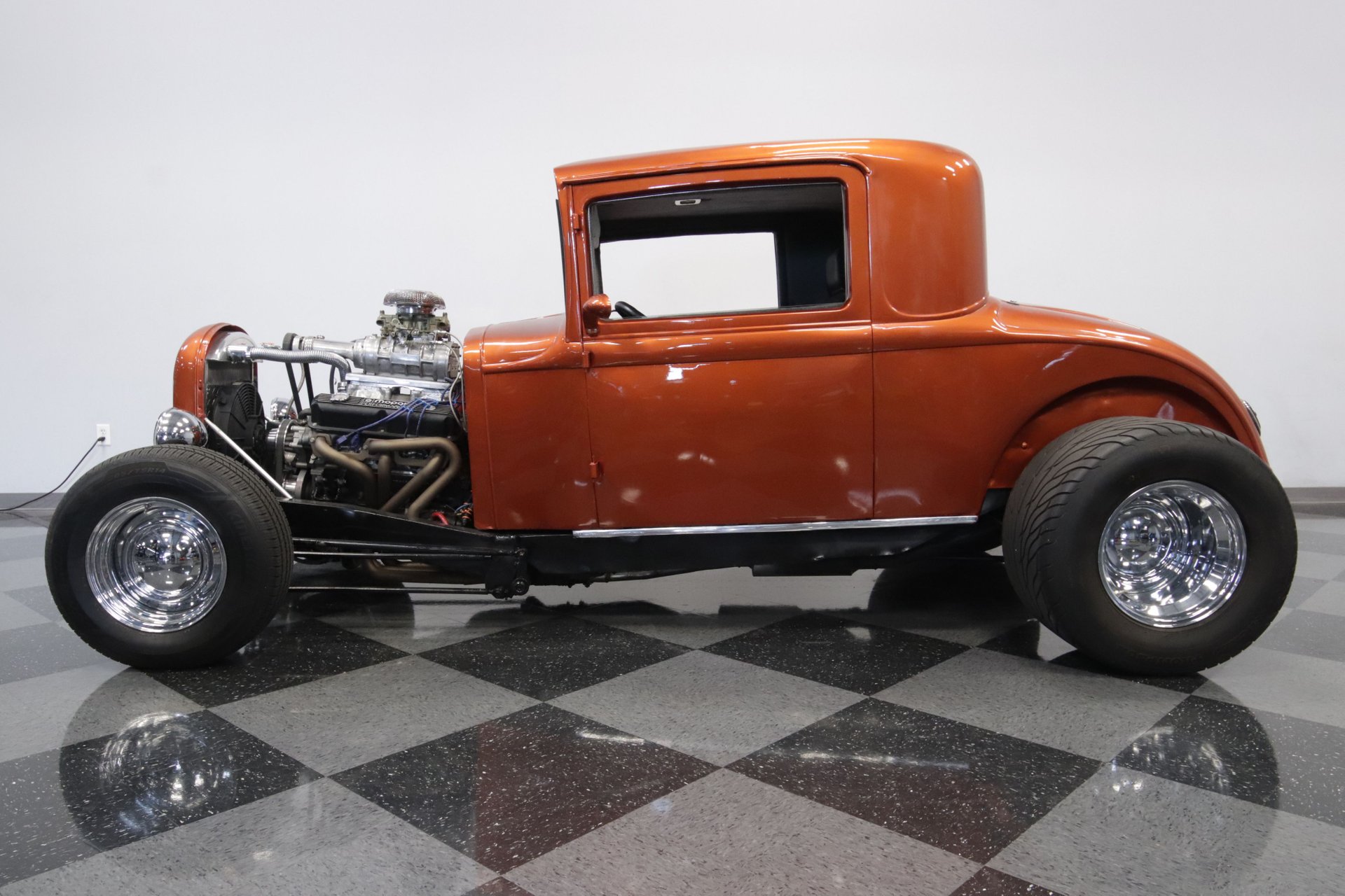

    Very nice coupe! FWIW: *If* you *have* to chop it, keep the rear window full size n cut it only 1", 1.5" max, hey maybe 1/2"(chopping *only* for if you can re-create the more stylized/factory-chopped-like-the-ads-look), just to schmooze the troops & make 'em wonder "what the ...???".
    Glad you're keeping the stock -type suspension - cutting the ford axle is a good move. A "Z"-cut in the center/middle of the axle is a very good way to go, very little load there.
    On the rear fenders, it's just barely possible that those are 'gl*** repos for a Ply, iirc, yrs ago, someone(Ply-Do ?) did do a short run of Ply fenders. If you haven't tried yet, mock them up *under* the body-to-inner-fender-panel area to see how they fit, since they shouldn't bolt onto the body. It's also possible that they were for a close-but-not-quite-sedan, I don't remember just what the small (Ply-Do?) company offered. They mount like 32 fords. I think even if they have to be adapted, they'll work & look fine, as they seem to have nice contours, looking very similar to the oem Ply fenders.
    "Goldilocks"... Well, works if it's Pagan Gold... :D . Or better yet: Roth Gold w/large 'flake! OOOooohhhh :D !

    I've seen 'em chopped a little bit above and a little bit below the window. But there's not much there to work with. Then I've seen 'em cut right through the middle of the window. Becomes a cat eye as mentioned earlier. I thought that if I chop it, I'd go through the window but add rounded pieces to the ends to retain the oval shape. It's possible the original ends could be modified to form the tighter radius.
    But I think I'm just gonna try to get her built as soon as possible without chopping the top for now. Make sure the doors fit real nice and everything. Drive it for a while and go from there.
    I think you're right about the fibergl*** rear fenders being for a Plymouth. Something's wrong with the attachment flange area. But I'll make 'em fit.
    I might keep key parts of the speedster tucked away just in case for the future.

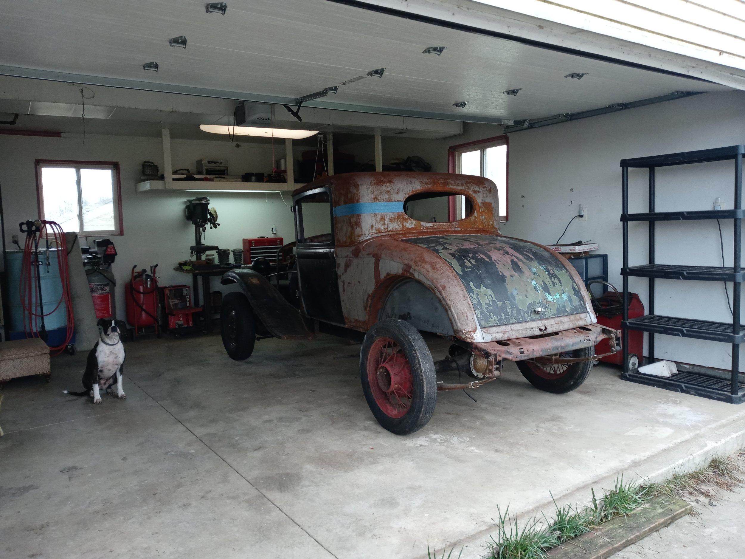

    Warm and dry in the garage.

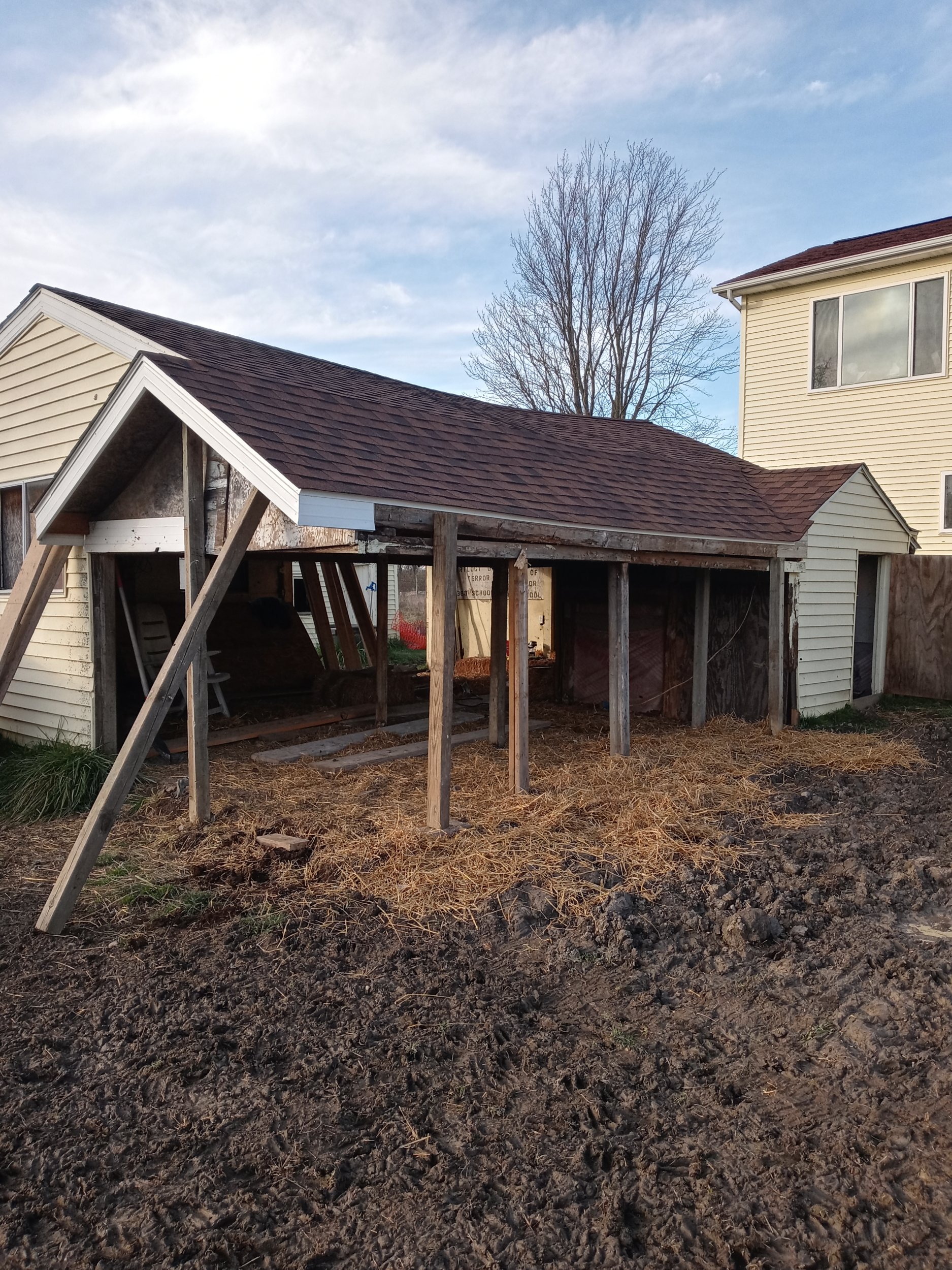

    No small feat. After the fire, we had to move everything to the other end of the house. Naturally, the garage was the likely recipient of way too much of it. I needed the garage back. So I filled Judy's currently unused indoor swimming pool.
    Not with water.
  21. Rickybop
    Joined: May 23, 2008
    Posts: 10,758
    Rickybop
    Can't wait to get started.
    But I gotta finish work on the chicken coop before I can start work on the Plymouth coupe.
    Or Judy won't be happy.
    Move your ***, boy!
