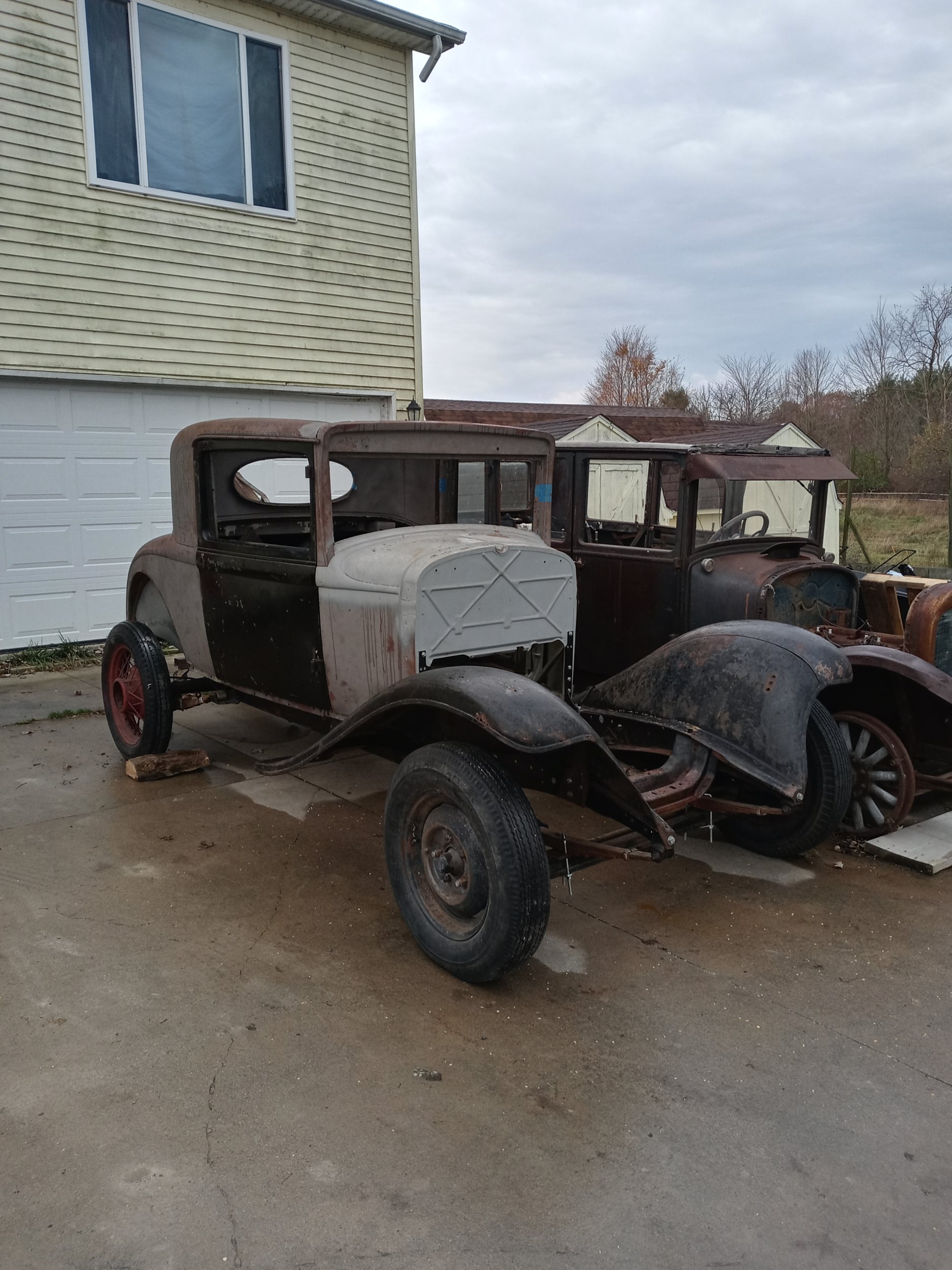

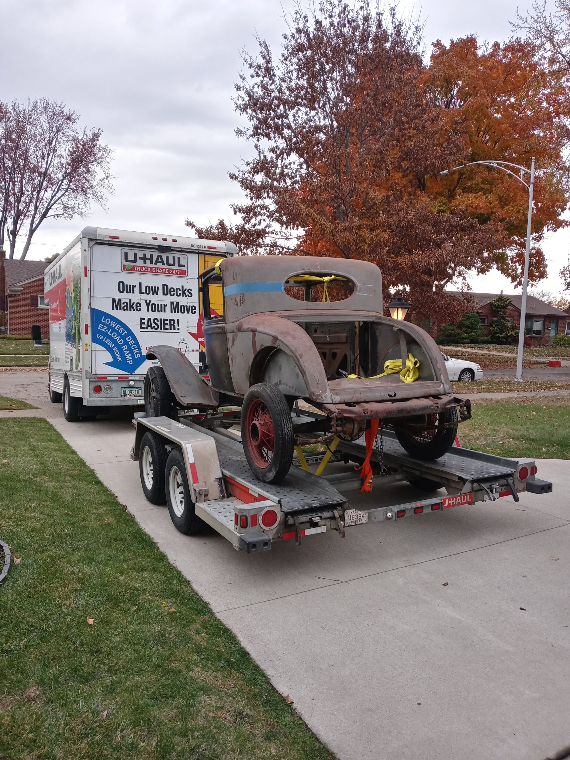

    Hauled 'er home today.
    Got going early.
    Got back late.
    Tired but happy.
    Hang on tight, old Plymouth.
    You're comin' home with me.
    Made it.

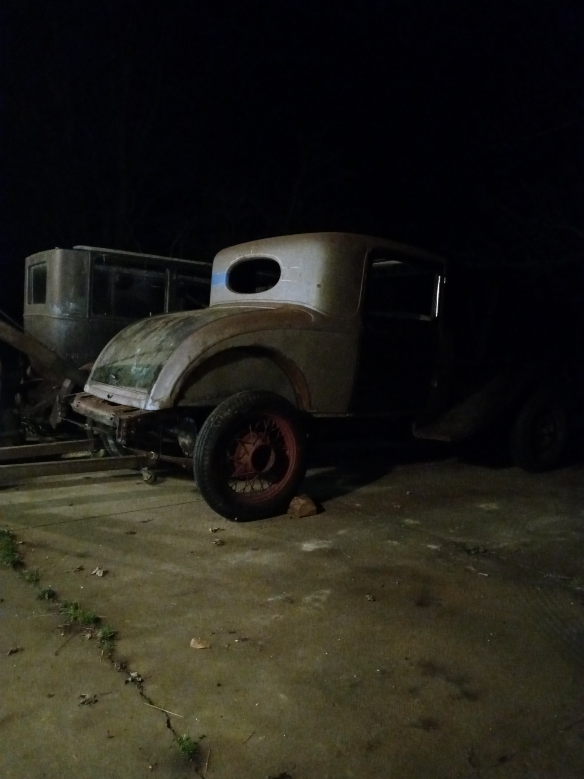

    Well now Brother Flea - looks like Christmas came early for thee - gonna be kinda hard to get that under yer tree - congratulations to ya - did ya curl up inside and sleep in it tonight? Sweet dreams ehh

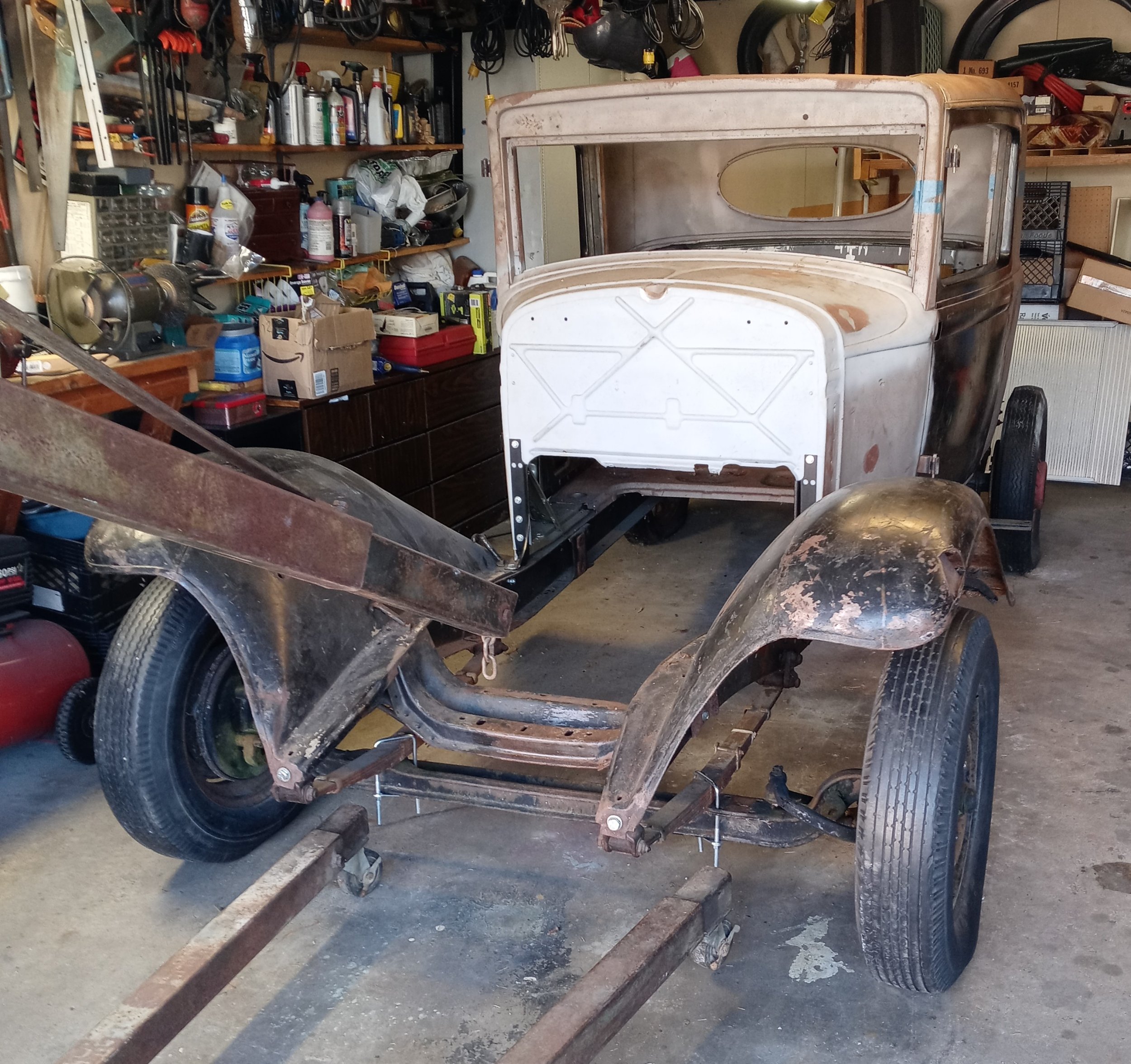

    I've considered using a Ford front axle and transverse leaf spring suspension. It would allow moving the axle forward. But I wanna keep the uniquely Mopar personality of this car. I think I'll keep the parallel leaf suspension front and rear. Ladder bars maybe for the rear. I like ladder bars.
    I think one of the first things I'll do is section the Ford truck axle that's on it now. Excellent axle for my purposes. The track width is too wide. But I figured out that if I get the perch pins to line up, the tires will end up right where they're supposed to be. Granted, still a Ford axle, but not as obvious as a transverse leaf setup.

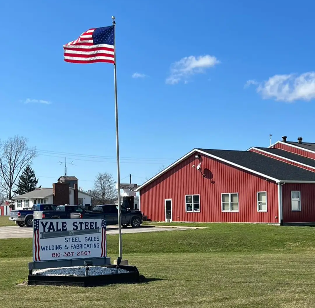

    Even though we live pretty far out in the country, there's a large fabricating shop just 1/4 mile down the road from us. They do a lot of very involved and very heavy duty weldments for the farming industry. So they've got the equipment and the know-how to section and weld my axle and make it straight and strong.

    @Budget36
    That's a 1964 Ford F100 axle. It's just half-assed u-bolted to the Plymouth springs so I could get it on and off the trailer. But I'm thinking about using it.

    If it fits, heck ya. I recall you mentioning using a trailer axle to get it on and off.
    I thought “doesn’t look like a trailer axle under there “. :)
    mad mikey, Sharpone and Rickybop like this.

    "If it fits" is a relative term.
    The track width of the F-100 axle is a few inches wider than the stock Plymouth. And the spring perch position is further outboard than the springs on the Plymouth by about the same amount. So if I narrow the axle to line up the perch pins, then the track width falls into place, too.
    But I kind of like the way the sidewalls of the tires are just about even with the outer edges of the front fenders. I think it gives it kind of a radical aggressive look. In that case, I could just build adapter plates. Or adapter blocks if I wanted to go up a bit.
    Edit:
    Scratch the idea of the "wide-track" look. I'm gonna go ahead and have the Fab shop narrow the Ford front axle.
