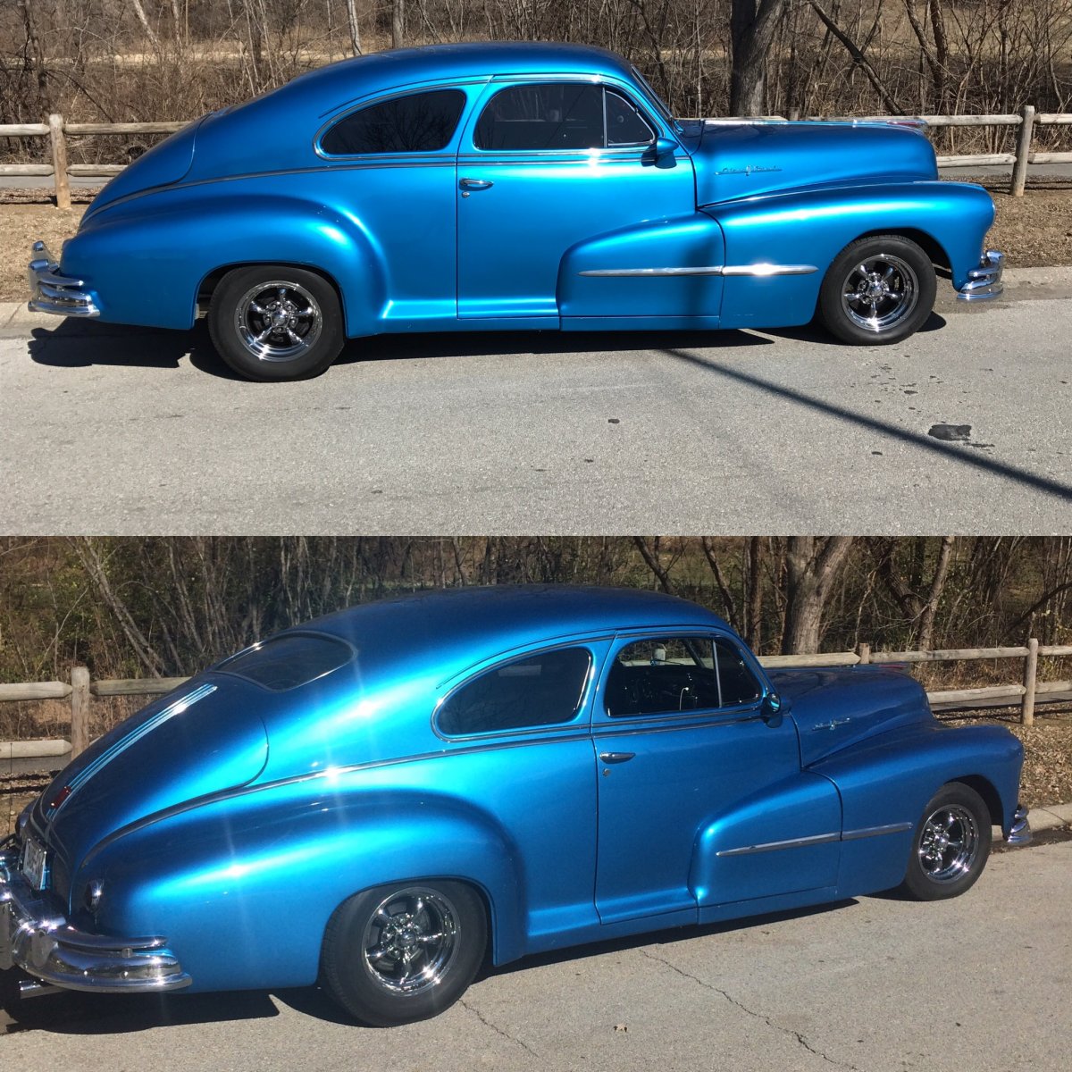

    I have a 1948 Pontiac Torpedo that has 2" lowering blocks in the back. The rear tires are 245 R60/15 on American Racing Torque Thrust rims. As you can see from the pictures it sit low and there is only an 1" or so of clearance between the sidewall and the lip of the rear fender. I am rubbing when I go around corners and the body rolls at all. I am thinking of changing out to air shocks. Anyone else running air shocks on their rides? Do you think this would solve my issue?

    It might solve the rubbing but you'll effect the ride quality. Air shocks are better suited for heavy loading / towing. More appropriate tire size and wheel offset is a better fix........but more expensive. Baseball bat to the fender lip might just work now that I take a better look at your pic. Not beat it but rolled against the tire.

    Jeremy< My '41 Pontiac with 2'' blocks in the rear rubbed the same way. I bent the sharp inside fender lip up flat along the top with giant channel lock pliers squeezing an inch at a time with carpet covered piece of wood against the outside of the fender. You might also decrease the amount of body roll by installing a heavier sway bar from a mid-fifties Pontiac.

    So I finally got around to fixing the rubbing issue on the Pontiac. It was pretty simple. I just removed the lowering blocks and put new rear shocks on it. The blocks had to go because they where causing rubbing issues on the driver side shock. I like how it sits now.

    Yea I was a bit frustrated, but now that I have lifted it back up. I am pretty happy with it. My dad is moving out here this summer and he is going to help me push the axle back a inch or so to get it centered better in the rear wheel well. That is more looks then function. I am also replacing the 245s in the back with 235s. So between all that I should be good to go.
