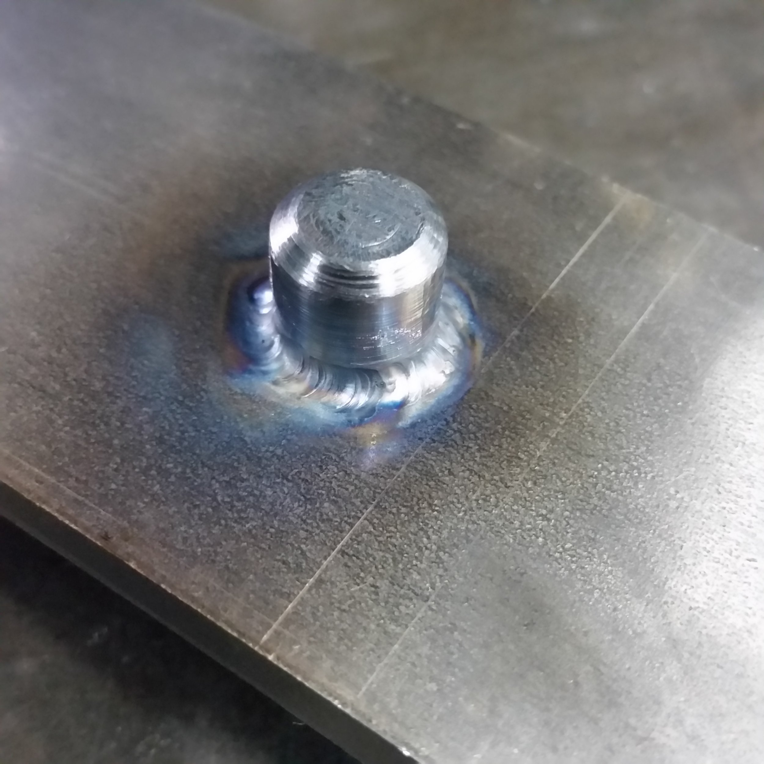

    I raised the rear of my 32 with a Mofel A rear spring approx 1/2". I made a couple of spacers which I curved on my press to match the crossmember, drilled the centre, welded a stub to fit into the crossmember with enough clearance underneath to take the top of the spring bolt. I used 2 pieces of flat bar and welded them together. Worked great. No problems. Could do the same on the front. My spacers were about 8" long.
    Chris

    Happydaze, I think you did what I was thinking. Didn't think to bend on the press. That looks to be the simplest way to go. Thanks guys !!
