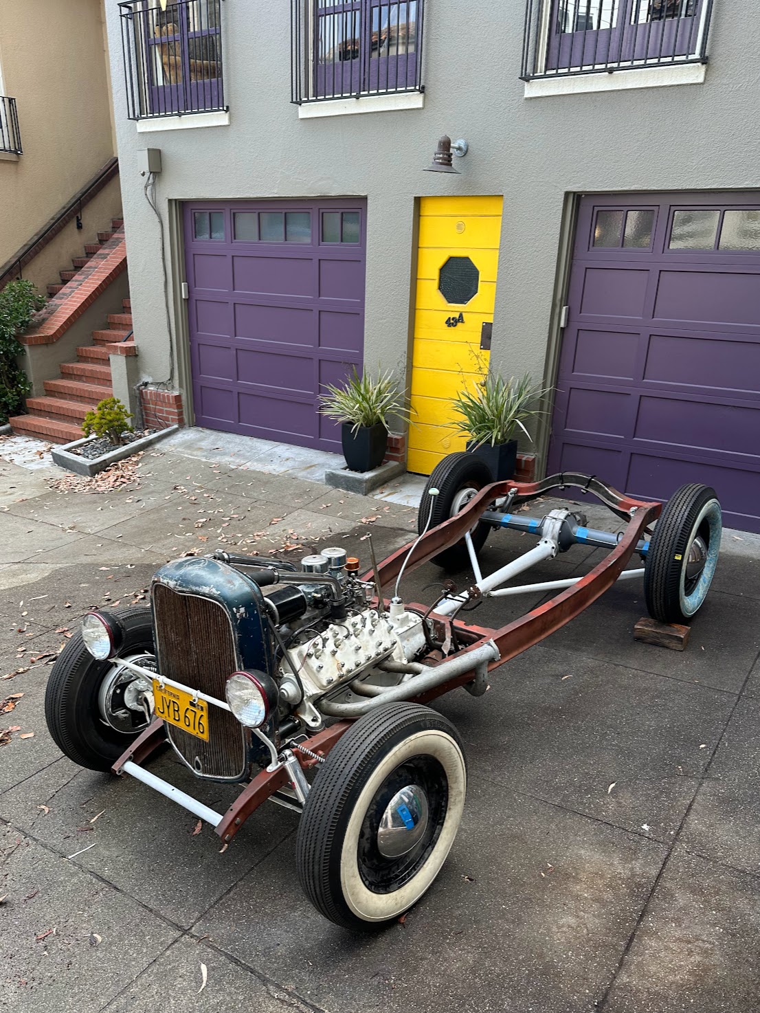

  20. Tim
    Joined: Mar 2, 2001
    Posts: 20,716
    Tim
    from KCMO
    Think they look pretty at home on @J.Ukrop new ch***i. These are built specifically for hot rods IMG_4945.jpeg IMG_4947.jpeg
