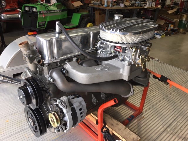

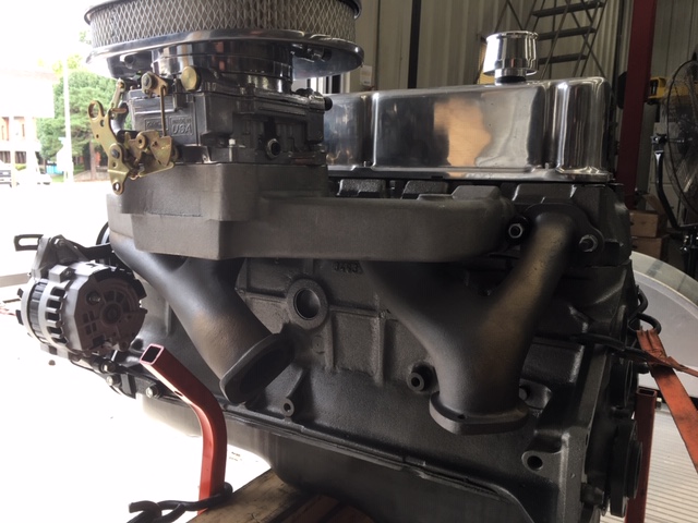

    @Clements36 ....as it happens, I am installing a 250 six in my left hand drive ‘37 Chevy coupe and have a couple of issues similar to yours, even though you are dealing with right hand drive. The common ground is limited space at the front of the engine for accessory drives.
    I would like to share some of my thoughts on solutions that may be worth your consideration. Some other readers may object on ‘traditional’ grounds, but I hope they will restrain themselves a bit considering the less visible nature of these equipment choices.
    As for the alternator location, I am considering right side as a location since wiring is easily routed regardless of left/right hand steering gear. As for A/C compressor, Vintage Air offers a mounting kit for the GM 194/292 six cylinder engines that places the compressor top right front.
    Initially, I thought that was my choice as it simplifies the A/C hose routing with left hand steering. However, the distributor I currently have seems to interfere with that placement. That has prompted considering left side A/C compressor mount in place of the OEM alternator. That would seem beneficial for hose routing in your case of right hand drive, would it not?
    As for power steering, which at this time I am inclined to utilize, I am strongly leaning to the electric ***ist units which are widely used on late models and relatively easy to incorporate in almost any car. That eliminates finding space for a pump and related hoses.
    I recent saw an adverti*****t for a bracket kit that, as I recall, top mounted the alternator and A/C, straddling the upper water outlet that may be worth your time to research. If I find or can recall where I saw that, I will post the info and send you a PM as well.
    For exhaust I am using cast iron manifolds that are two piece, front three/back three. They were originally offered by Tom Langdon but now are distributed by Tom Lowe (12Bolt.com). I will attach a photo of my engine to this post that shows them.
    To summarize, if I can see a good path for A/C hose routing from compressor to condenser , I am inclined towards lower left side compressor and right side alternator.
