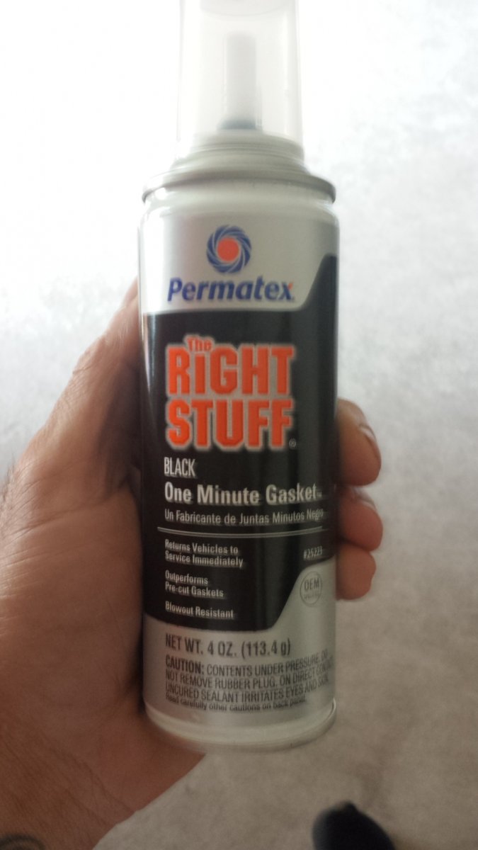

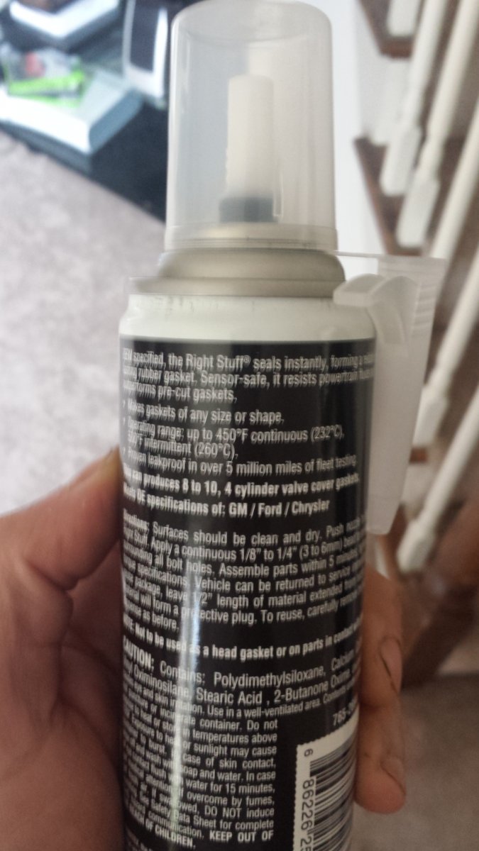

    Here you go. This is for those who haven't seen the (right) 20151008_112154.jpg 20151008_112213.jpg stuff yet

    I couldn't enlarge the instruction label so I'll ask..Should the right stuff be applied to one surface and let sit few min or ***emble right away? Referring to engine fore and aft china walls specifically but all uses in general..

    I found that once it's on you have about 1 min. before it starts to tack up. Inevitably, every time I use it and I'm spreading the bead out, I pull some off the surface because it's already started curing. It's actually the only downside to this stuff. You'd better get your cover right on the first time cause if you try and adjust it it pulls off. Once it's on, forget it...no more leaks. I literally just put some on my CJ7s timing cover in place of a gasket and started it right up with not a leak in sight
