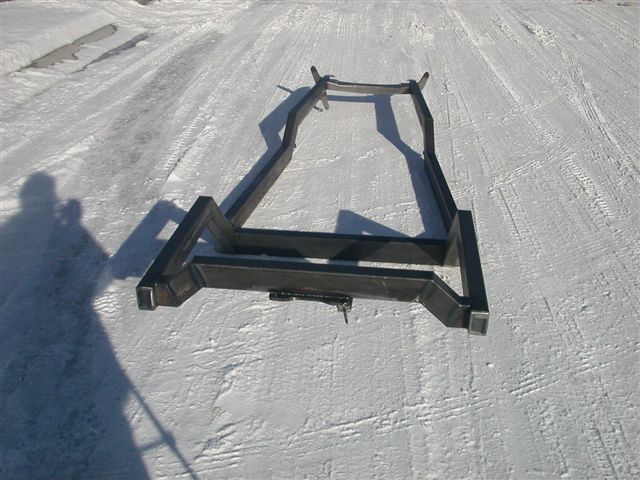

    The plan is to produce the frames.
    This was the first 32-34 truck one we did.
    It is made to be channeled,
    6" rise in the front with a flat front crossmember.
    The rear kick is 12" ??
    I need to get some little things done,then pull it apart so I can take some pictures
    of just the frame.
    PM me and we can discuss it further.
    Here's a picture of a 35-36 frame we did..

    I'm not into the "super channeled / broken frame look".....but I think it's way cool you are getting someone so young interested in Hot Rods and away from the television... keep up the good work.

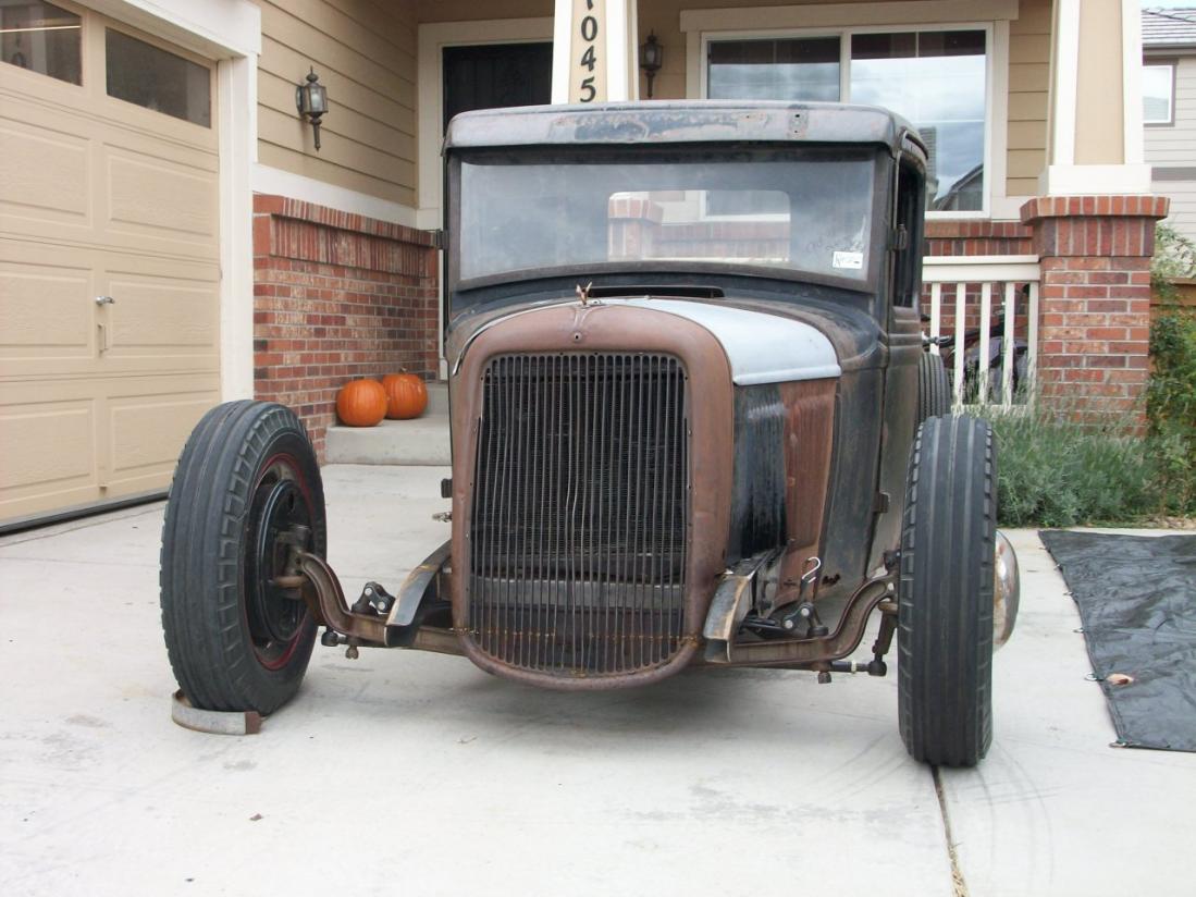

    I'm not either,it hopefully will have a touch more class.
    The cab was channeled when we got it.
    Kinda like building a tree fort,you know using what you have laying around.
    Thanks to Investinrust,it now has a grill shell.
    Going for the new trend of double layer hood sides..
    need more visegrips !
    It's going to be super plain,no wishbones,steering,exhaust,air cleaners showing at all
    little pic from today in the driveway.

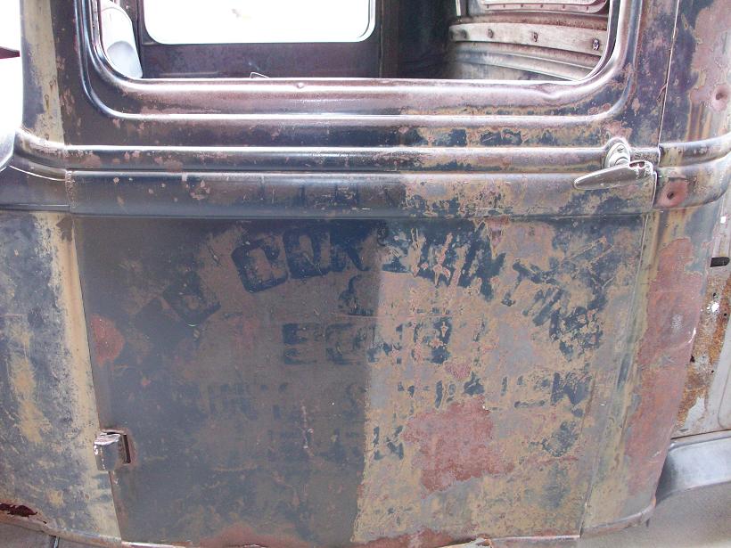

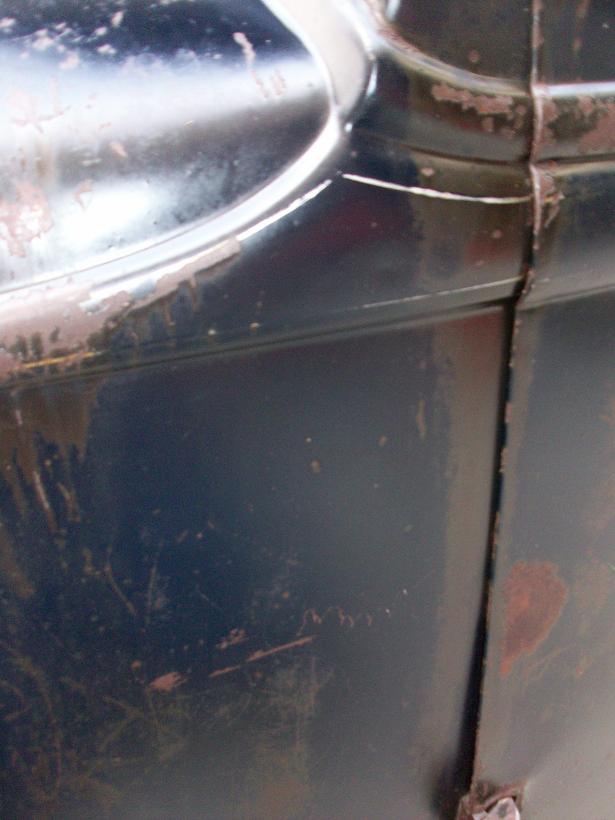

    Bought some Gibbs oil from ol' Side-Valve (the hot rod company)
    Thanks again bud.
    Never used it before,and Iam impressed.Wakes up and cleans up the old dead paint and rust.
    It's not a shadow,I wiped down half the door.
    Close up of cowl...
    More real updates soon..

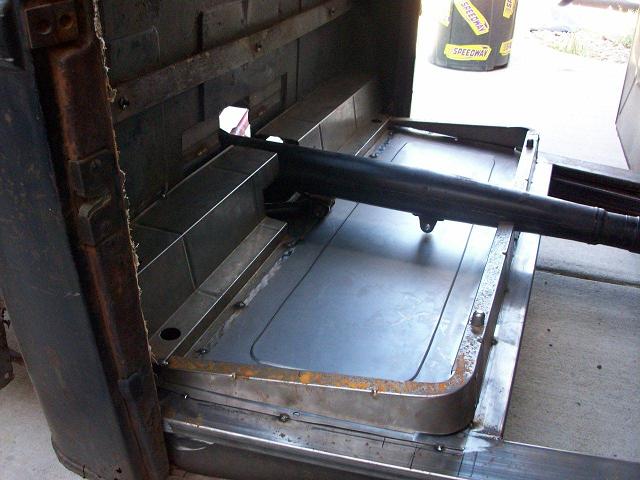

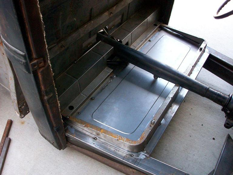

    Well,had a free afternoon.
    When we got the cab it had already been channeled.
    It was very Lucy Goosey.
    Needed to square it up and make solid .
    So we welding in some 1"x3" tubing.Cuz that's what I had.
    (tree fort mentality)
    Put in part of the floor.Just the pan that goes under the seat.
    And I had ordered in 32 roadster seat riser pieces.
    Cut them up to work,and widened them a few inches.
    (I tried a original roadster seat bottom..bit narrow)
    Just tacked everything,knowing I will be removing...just really a moc up.
    Anyways...going to build a seat next. (I hate wood,measure 3 times.Cut once.Still too short and crooked )
    Having fun with old cars,and hanging out with my favorite guy.
    Doesn't get any better then that !

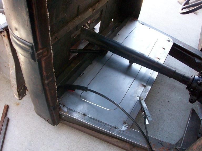

    Took some pictures today.
    Since last update,installed clutch/brake pedal,throttle,heater,motor trans.
    Bought the wood for the bed..
    Here's some pic's
