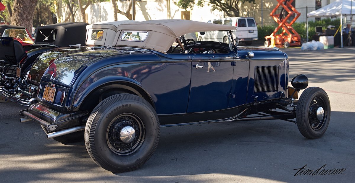

    750-16 and 525-16. There are probably a couple thousand pics of cars here running that size on that wheel. DSCN0052.jpg

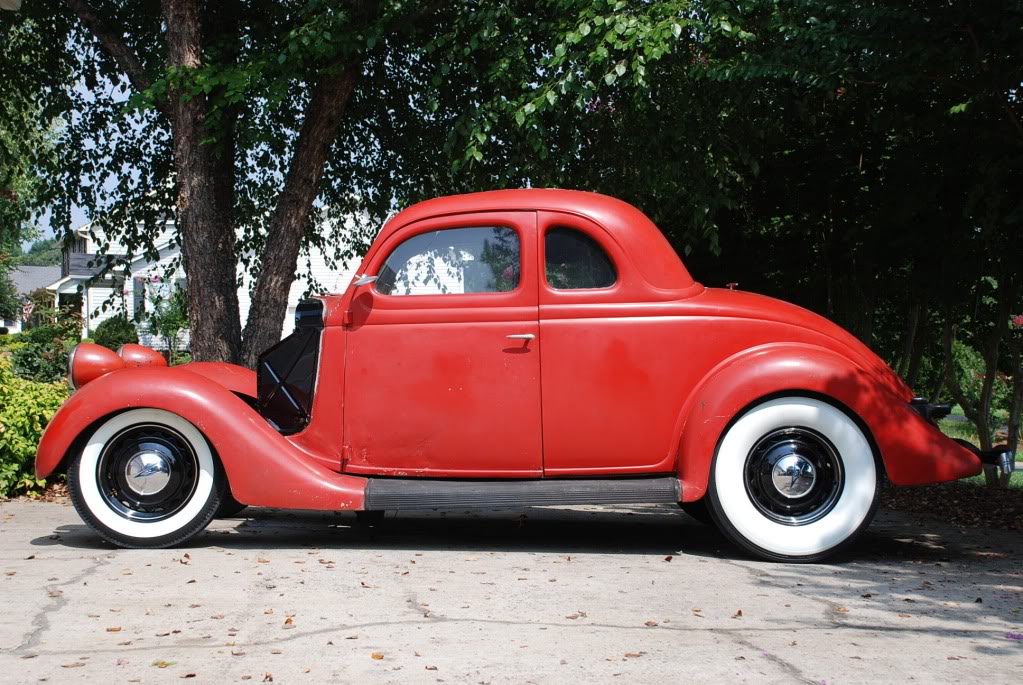

    750 and 550 3 1/2 wide front and 4 inch rear, wide 5's but still the same width as the wires. DSC_0643.jpg

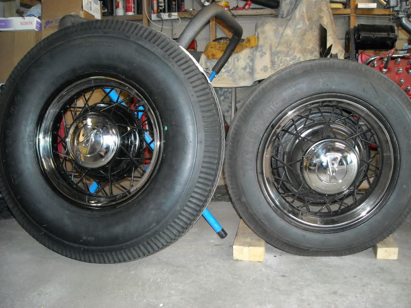

    Been running 7.60 and 5.25s on my Kelsey bent spokes for many years, no problem. LARS 2015.jpg
