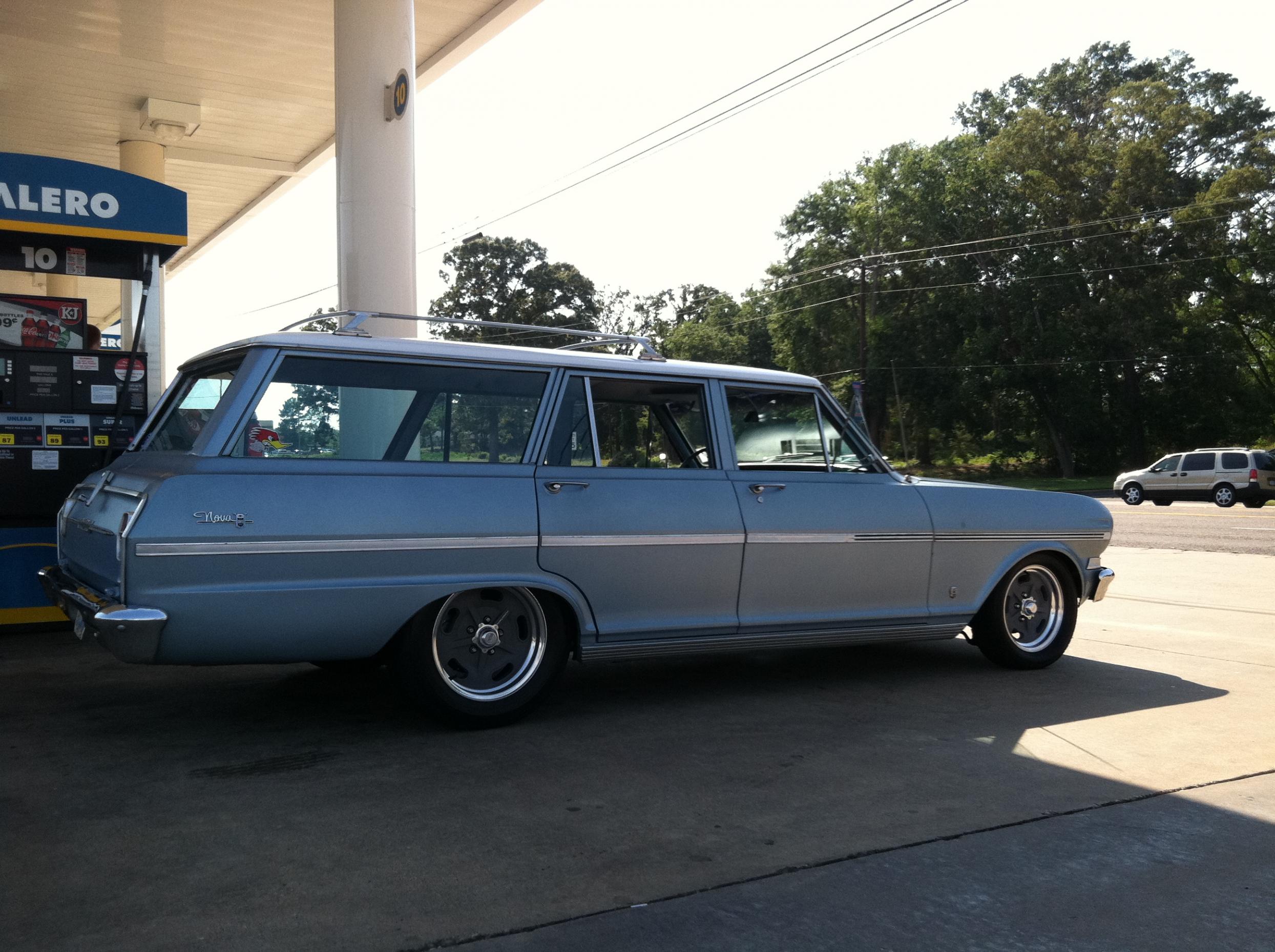

    It sounded like two people talking in that paragraph. 15x7 with 4.5 backspacing. you can go from 7s down to 3.5s on the front. I have 16x7 with 4inch backspacing with alittle narrowing on the 9 inch and 15x4.5 on the front. Gonna put 155/80s on them.
