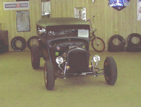

    Sorry, I just found your post, here is a pic that I just e-mailed to you. This will give everyone a better idea of the look. This is the same tire size, and rim width. I think it looks alright, but that is just me. -Joe
  8. jdubbya
    Joined: Jul 12, 2003
    Posts: 2,435
    jdubbya
    here is another pic, sorry for the poor quality, I had to lighten it.
