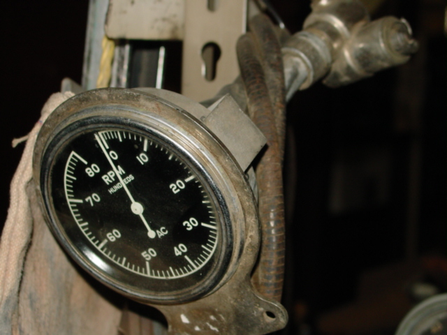

    Well you could always use one of these ...... they were made by S/W to run governors on stationary engines
    Some of you know I have a lot of old junk around

    But the generator that Bluto posted is a great set up. I bought a couple and they would work great. the gear ratio at the tach output, if I remember right, is set up so that all you have to do is put on a pulley that is half the size of the crank pulley.

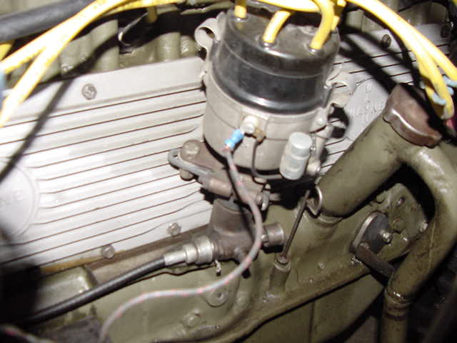

    "Where can I find one for my sprint car? $50 ?????"
    You can find it at any swap meet.......... 30 years ago.
    Big cars (sprint cars) almost never used a tach.
    The correct condenser for all this go fast Fords is PETRONICS! Then you can toss all this other stuff away. I been running a Petronics setup un my 39 GMC since 1990 only failed once.

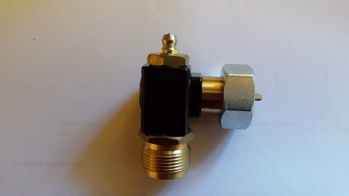

    Has anyone put a road draft tube on a banger like this one? My banger tends to breathe oil out of the filler cap when I sit on the highway and I'm wondering if a drain like this may help redirect it down instead of all over the starter.
    Also anyone who has had trouble with a standard exhaust clamp you may like my solution, A triclover clamp for stainless food pipe work.

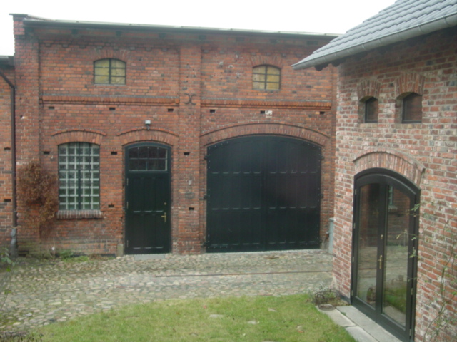

    This is a photo of 1/2 our workshop ....... on there right is our house ..... arched gl*** windows are the entrance to our winter garden. These allow us to roll a car in and out of the house to work on it too. People walk in and are surprised to see a car or the Ardun sitting inside. They never dream we built the house with that in mind. We tore down a friends old house to get the brick so the house and workshop sort match

    ^^^^^^WOW! Very nice! Like the architecture, especially the arched windows and doors.

    You're house look like a face with it's mouth open wide.

    Wardog..... your only looking at a bit of the house.
    Here's the view from the shop.

    I knew it would only be because of the way that one photo was taken, it's a beautiful house.

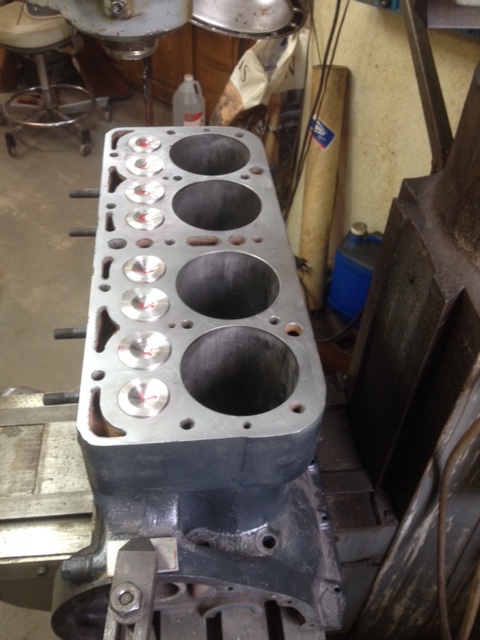

  27. Current project, diamond A, have replaced valves and exhaust seats stock size exhausts intakes 1.700 intake pocket under seat 1.562. Have a set of Egge's solid skirt pistons that I bought for a different engine about 95 0r 96 that I will prolly set up with 3 or 3.5 clearance. Have a J Brierley Winfield SU1R that I bought about the same time. Gonna run the babbit as it doesn't look too bad .013 under rodsandmains. Have a choice , up or down Winfield BB to go with Winfield Yellow head. IMG_0493.JPG Will put in RPU that wife will use to get the mail gotta go 3/4 mile

    What will you use for a crankshaft?
  29. I will use.a stock model A that came with the engine or rather was in the engine. The only modification will be pressure to center main. I doubt this engine will go 200 miles.a year so don't see the need to add counter balance weights though I do have set laying here. I'm 79 now so I will leave this for someone else to fix. Been there and done that and didn't even get the T shirt do have one from Antique Nats that says winner on it though !!
