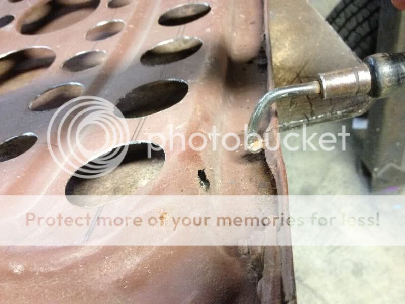

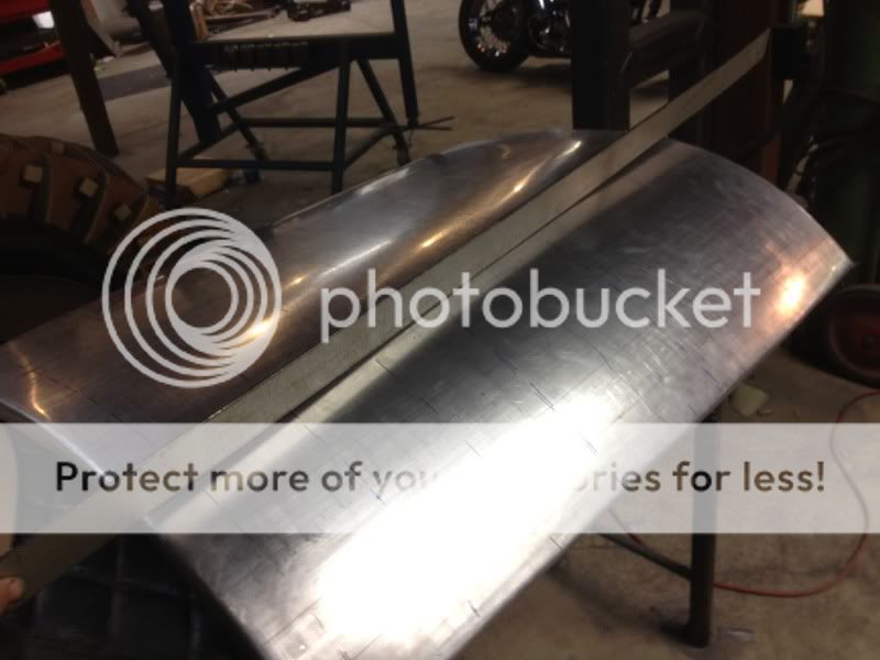

    Welding the headers together took longer than I thought it would and Tim took them home to belt sand the flanges for me. So I decided to start working on the deck lid. Originally I was just going to peal the skin off, louver it, and put it back on, but I found some rot. So I decided to make an aluminum skin For it. First thing I did was stop peeling the skin off with my special screwdriver skin pealing tool, and just cut it off. Then I rolled out the basic shape onto a piece of .063 3003 aluminum. I roll a little crown into it but not too much. from there I break the left and right edges over . By this time I get the edge to 90 degrees, the panel is straightened back out so I make a template of the inner skin and start shrinking the edge to match. Since I have already rolled the shape in the skin, it is under tension and it comes back into shape fairly easily. After I get the edge to match the inner skin I go back and wheel some crown into the skin. Since I had the outer skin off I found some available real estate for 4 more holes!. Then it was on to the louver press for 6 rows of louvers. I still have some work to do to the inner skin, so for now its on to something else. <p>
