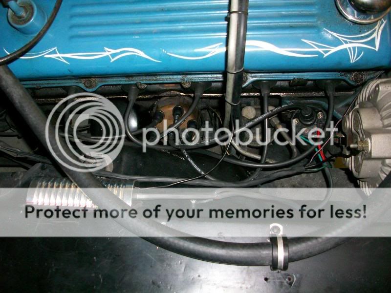

    Ok now at the swap meet no modules are to be found so lets buy up a trailer harness ($4) and a bag of connectors ($3) and a box of chevrolet distributors ( i needed some cores for my flathead builds) and the box had a hei gm core in it as well ( $15 for 6 reg and 1 hei).
    Ok we have the survival tools needed now.
    Afternoon after the swap meet we mounted the hei module and grounded it through the only hole in the fenderwell and force threaded the hei screw until it was tightened....
    Now lets wire the hei coil pos and negative leads to the existing coil leaving the power lead on the coil. We know from spark testing that it does have key on and off power.......
    Now the McGyver part ( TV show) we need the small terming ends of the hei wired to the pickup coil and i know that the pickup and module need corrrect polaruty to start.
    But ya know i like the McGyver thinking its a 50/50 world . Works for me , it either WILL or it WONT !!!
    Wire the chrysler pickup lead from distributor to the small terminal end and twist ( temP0 the leads together and crank er over ''''
    IT will either :
    1- Start and run
    2-Or backfire and not run
    Ok lindross crank er , AND bang it backfires and wont run ( MyGiver would have blown the world up) , so twist them the other way and bang , it runs and runs great !!!!! Maybe even starts better than it ever has !!!!!!!
    Ok off to the Iron Pig and a cold one.......
    We will clean this up and show ya the finished cleanup of the system as time permits...

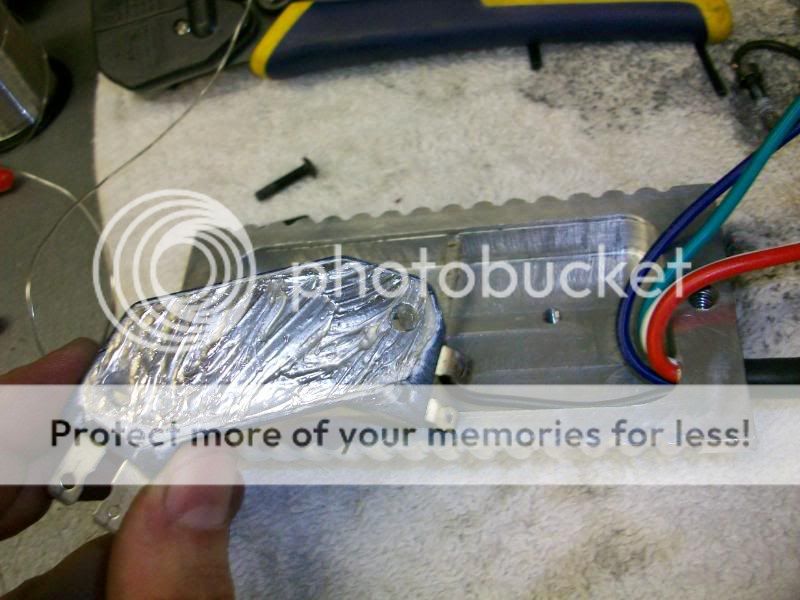

    OK, Lindross had a day off today and got er wrapped up.
    Here is our module cover just for the HEI control module.
    Old card with old phone number new number is 1-888-809-3835 toll free....
    Lindross removed the module on the fender well and put it in a new cover with dielectric grease for a heat sink.
    Bolted to the fenderwell , there are four wires ( 5 if ya count the ground lead.
    Two go to the ignition coil and two go to the distributor.
    We cant believe how easy this thing starts now.!!
    Another view......
    The cover unit is $30 if anyone needs one ( with out module) and the module typically cost less than $28 as well, pm for needs.
