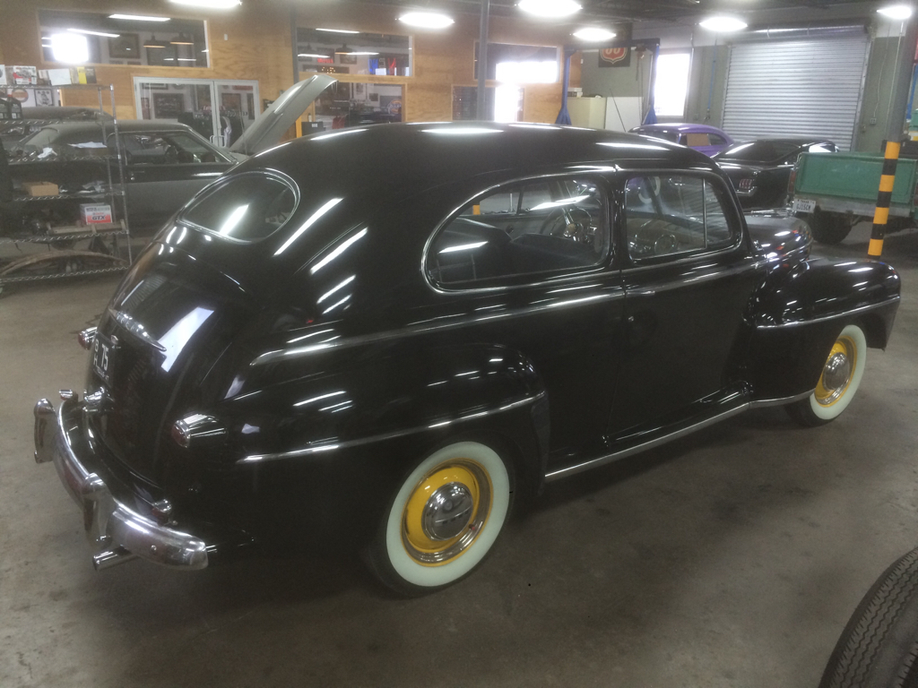

    The plan for this one is to swap out the 3-speed in favor of a T5, which means doing an open drive conversion on the banjo rear and changing from a transverse spring to parallel springs. All 4 brakes will be ditched in favor of Lincoln brakes. The front axle will get changed out for a 5" drop axle, split the wishbone, new leaf spring, and tube shocks in place of the lever shocks on all 4 corners.
    I will also be cleaning and detailing the stock flathead, getting the stock 16" wheels powdercoated black, and some small cosmetic stuff. We aren't going to touch the paint on the body, or change the interior aside from adding the floor shifter, I believe.

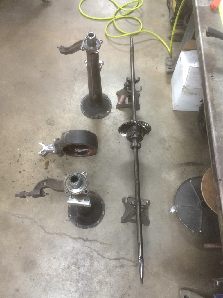

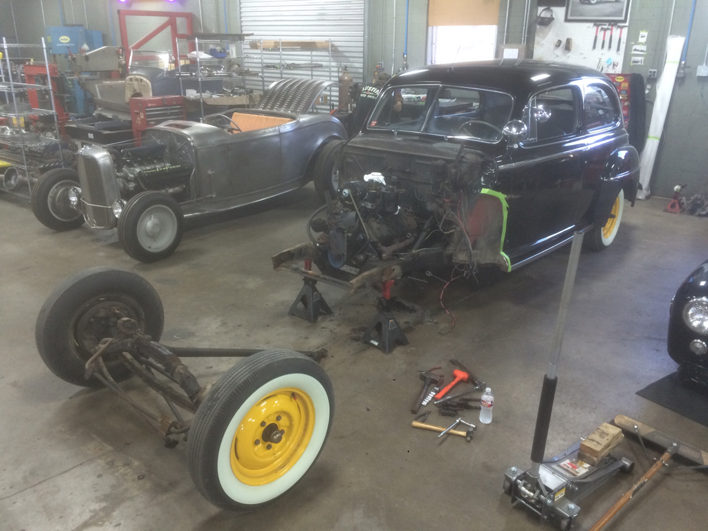

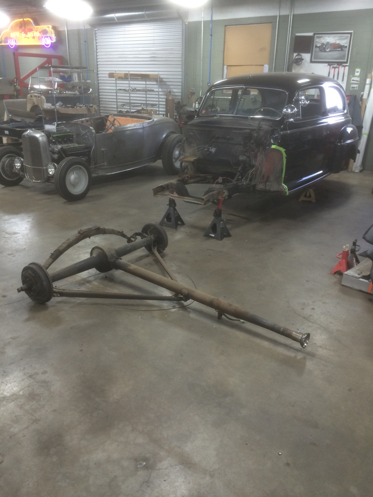

    I began by taking the hood off then the front clip off, front suspension, and drivetrain. To gain some room back in the shop, I went ahead and disassembled the entire front suspension and took the transmission off the flathead engine. The rear suspension will be coming out next along with the pedal assembly. Here are a few in-progress shots of disassembly..
    Did these cars come with a bug screen in front of the radiator from the factory?
    I'll also be replacing some of the uglier parts of the car like where the new exhaust was welded to the old exhaust..
    But that pretty much brings us up to today.

    Just got the rear end out. Now we can start cleaning up the frame and start playing with the new stuff!

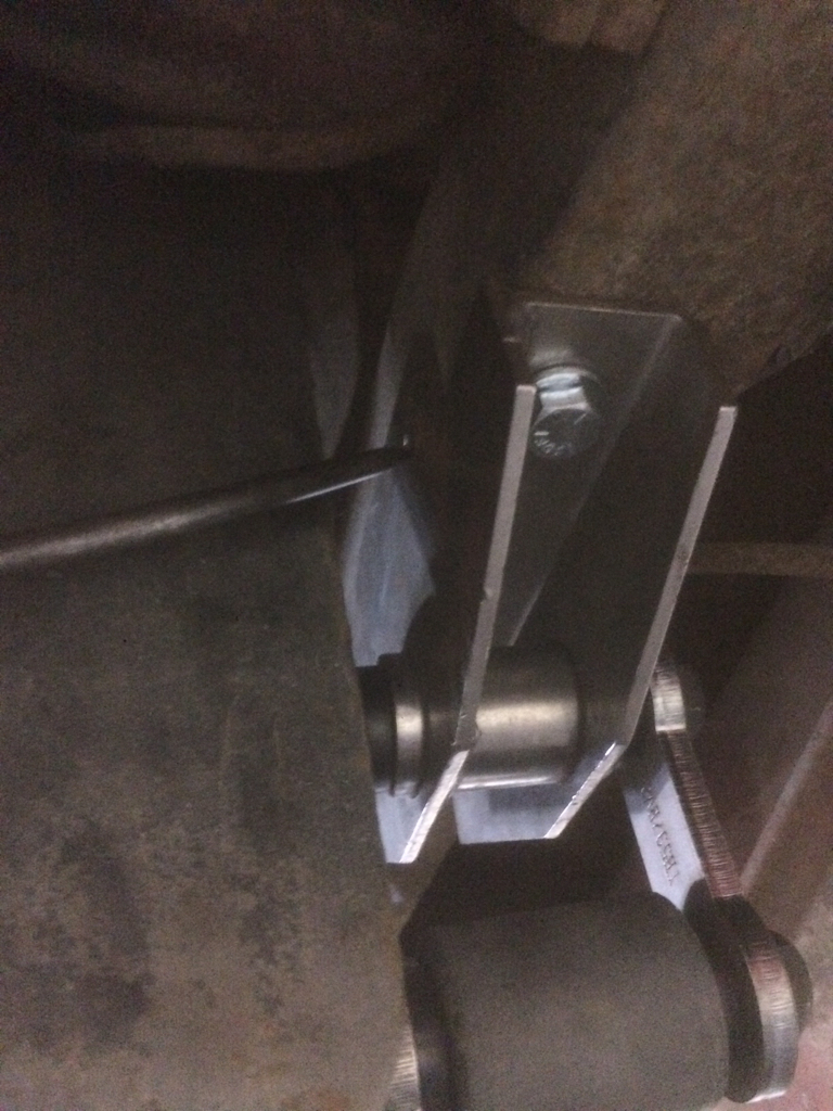

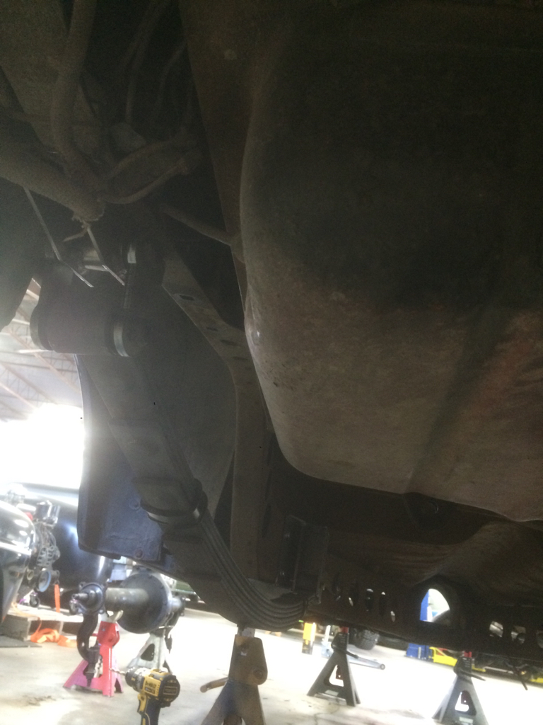

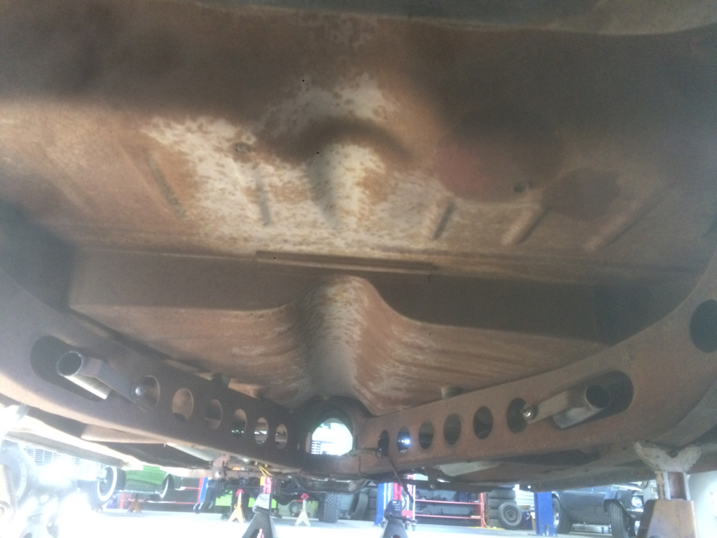

    It's been a while since I updated.. Been waiting on parts to get here. The rear parallel leaf spring kit from Posies arrived a while ago so I got to work getting the brackets in. With this kit, you're supposed to get a couple pages of instructions and templates. For some reason, I only got one page out of the two or three that come with it. Thankfully it had all the important measurements I needed to know, so I promptly got to work measuring up everything and getting it all bolted in.
    In this picture, on both sides, the chisel is pointing at a hole.. there wasn't enough room to get a drill in for this hole for the rear bracket. I'll come back to this later.
    We're trying to reuse as much of the old exhaust as possible, but it seems like the more parts arrive, the more of it we have to cut out. We'll reuse what we can and fill in what we need to.

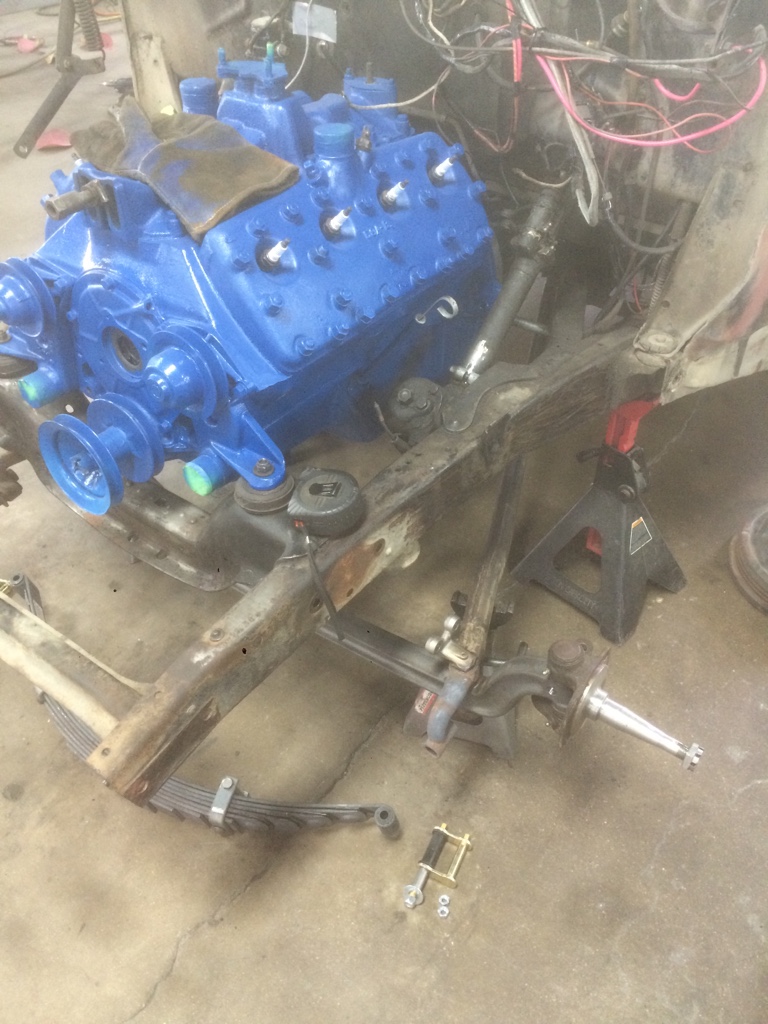

    Open drive conversion installed..

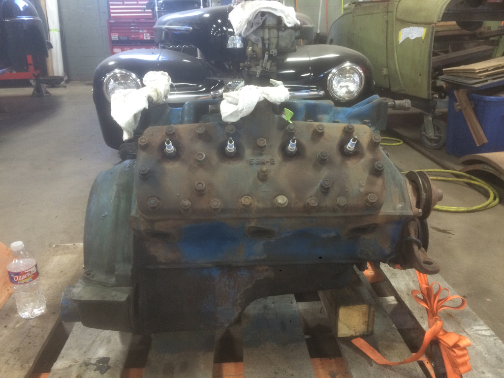

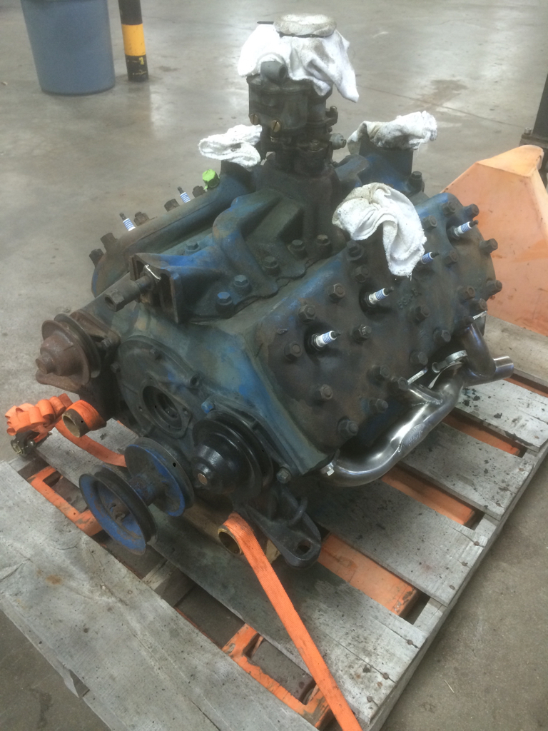

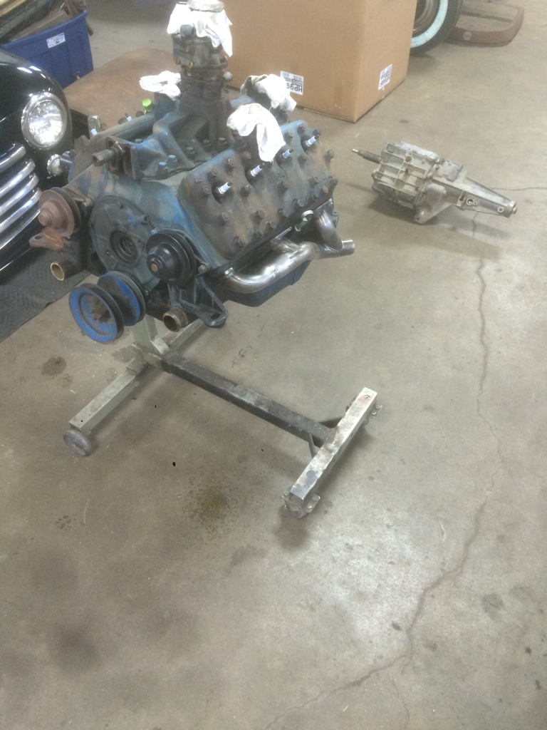

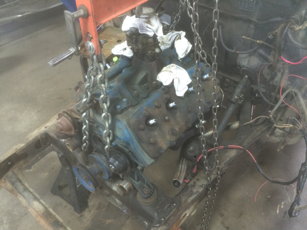

    Degreased the engine on the pallet as much as I could.. We ordered a flathead stand adapter from Flathead Jack which arrived later. That adapter is great but I had to drill in the 1/2" holes for sticking a screwdriver or bolt through the top to prevent the engine from rotating on the stand. It tends to want to lean backwards. For some reason, I don't have a picture of the adapter, so I'll throw one up later.

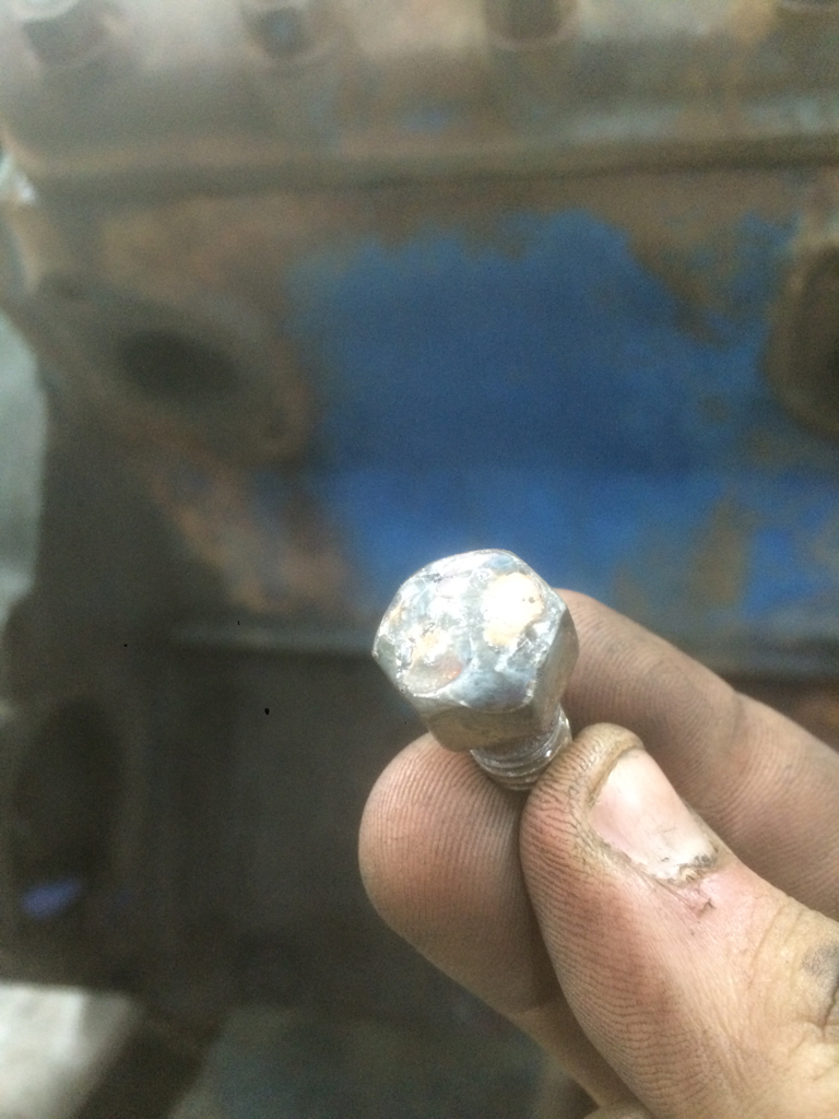

    Thankfully I've only had trouble with taking off just one exhaust bolt which sheared off. Everything else came off pretty easily on this 70-year old car. I just welded a nut on top, hit it with a hammer to break it loose, let it cool off then it came right off.

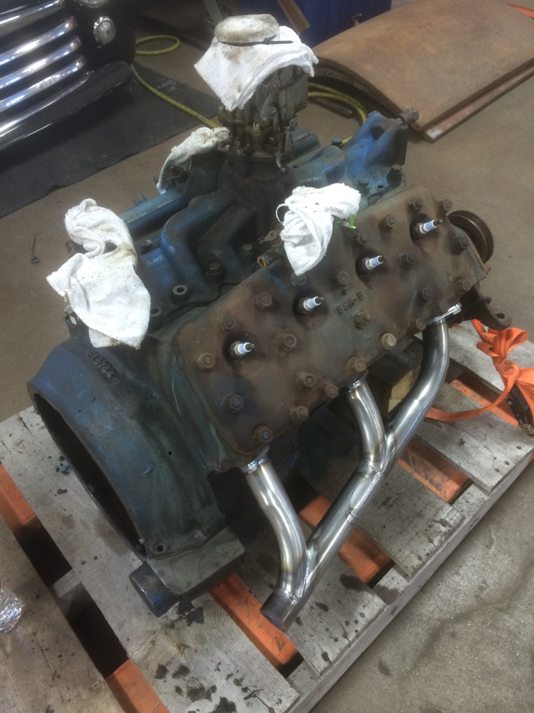

    Threw the Reds headers on there for shits and giggles.

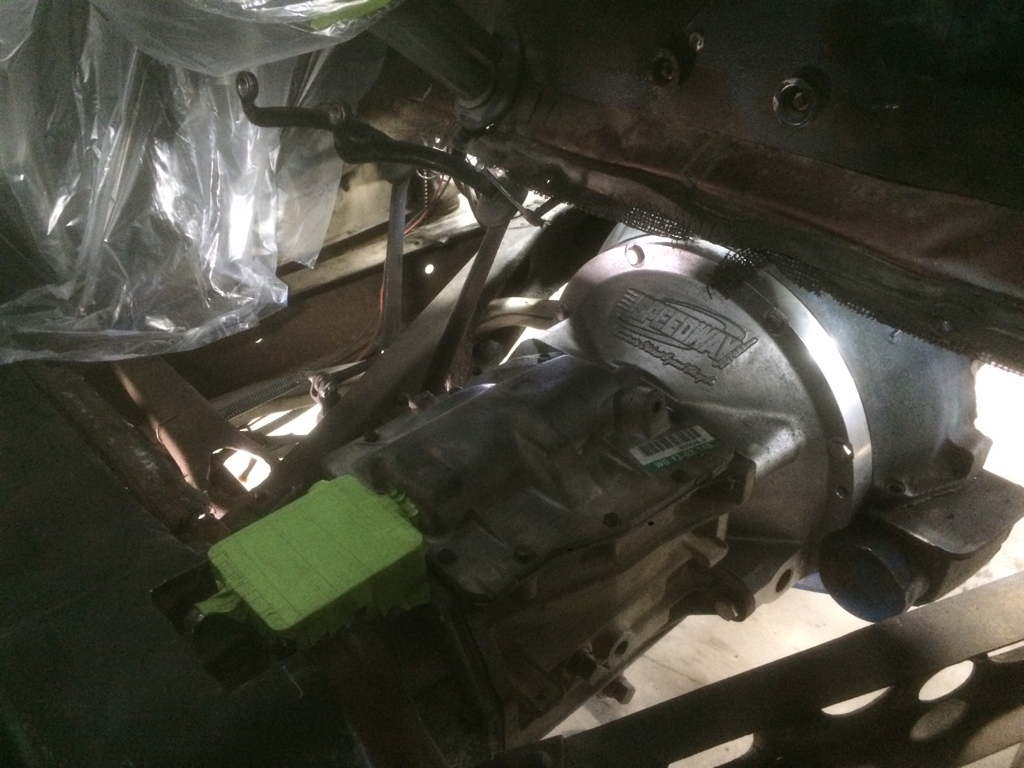

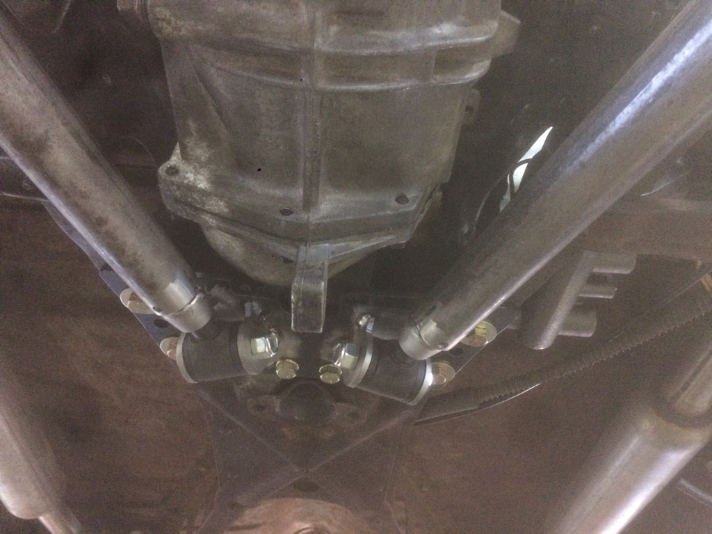

    I couldn't set the pinion angle on the banjo axle until I had the T5 transmission mounted. It was a few days before the T5 arrived, so I threw the adapter on the engine then the transmission.
    I should mention, the T5 transmission mounting holes needed to be drilled out to 1/2" to mount to the adapter.

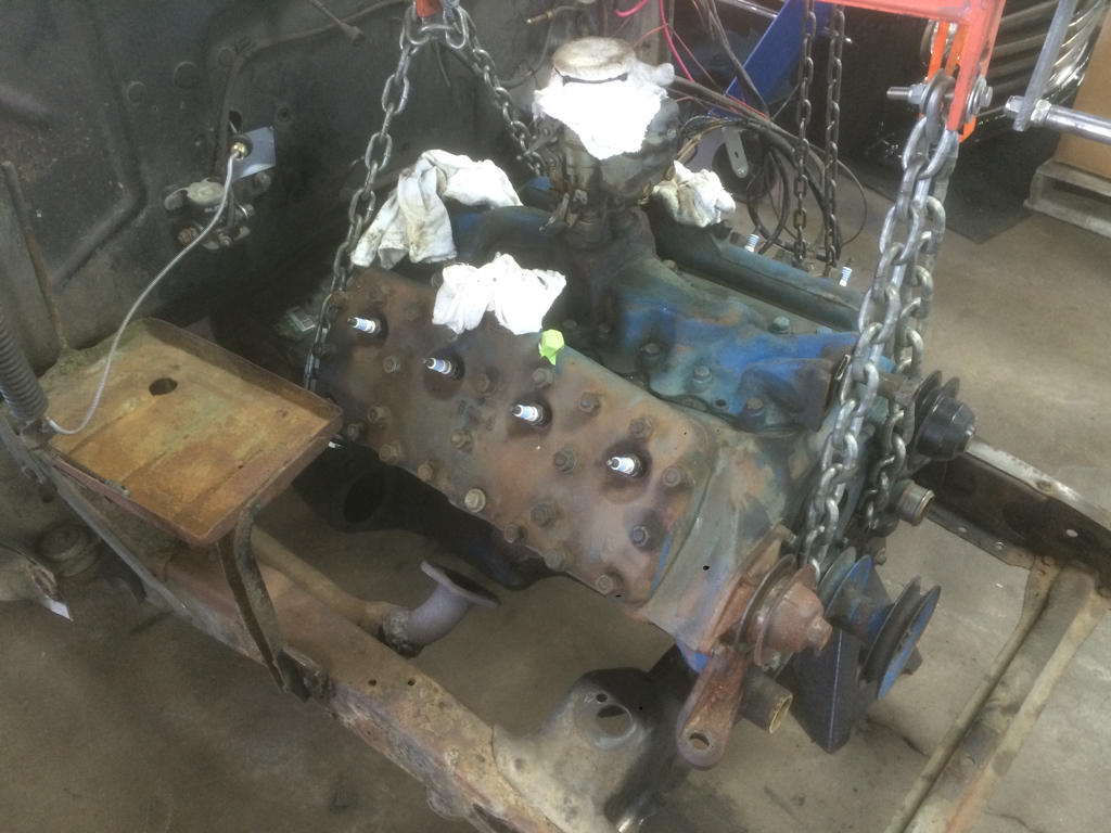

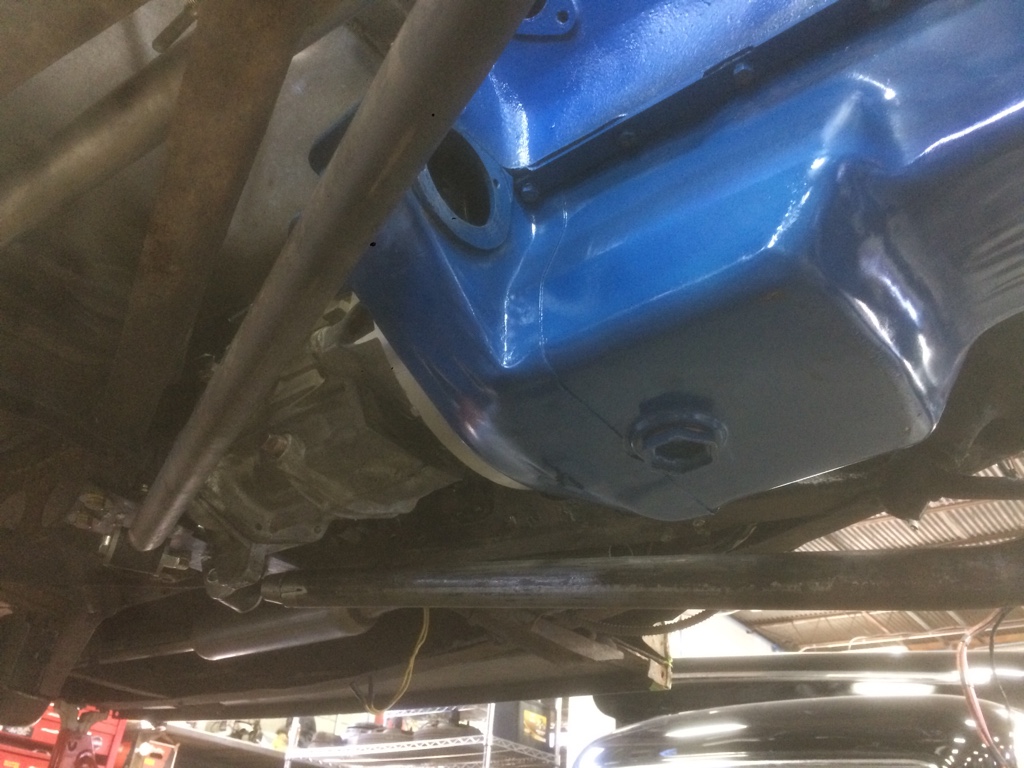

    Hoisted the drivetrain into the engine bay to see what needed to get cut out. The front half of the floor screws in, so I took that out. I had to cut into the brace and floor down by the seat to get the tailshaft back into the X-member.
    It was evident the center part of the X-member would have to get cut out for the tailshaft to have room back there as well as mount to a plate I would have to make. A transmission mounting plate was ordered from Chassis Engineering, but it wouldn't work with the T5 because it was designed for other automatic transmissions. So I took the pattern, made my own base out of 1/4" stock we had laying around, trimmed it down to fit around the transmission and mount up to the X-member. I also trimmed the bottom of the X-member so the plate could bolt up further back to compensate for the length of the T5.
    Luckily the mechanical speedometer hole lined up with one of the holes in the X-member. I will have to trim the center a little more but it worked out perfect.

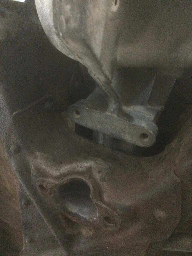

    Drilled out the holes for mounting the plate and mounted the rubber cushion for the transmission..
    In the above picture, the mount is backwards.. The circular part should be facing rearward. The bolts will all be swapped out with graded hardware later.

    At this point, I'm waiting for those parts to arrive. Until then, I threw the left header on to see if it fit. The clamp on the mast jacket was a little too close so I loosened it up, turned it away, and tightened it up.

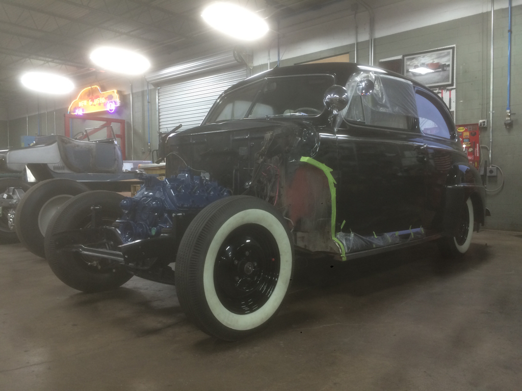

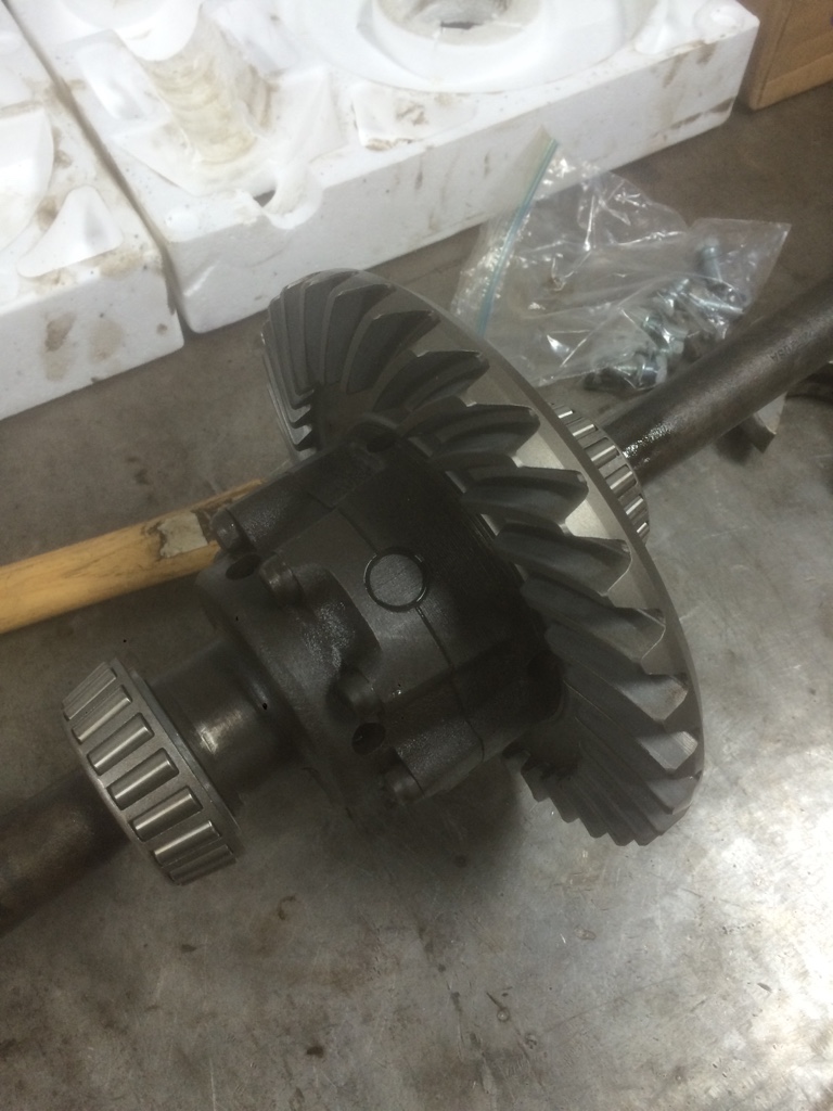

    Since the last update, the correct U-bolts came in for the rear axle, so I bolted that in, set the pinion angle, measured to make sure it was centered then tacked the brackets to the axle housings. I blew the rear end apart to clean out inside of the housings prior to TIG welding the brackets on.
    I impressed myself with welding them on. I was very self-conscious about laying them down unevenly.. I wanted to have Eric weld them on, but he encouraged me to weld them myself. Not too bad for having just learned how to TIG a few short months ago. :)

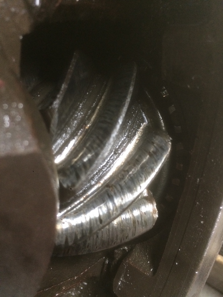

    Then assembling the banjo, Eric noticed the gear teeth were pretty worn down. She was a driver for sure. So we ordered a new ring and pinion set, staying with the 3.78s. I had never rebuilt a banjo axle before, so this was a neat learning experience for me.

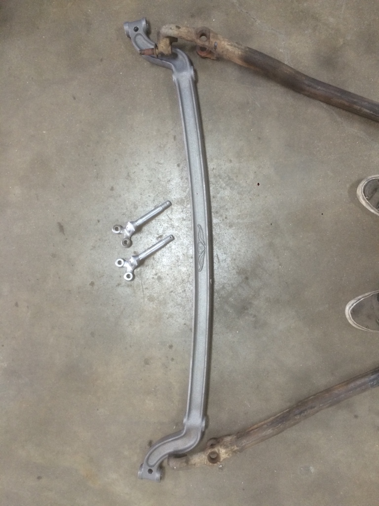

    So, as soon as the rear axle was done, I got to work right away. The new axle is narrower than the original. For a while, Eric and I were almost confident we could keep the unsplit wishbone until the axle got here. Then the spring confirmed that the bones would have to be split. The bone mounting plate we got wouldn't work with the T5, so I went ahead and made some tabs to mount the bones to the transmission mount plate, making it dual-purpose.

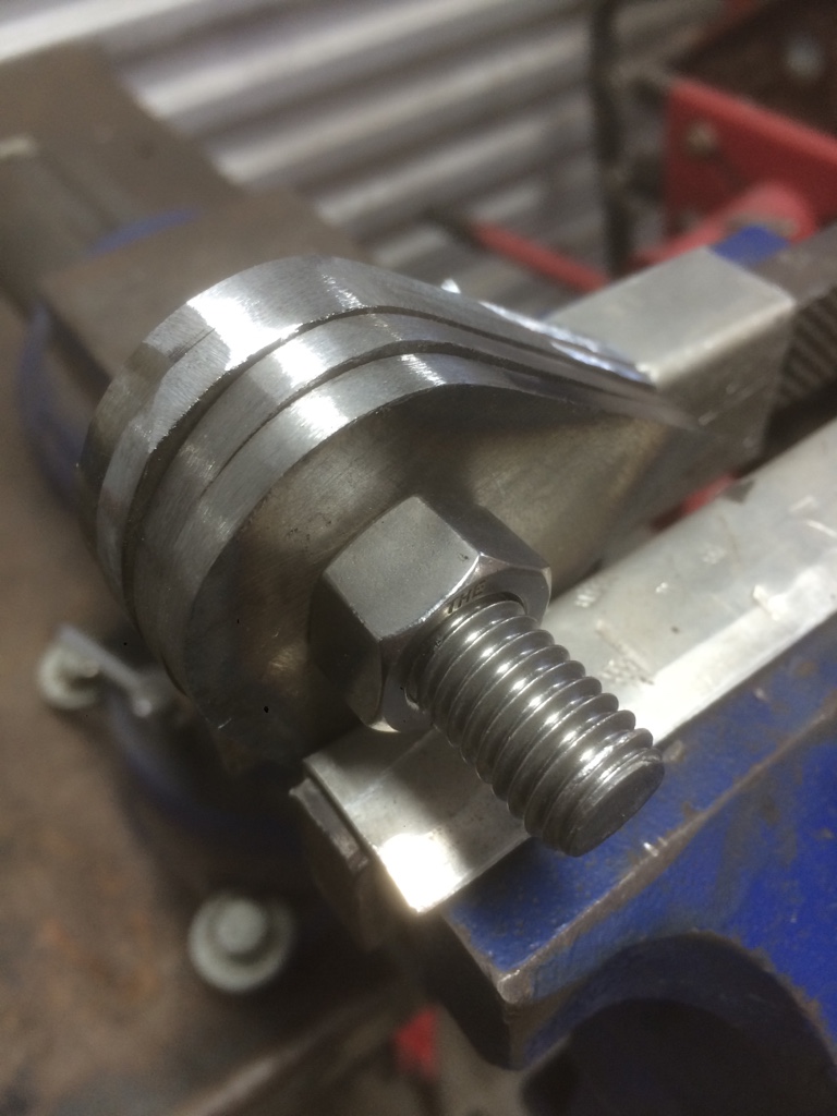

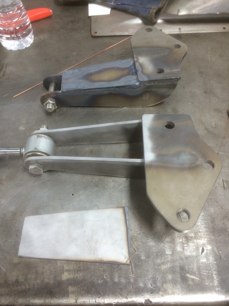

    One of my favorite parts of a build thread is where the original poster shares a tip or a trick they use to improve the quality of their build. I have a couple that I haven't seen anyone share recently, so this is for all the new guys out there.. When splitting the bones, clamp them together so when you grind the ends, it stays the same length.
    When I made the tabs, I started with some 1/4" steel, traced the shapes on them, then drilled out the holes before cutting the tabs. That was a helpful tip from Eric. Then I cut out rough shapes of the tabs, bolted them together then ground them evenly.
    Once that was done, with the help of Eric, I heated and bent the spring perches outward to make them parallel. Mounted the spring, bolted the axle in, and got to work on dropping the spindle arms.. I also had to cut off the front panhard bar mount for the reverse eye spring to fit up to the bone.

  27. Tim
    Joined: Mar 2, 2001
    Posts: 19,560
    Tim
    from KCMO
    Those are some good tricks, thanks! My split wishbone and grand mounts are all on one plate also, though I didn't have to change anything with the pan hard bar to get the reverse spring on.
    But every car is different once you get into it, even if they are supposed to be the same lol
